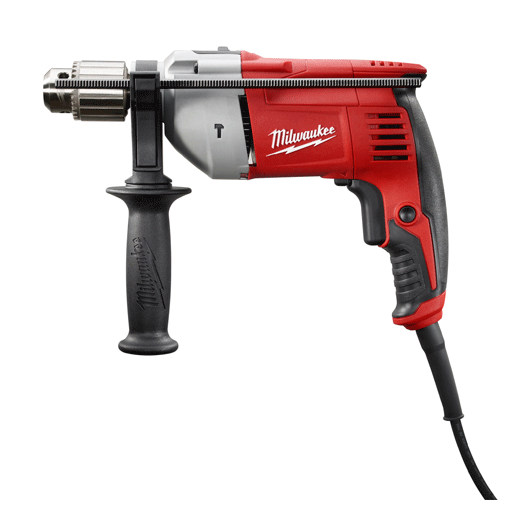

I bought a hammer drill on marketplace to assist with some masonry drilling. I'm not sure about the difference in chucks though.
The hammer drill bits i saw at HD have a smooth shank with a slot on each side, but the drill I bought has what looks like a normal chuck. Will it accept this?
Please educate me.
/ Hammer drill #2
SDS denotes a 'Spline Drive Shank' and your drill has a normal 'Jacobs style chuck' You can probably buy a spline drive chuck but a spline drive shank won't fit a normal chuck far as I know. My Bosch has a SDS chuck on it.
SDS bits are made that way for positive rotation during the hammering procedure. The splines engage the chuck for positive rotation.
/ Hammer drill #3
It will work if your drill chuck opens enough just keep checking it to make sure it stays tight.

@fatjay don't get me wrong, I love Milwaukee tools, but I'm not sure that this is the best tool for the job.
If you want to drill more than a hole or three, I would strongly urge you to get a drill that is either SDS-Plus or SDS-MAX.
I have a couple of drills like your Milwaukee, and I agree @Slowpoke Slim and @bigtiller that there is really no comparison. I feel like my little "hammer" drill is a three year old kid going "Vroom! Vroom!", rather than getting the job done. Using the SDS drills feels like drilling wood with a regular drill; the pile of sand/dust just flies up out of the hole. As an added bonus, I find that the SDS drills don't wear out the carbide tips anywhere near as fast as the non-SDS drills.
The bigger drills have an actual hammer that is plunging in and out. The Milwaukee 5376-20 just has a ridged plate that a second plate rotates on. (4h and 11a in the service manual below) Yes it is a "hammer" motion, but the force is lacking...

I would never run any hammer drill, toy or not without the side handle. All you do is take a big chance on breaking your wrist should the bit grab in the hole. I actually had my Bosch pick me up off the ground one time and spin me around. Only thing that saved me was it unplugged itself.

That is the difference. I do only cinderblock, hammer drill for me is fine, did a few hundred, no issues.
Solid cement, stone block, SDS would be worth the extra, even for a few holes.
