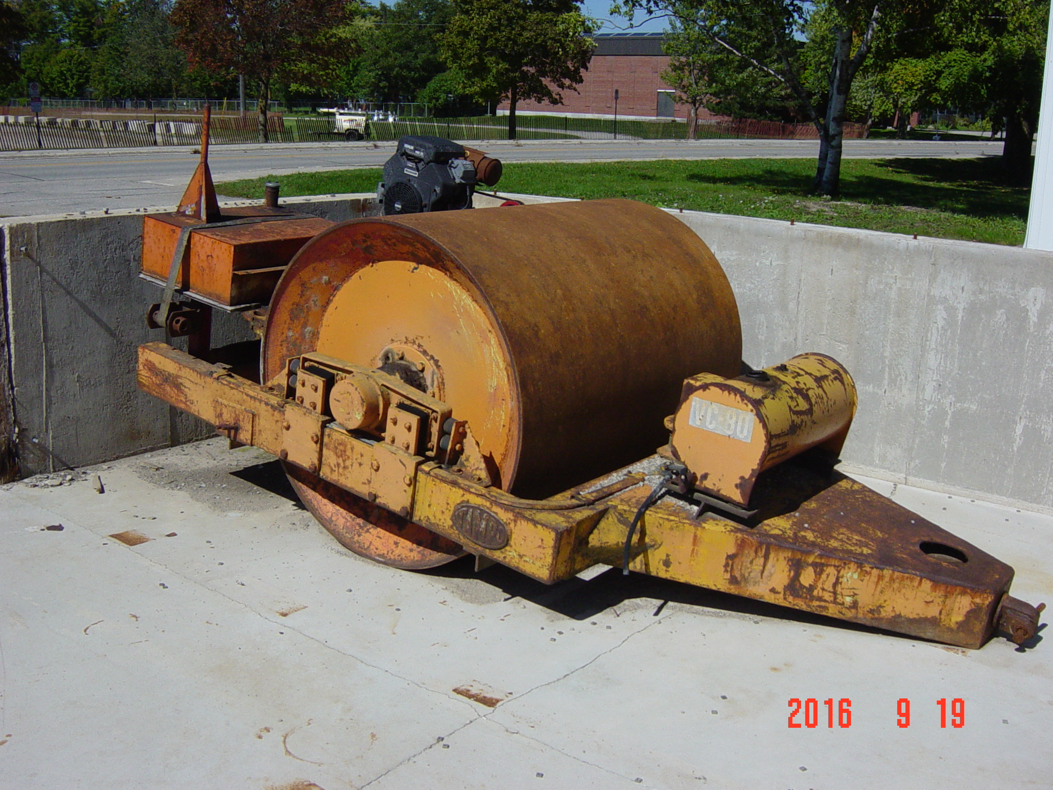

   / HF 70lb hammer and tamper #28
Your post reminds me of one outfit I worked for that their newest piece equipment was 1960's Mac trucks. They had not only one of the tow behind vibratory rollers in your photo, but a sheepsfoot roller as below and a 1928 Cat self propelled sheepsfoot that we used at he Ithaca airport in 1983. When that showed up on the job, the engineers had a bird. They said we couldn't use it but then the company owner found the specs that it was still considered acceptable and we used it for initial compaction on the entire job.
Smiley
