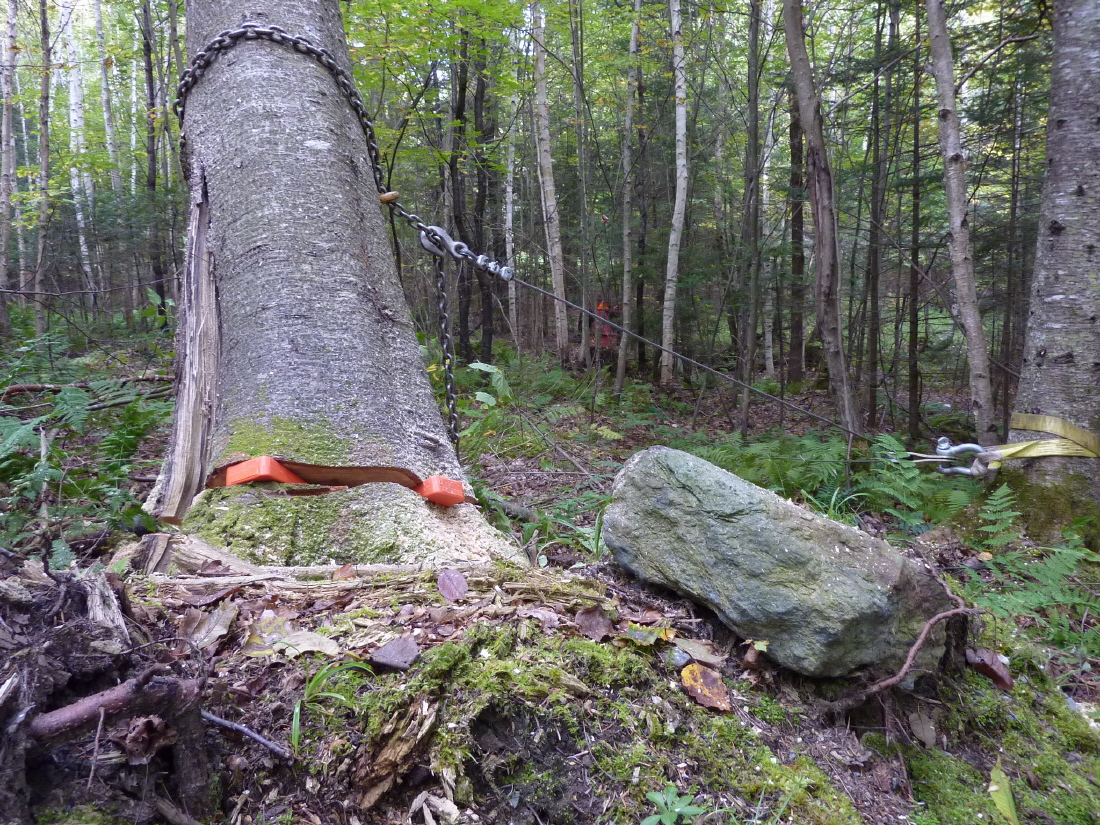

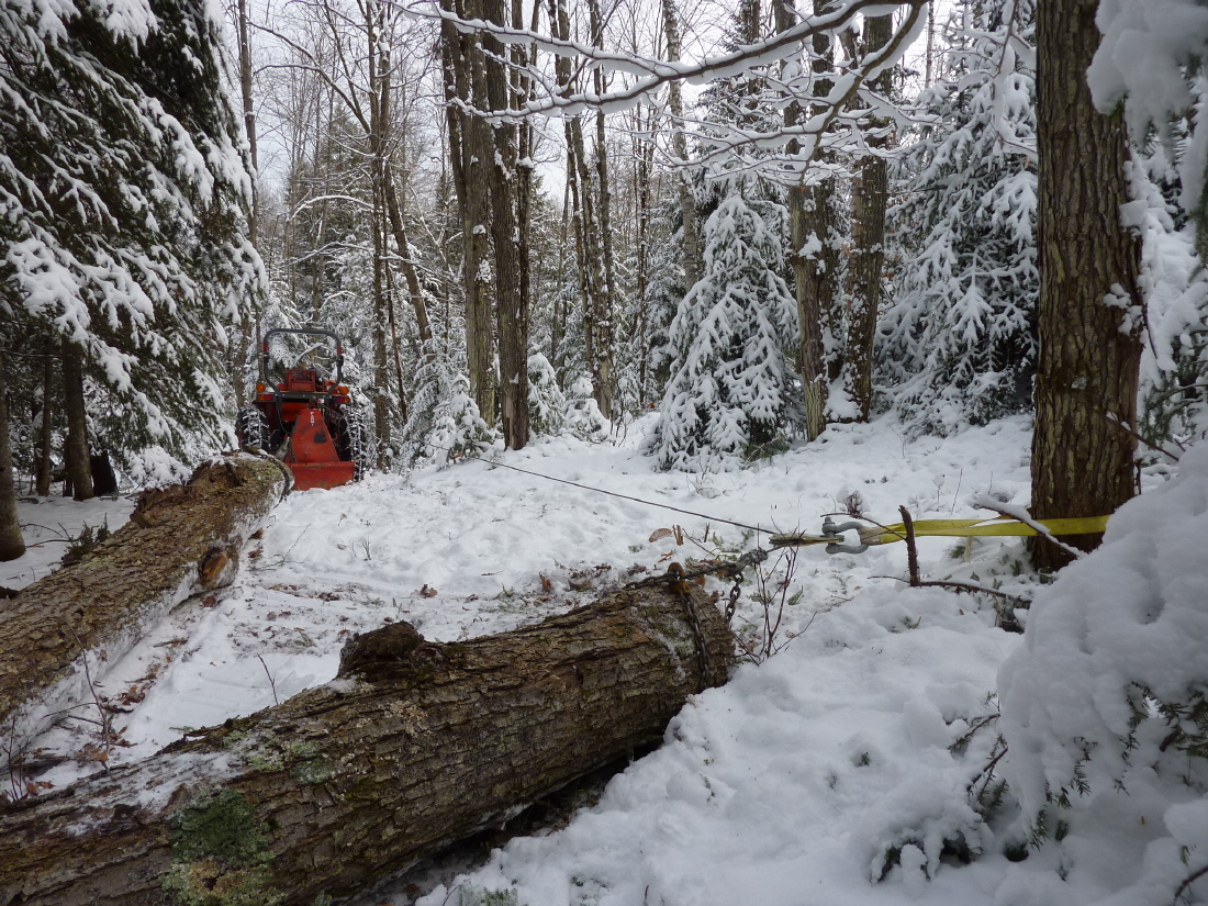

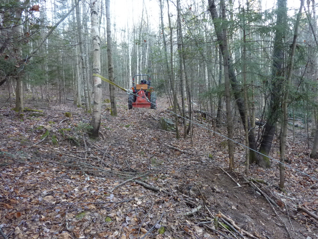

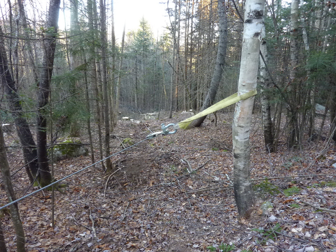

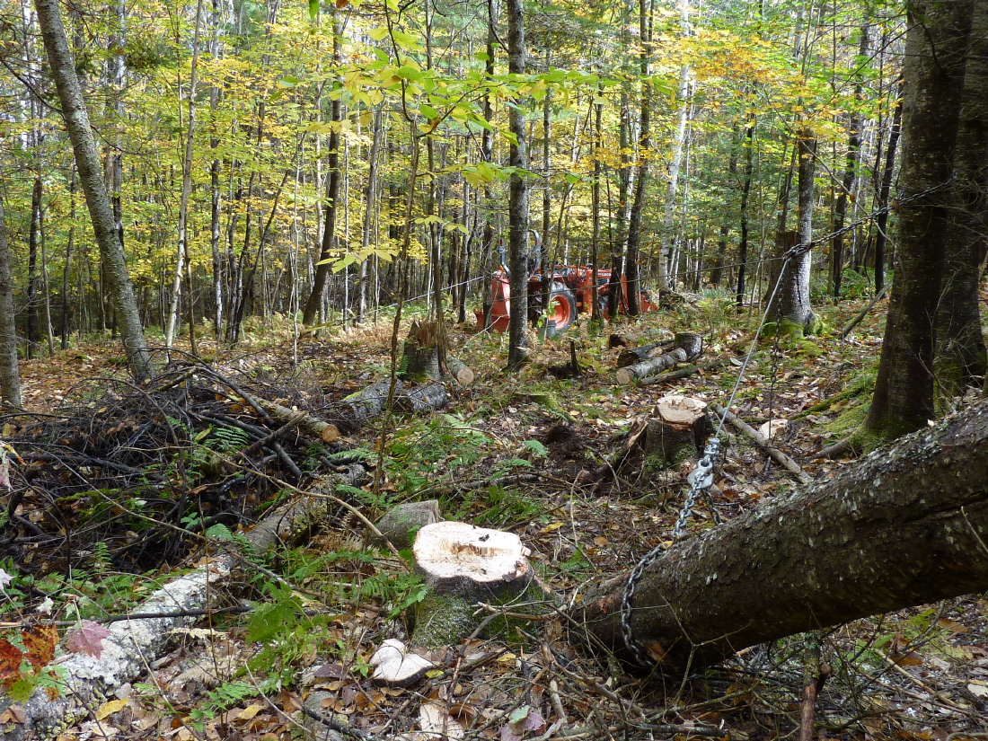

Lines set to pull several trees up a bank.

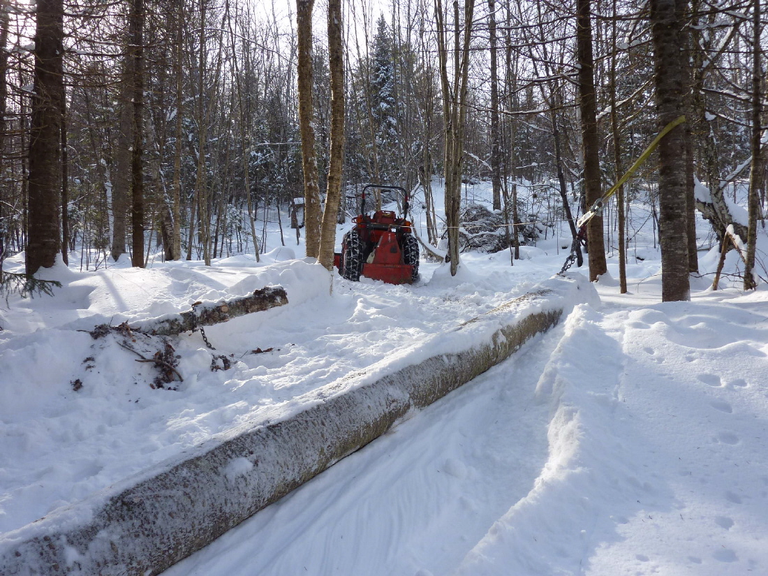

Setup for pulling logs that are 90 degrees to the road then turning them in the road.
Here is a hung up wind throw that split. I couldn't pull it straight back because it was blocked by a big tree
I didn't want to damage so I pulled it off the stump sideways before I used the snatch block again to pull it back to get it down.
