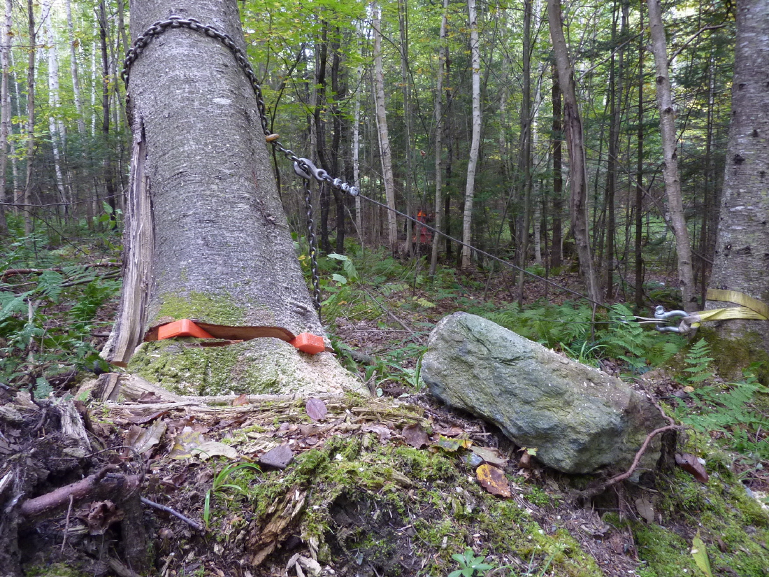

Here is a hung up wind throw that split. I couldn't pull it straight back because it was blocked by a big tree
I didn't want to damage so I pulled it off the stump sideways before I used the snatch block again to pull it back to get it down.
