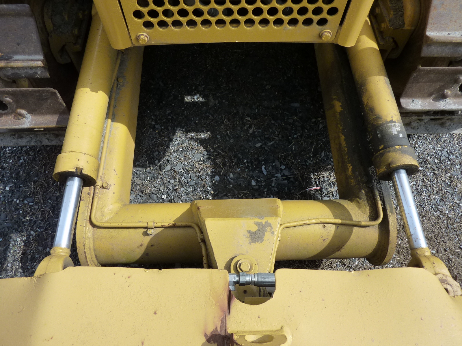

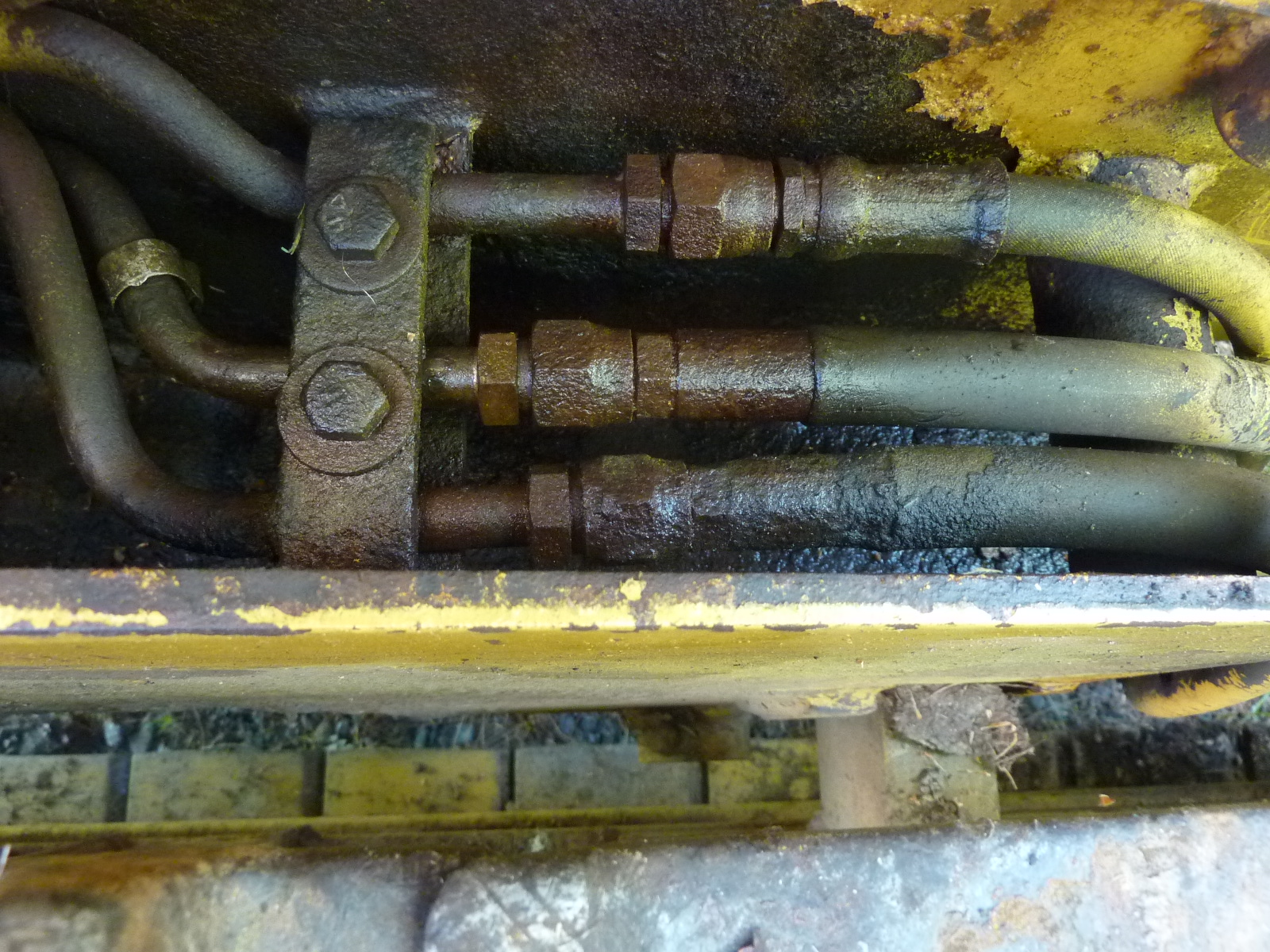

I blew one of these hoses Wednesday last week.

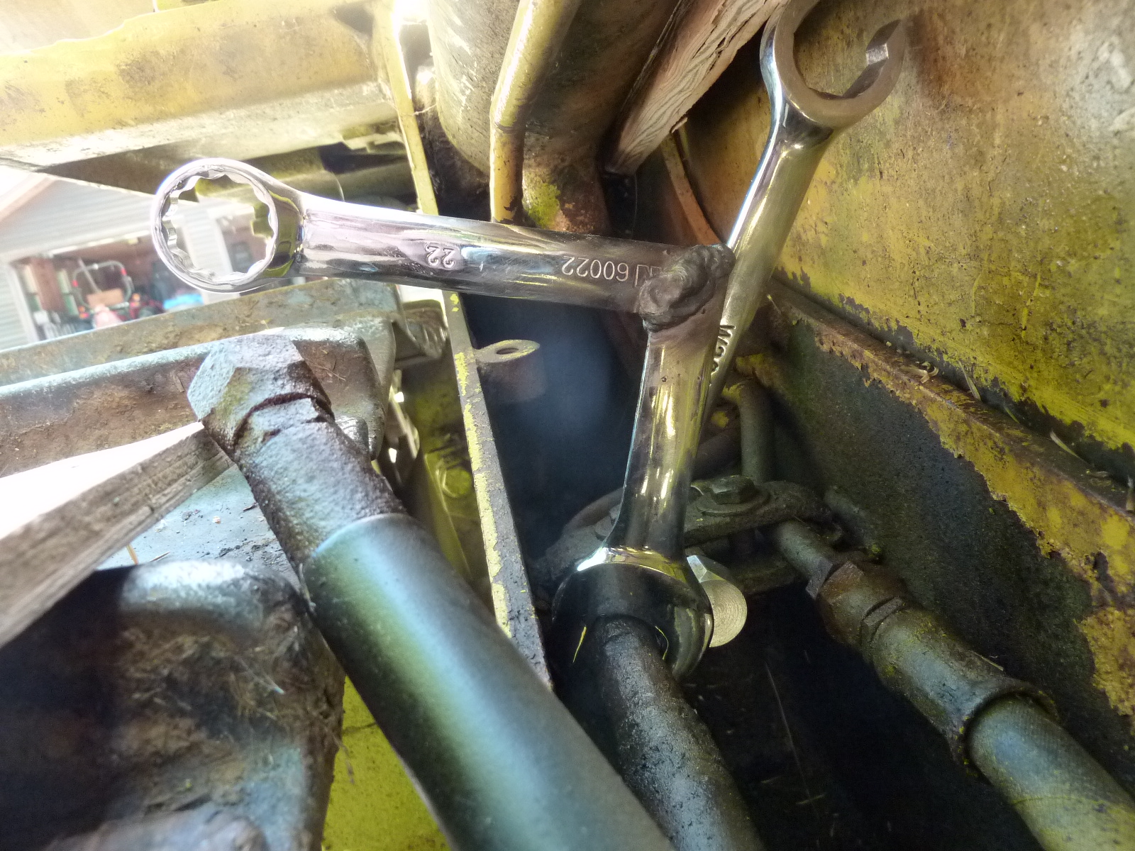

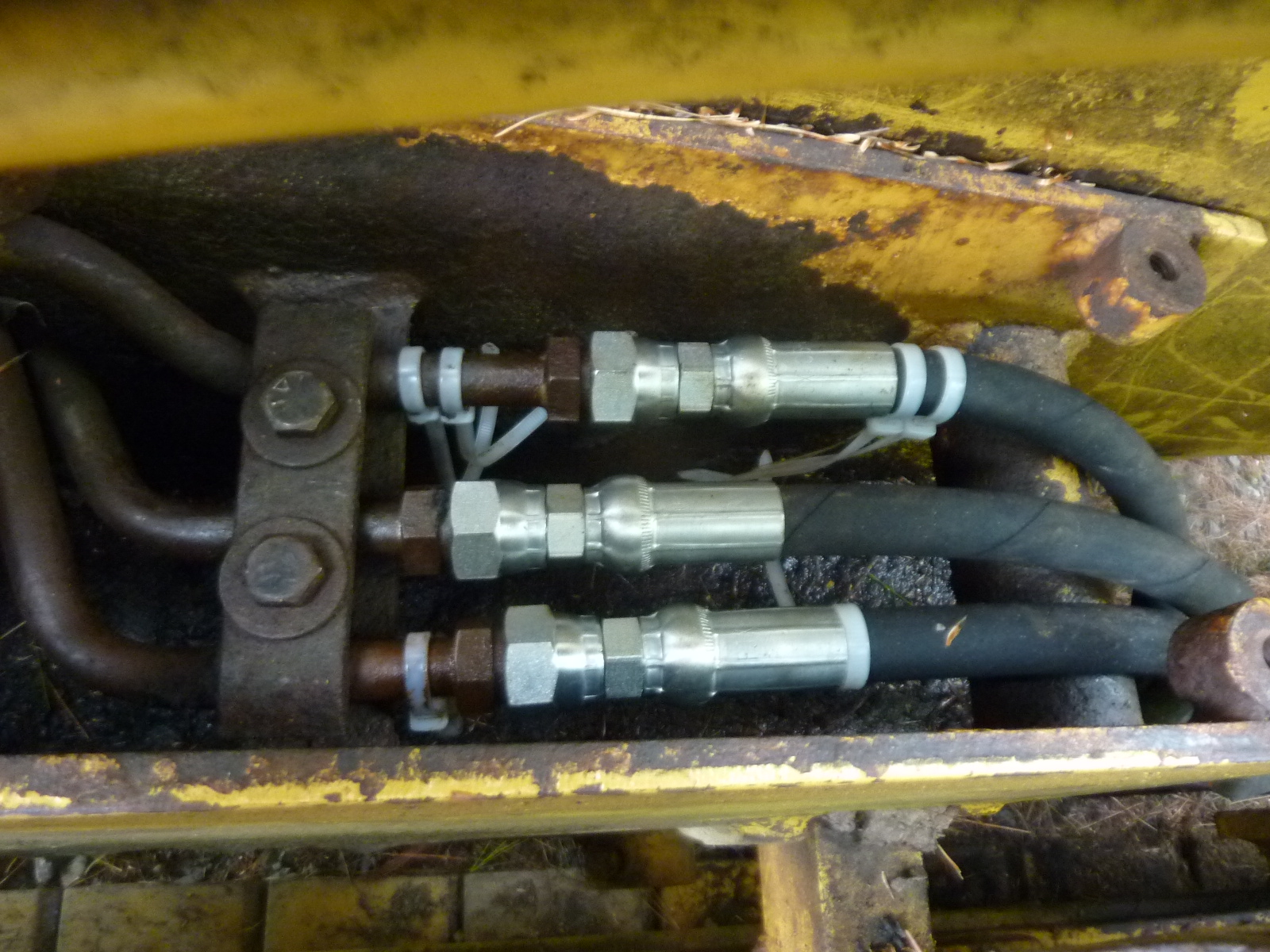

Decided to replace all three and had to break the connections in this box w/o putting to much torque on the old steel lines.
I started spraying with PB Blaster 3 or 4 times a day. Ordered new cables from DisCount Hydraulics Thursday morning. They were shipped Thursday afternoon and I got them today UPS Ground. Pretty good. I made a tight fitting 7/8" "box" wrench from an el cheapo Titan 22 mm. After 4 days spraying they came off easier than I thought they would except I had to cut one hose in two because I couldn't free the female swivels on either end of it.

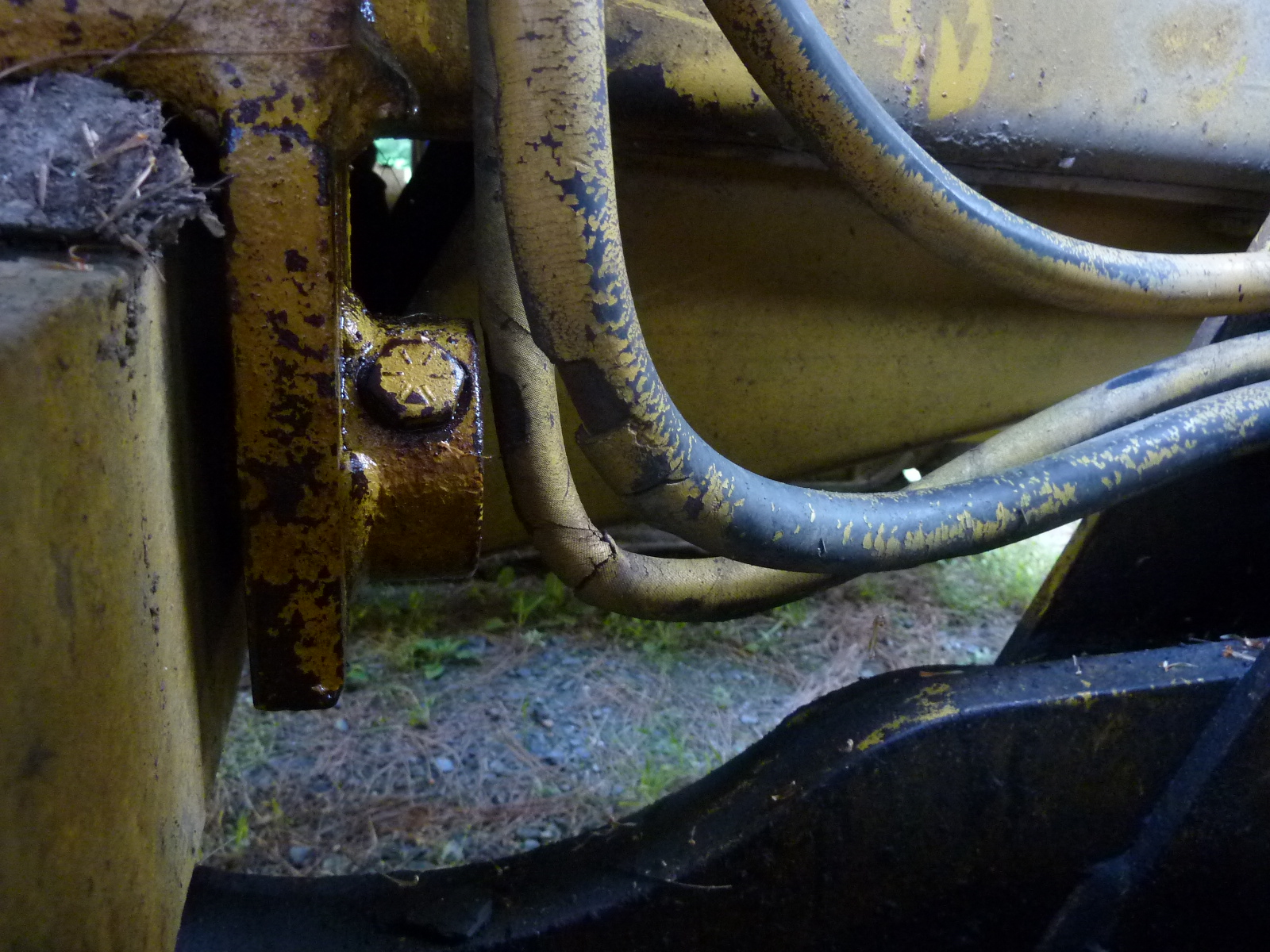

Looking at the pictures I may have tried cutting the hoses and using a deep socket to get them off.
That was plan B if I had trouble with this easy approach. I was a little leery of trying a no turning back approach right of the bat since only one hose actually leaked and I also wondered about all that metal grit from the cutoff wheel getting up into the steel line somehow. I would have had to cut thru the fittings. This isn't something I do every day so I go careful.

I have heated hoses up before right by the threads that look that rough. 15min job removing all 3.
I do like your custom wrench.

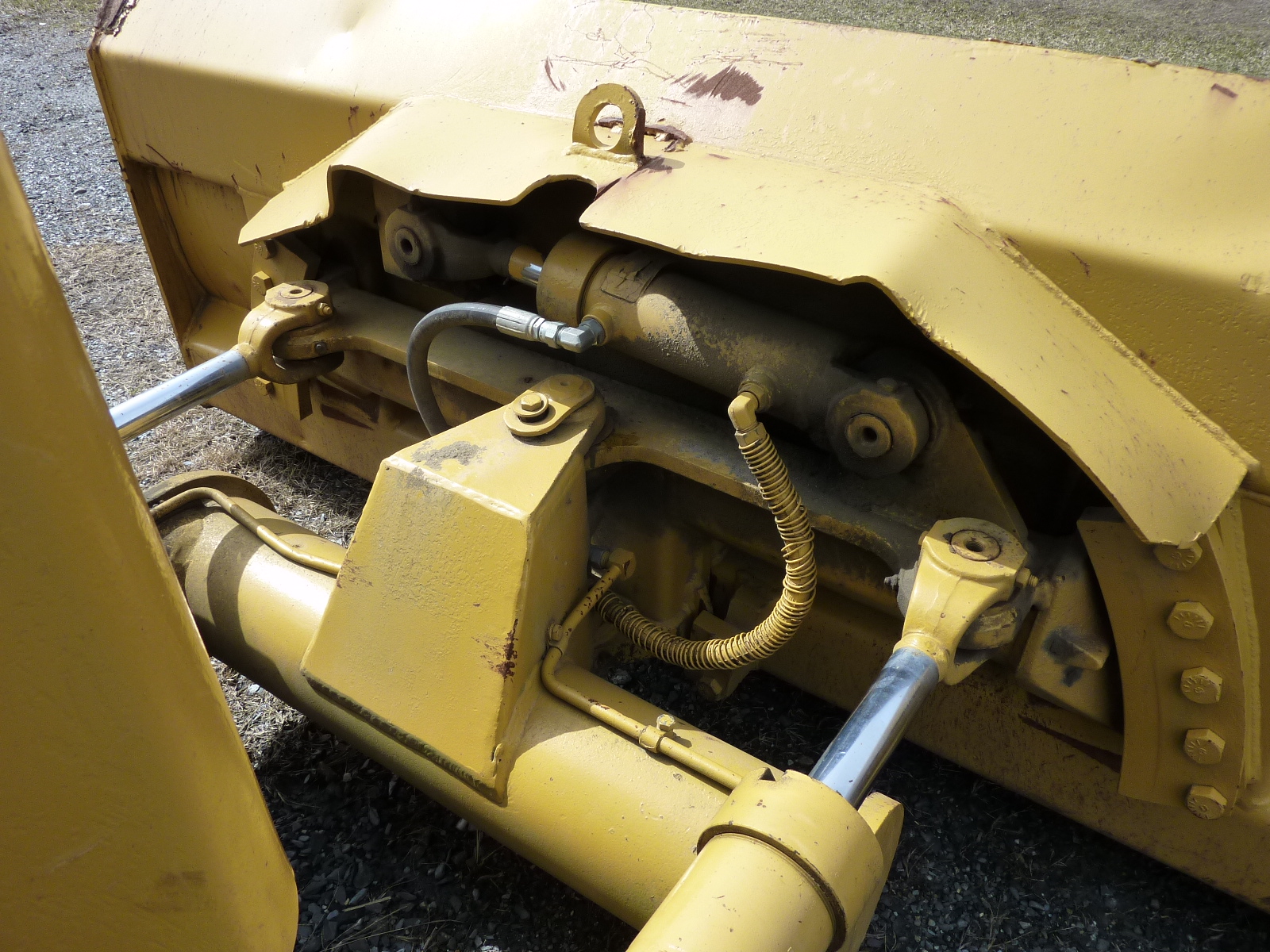

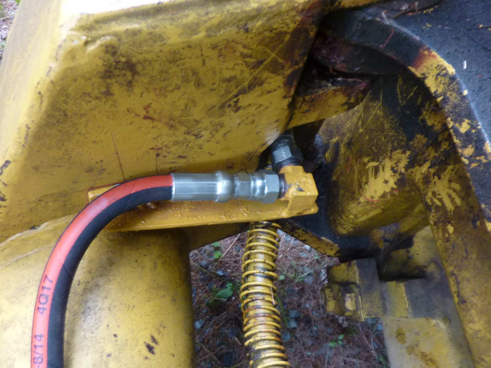

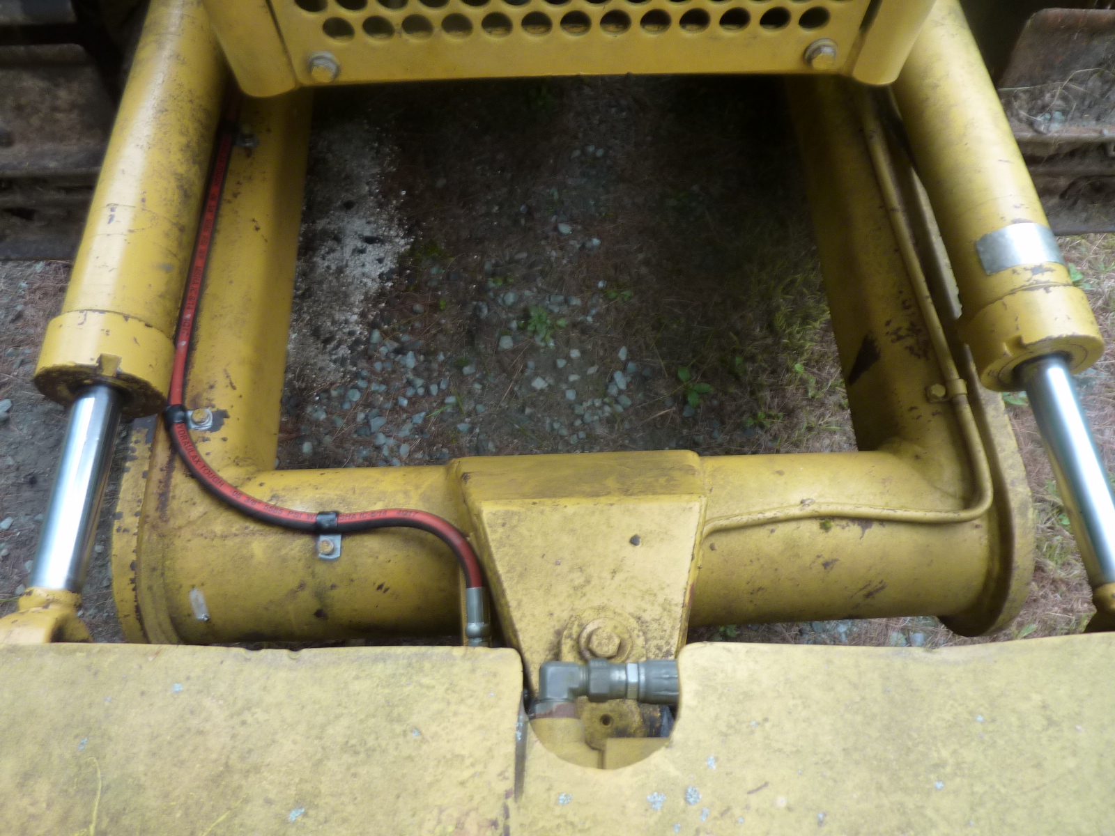

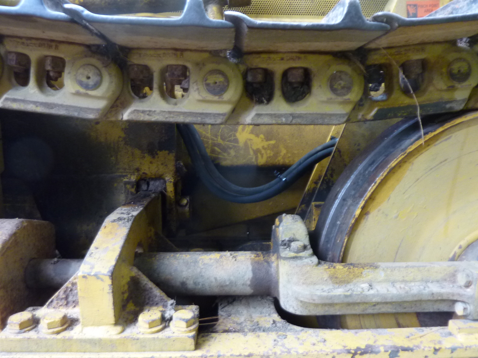

Rainy afternoon - a good time to kill time and post pictures of what I ended up with. Rerouting eliminated the hose pinch point between dozer frame and blade C frame.
Originally the tilt line went back to steel and ran along the C frame. The steel line ended in a 90 and supported the tilt flex hose.
I changed the steel line over to hose and made a bracket to hold the 90 and support the tilt flex hose.
gg
I wondered about heat. Good to know you can do that. I looked up the oil flash point - about 200 C IIRC. Didn't know if that was just in open air and what would happen in a closed tube. So - how hot ? Do you get it red ?? Thanks
