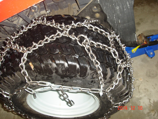

Have studded chains and the backhoe on ,and was trying to up this slight hill in the back yard. The hill is on an angle sloping away from where I wanted to go, I thought it would be not problem, but in 4wd the front end was just starting to slide down hill and not in a direction I wanted or needed to go!. I stopped backed up and put the 2 link twist chains for the fronts on. Tried again it it was much better, I think the tractor is just not heavy enough at times,. You can see my tracks in the pics
