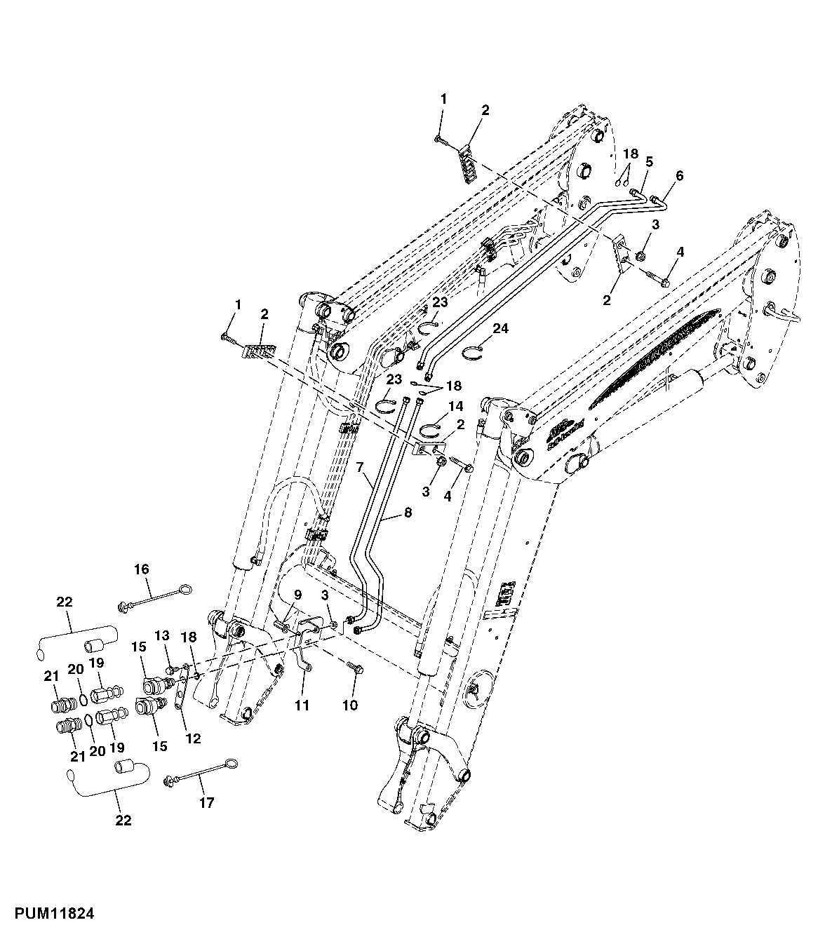

Wondering if anyone has pictured they could share of how the lines attach to the front of the loader were you hook up your lines for the 3rd function. Mine has steel lines with a bracket behind them, but the lines them self do not attach to the bracket. Called the dealer and they said that's the way it suppose to be. Makes me a little nervous that the steel lines are able to move around a little.
/ H260 loader with 3rd function #2
Not the same loader, but I think you need key 12 in the drawing to bolt to the bracket. Then the quick couplers mount to it. Key 12 is part number W51453
