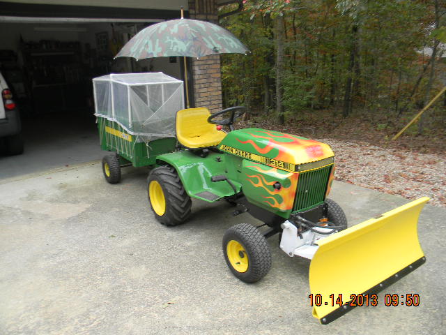

81 jd314 garden tractor
Has any one had any experience changing out a h1 system on a jd 314 from a jd316,317? My 314 has a h1 system and I need at least an h2 for my 314 to operate the angle part of my blade I recently bought
Any imfo would be appreciated.
Thanks

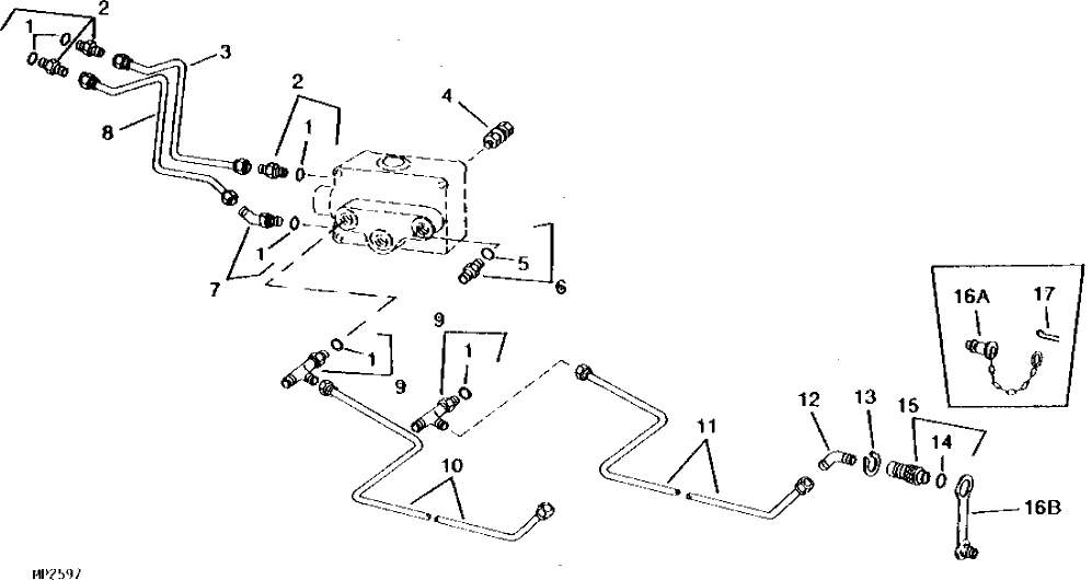

/ H2 or H3 hydrauliics #7
This parts photo for the hyd lines on a 314 is the only one listed in PC #1618 and as you can see the lines for frt/rear couplers are merely teed in to deck lift valve. I owned a 314 from '87 -'13 when I bought a zero-turn.
HTH's,Jim
