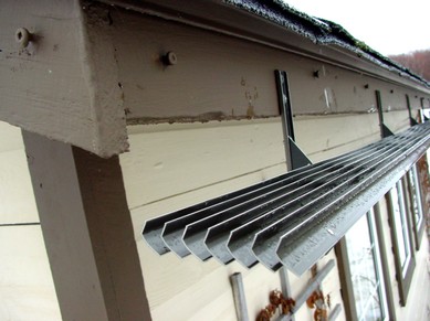

I've been using GutterBrush for five years now. We've got a lot of maples around the house and the gutters were always clogging up, usually at the downspout drop. Since I've put the brushes in I haven't had any problems with clogging. Very easy to install, just drop them in the gutter, slide it down towards the end, drop another one in
