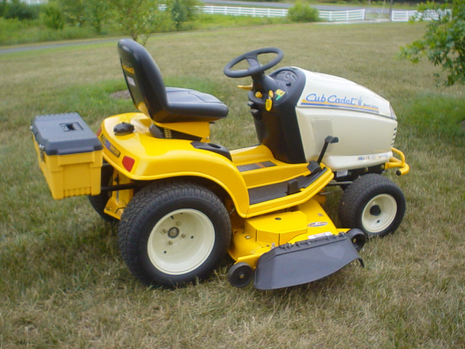

Evening Gents,

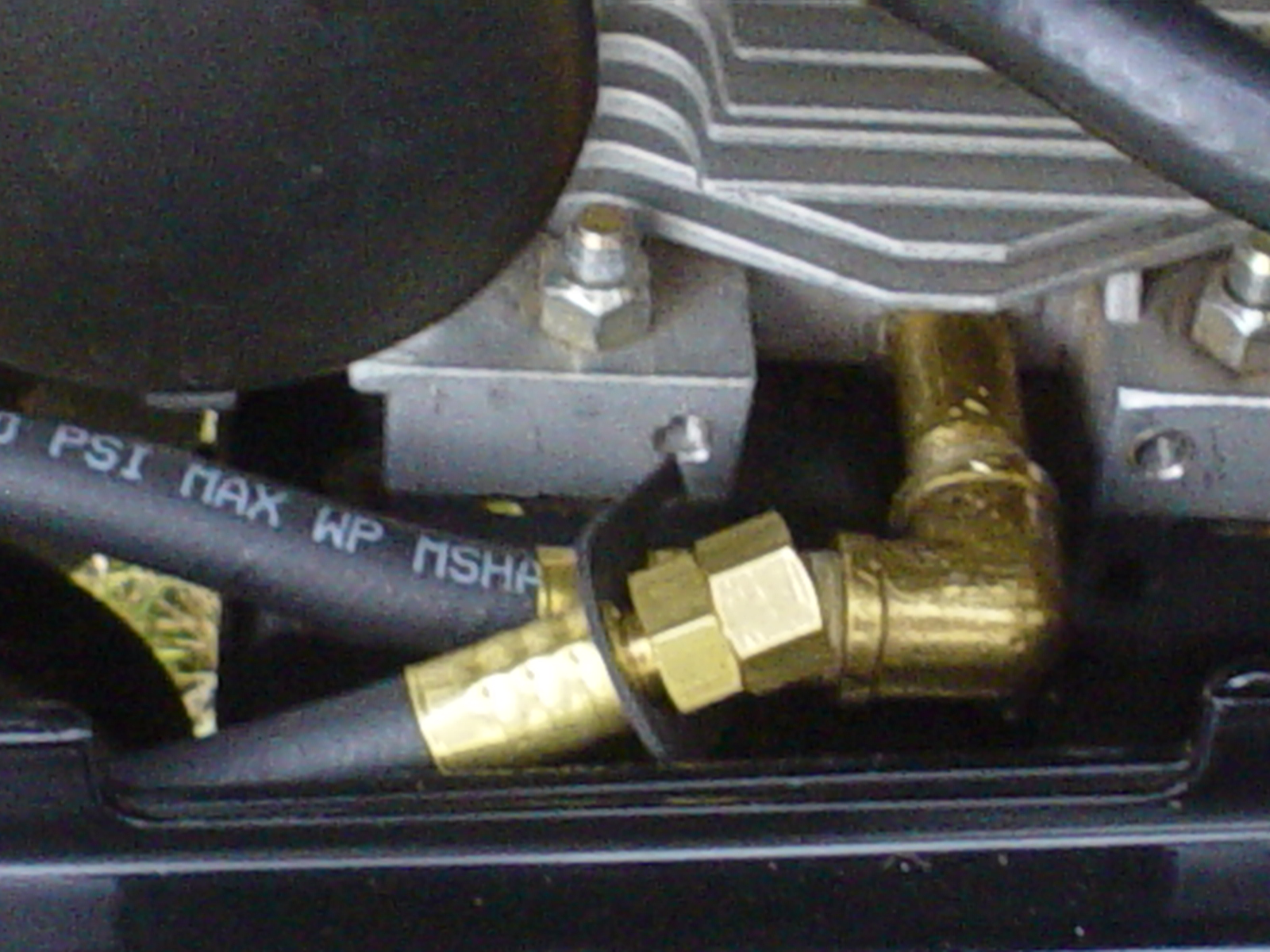

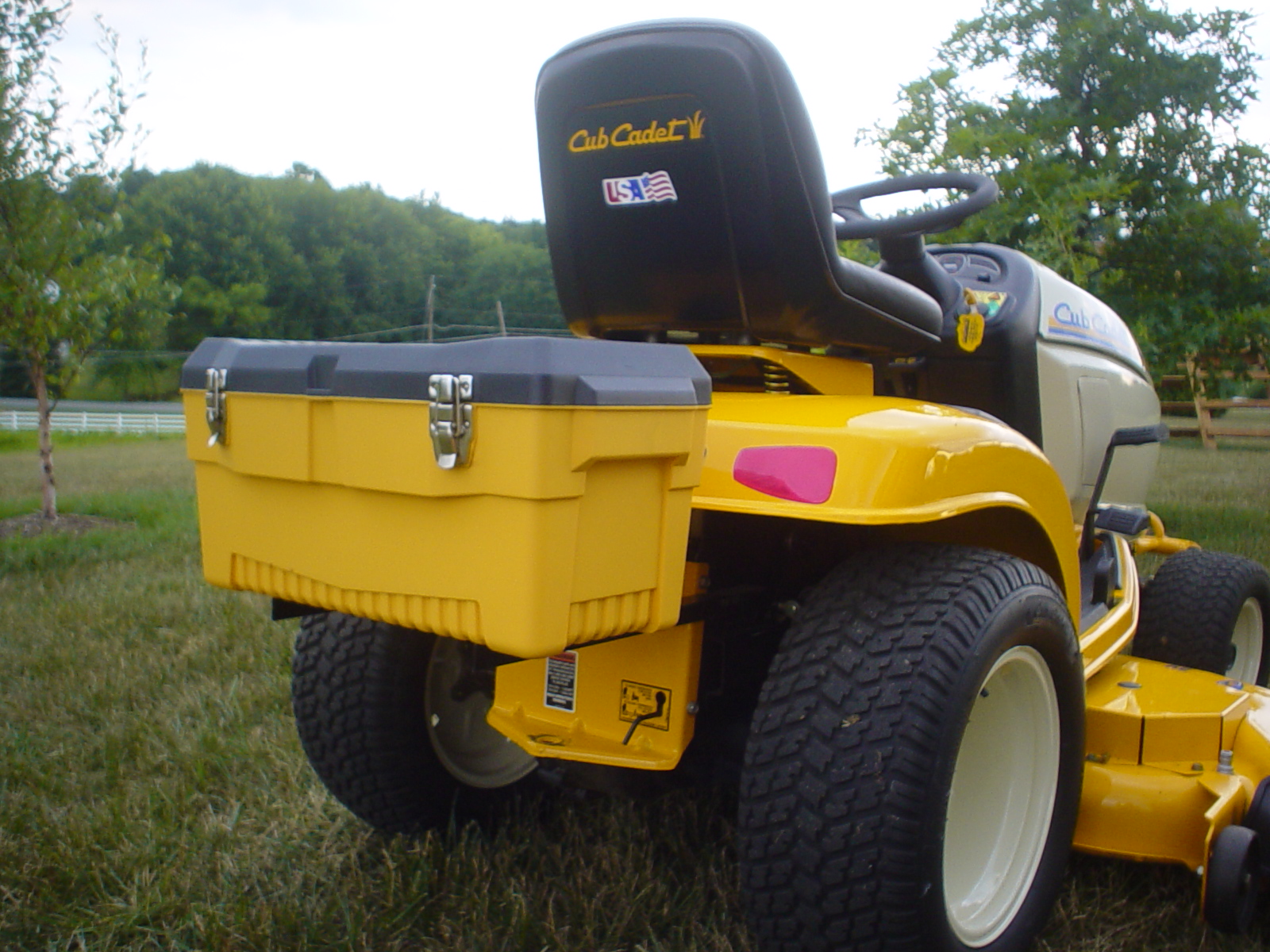

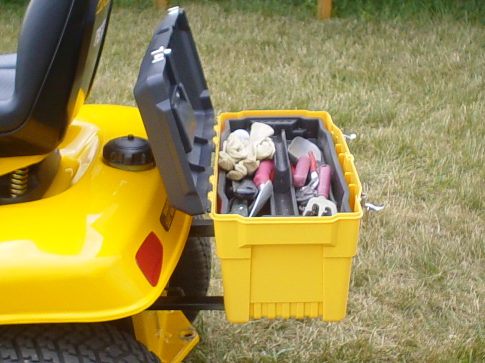

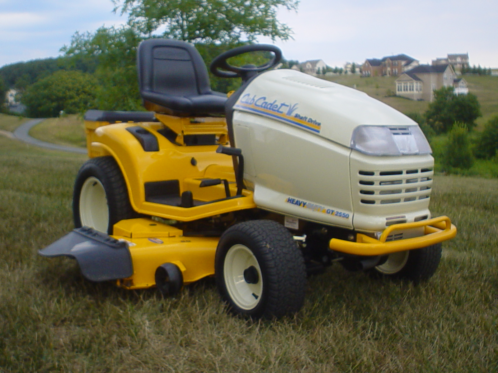

In an earlier post I mentioned I had added a Drainzit oil drain valve to alleviate the PITA factory oil drain valve. Someone asked for a pic so I thought I would post a couple of pics of my 2005 GT2550 with some minor add-ons. They are; a tube bumper I found at my dealer in his "barn" in the back of the store, a drainzit oil drain valve, a switch for the lights, and a toolbox I picked up at TSC. Last pic is my college student son.

Really like that Drainzit setup, I'll have to look into adding one. I have only changed oil once but my fingers are to big to deal with the present setup. Nice Job.

I like the toolkit.

I notice you added an oil cooler to the Kohler. Given what some of us have seen lately for temperatures, I think that was a good idea...
/ GT2550 Minor Mods / Toolbox
Thanks guys. The drainzit is slick as grass through a goose. No more oil spills when changing the oil. Best $20 I have spent. The toolbox, some angle iron and nuts / bolts were about $25 all in.
JSharp, actually the oil cooler was factory installed. The placement is pretty slick. They cut a place out of the shroud so the flywheel forces air through it. You have to pull it once in a while to clean the back side where the air forces grass debris to get stuck.

I"m farmiliar with the cooler. I bought a Kohler kit and put the same cooler on my 2554. It's a nice clean setup. Seems like the Cub cost savings program that gave us the new deforming plastic hoods also eliminated the IMO necessary oil cooler...

Here's an alternative to making oil easy to drain.
Fumoto valve. I have one on my car too. Fantastically easy to change the oil. Now I need to order an oil cooler kit. I like that idea.

Pearlmanz, here is the link.
Amazon.com: Hose, 3/8IN Port Oil Drain: Automotive
It is the 3/8" size. I also used a brass 3" nipple and a brass elbow (both 3/8" and bought at the local hardware). It should fit your 2542tractor. It is a bit of a pain to install. You will have to loosen the four bolts that hold the engine to the frame rails then pry or wedge the engine up off of the frame to get enough clearance to get the old valve off and put the drainzit valve on.
/ GT2550 Minor Mods / Toolbox #13
pearlmanz you're right, that clear plastic hose that came with your tractor is for changing the oil. It slips over the end of the Kohler oil valve. I added a plastic tee to mine so I don't have to bend it around. The Kohler valve still sucks though. The drainzit setup looks much nicer.

The oil cooler isn't a difficult install but for 2 things. You need to cut a rectangle out of the plastic shroud. Not a big deal really if you have a Dremel tool. But you also need to make square holes for the cooler mounting fasteners in the shroud and in the metal shroud mounting bulkhead. They give you a new metal bulkhead with the kit but it requires flywheel removal to install. So I just drilled the holes for the fasteners then made them square with a small file.
The rest is easy. Remove the oil filter and filter mounting stud, mount the sandwich adapter and cooler, then reinstall the oil filter. You also have to replace another small metal shroud part around the left cylinder but they give you that part in the kit.
Looking at these oil temps as some of us have, the cooler is a worthwhile investment IMO. And there's only one reason Cub deleted it on the later 2500 models. $$$ of course...
