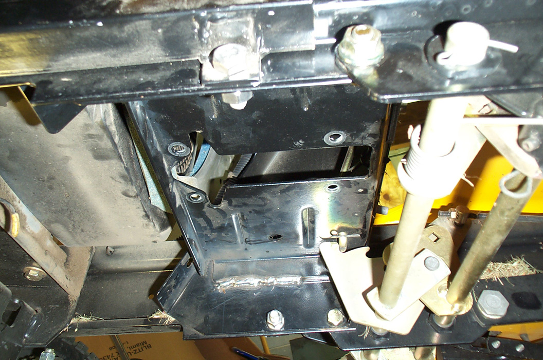

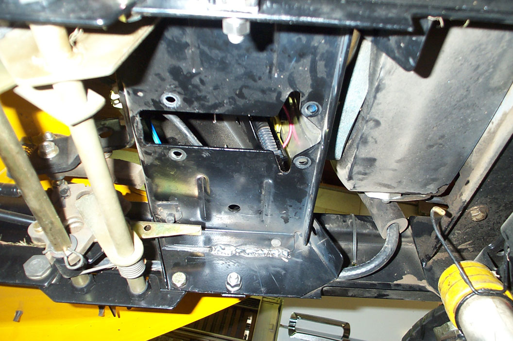

I started this discussion in another thread, GT2550 Minor Mods / Toolbox, about my steering rebuild and custom attachments. Recap:
I've had a 2005 model GT2544 Cub for a couple years now, love it, my only gripe is the steering. I had to rebuild the steering housing, the steering shaft bushing was worn along with the pinion gear. After I got the parts ordered and cleaned up the housing I found a nice crack that I believe was due to the whole frame mount plate flexing. It was not attached at all on the bottom with only two spot welds holding it in on the top right in the dash support. I attached some pics of the steering housing crack before I had it welded.
I also welded the housing support plate to the sides of the dash support between the frame rails. I can say with certainty that it will NOT be moving now. See attached pics... ;) (please don't make fun of my welds, it's no fun welding upside down on a creaper :rolleyes:)

Those welds don't look bad to me! Way better than the amateur bird poop beads I'd leave. Can I ask how many hours you had on your 2544 when the problems cropped up? I've had a very sloppy steering shaft bushing since new on my 2005 2544.

Morkai, looks good to me. As long as it is solid, that is all that really matters. Nice work.
/ GT2544 Heavy Duty Mods #5
Those welds look fine to me. Lots better than the factory skip welds where they mostly skip the welding. ;)

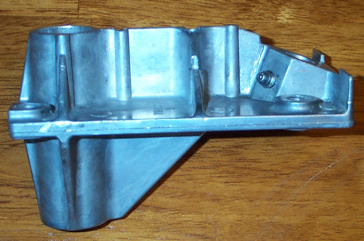

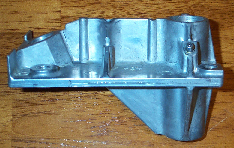

What doesn't look good is that lower steering flange/housing. It looks like a zinc casting ie. pot metal. Is that right? I can't see a zinc casting holding up very well there.
The later models use a simplified system and the lower housing is cast iron. Of course mine came with a missing zirk and didn't even have the hole drilled for it. Fixed by a recall. Glad I have a good dealer that picks my tractor up and brings it back for free...

Yetti, do you do anything other than mow with yours? Grrrrrrrrrrrreat. Mine has the cast aluminum (or what ever it is) housing for the steering gear as well. I've greased it once or twice. I better get out there today and grease it again! No problems as of yet, but I'm just over 80hrs with the extremely dry summer we've had. We stress over transaxle, engine oil, filters... and forget about the important stuff!

JSharp, it's cast aluminum. Mine also has the press-in zerks as you can see, but they seem tight and have not pulled out so I left them. I did not know the new design was iron, that's probably an improvement.

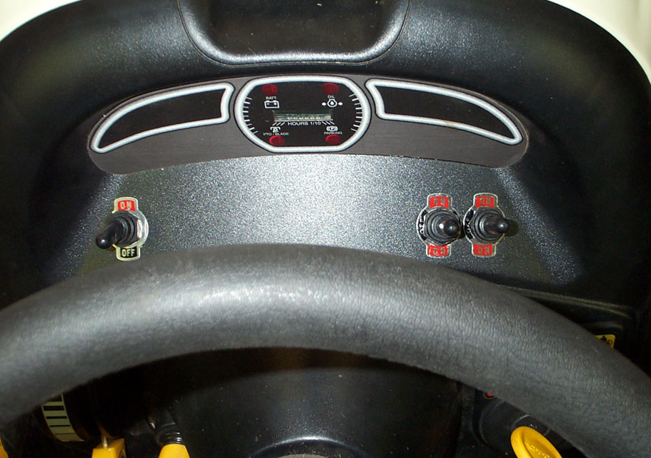

GRB also inspired me to add a light switch, something that's always bugged me. I'll attach a pic, light switch is on the left, FEL controls on the right.

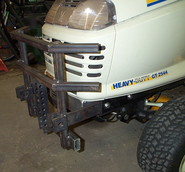

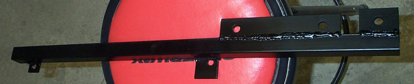

I took some pictures of one of my frame supports after repainting. You can see where the two bumper bolt holes line up and the front hole sticks out past the frame and bolts directly to my 3/8x2" frame bars that slide into the frame and are the main mounting point for the loader. The bottom two tabs bolt to the holes I mentioned earlier, one of which can be seen in the underside frame pics. They keep it snug just under the C-channel.
Also attaching a picture of the front bumper/brushgaurd/attach point before I fabbed the frame support rails, should give you a good idea. It's pretty much still the same except for the 3rd bolt hole location just in front of the frame. I'm going to have to do some alteration to the lower outside rails because of clearance issues with the arm mounted actuators. After it's 100% I'm going to paint it cub yellow to match. :cool:

Morkai, I can see good reason for the bracing if you'll be using any kind of loader. The frame is adequate I think for any of the factory accessories but add anything much heavier and I'd start to worry.

Well, finished modifying my front gaurd, let me know what you think. I personally liked the way it looked before, but I had to make some clearance for the actuators. Time to paint... :rolleyes: Got it blasted and primed today, hopefully it'll be yellow by tomorrow afternoon.
You'll see later why I had to make clearance when I post some more pics of the whole project. You can also see how the 3rd mounting bolt fits in one of these pics. That main 2" bar is 3/8" thick, I'll break the CC in half before bending that stuff. I tend to err on the overkill side. :eek:
