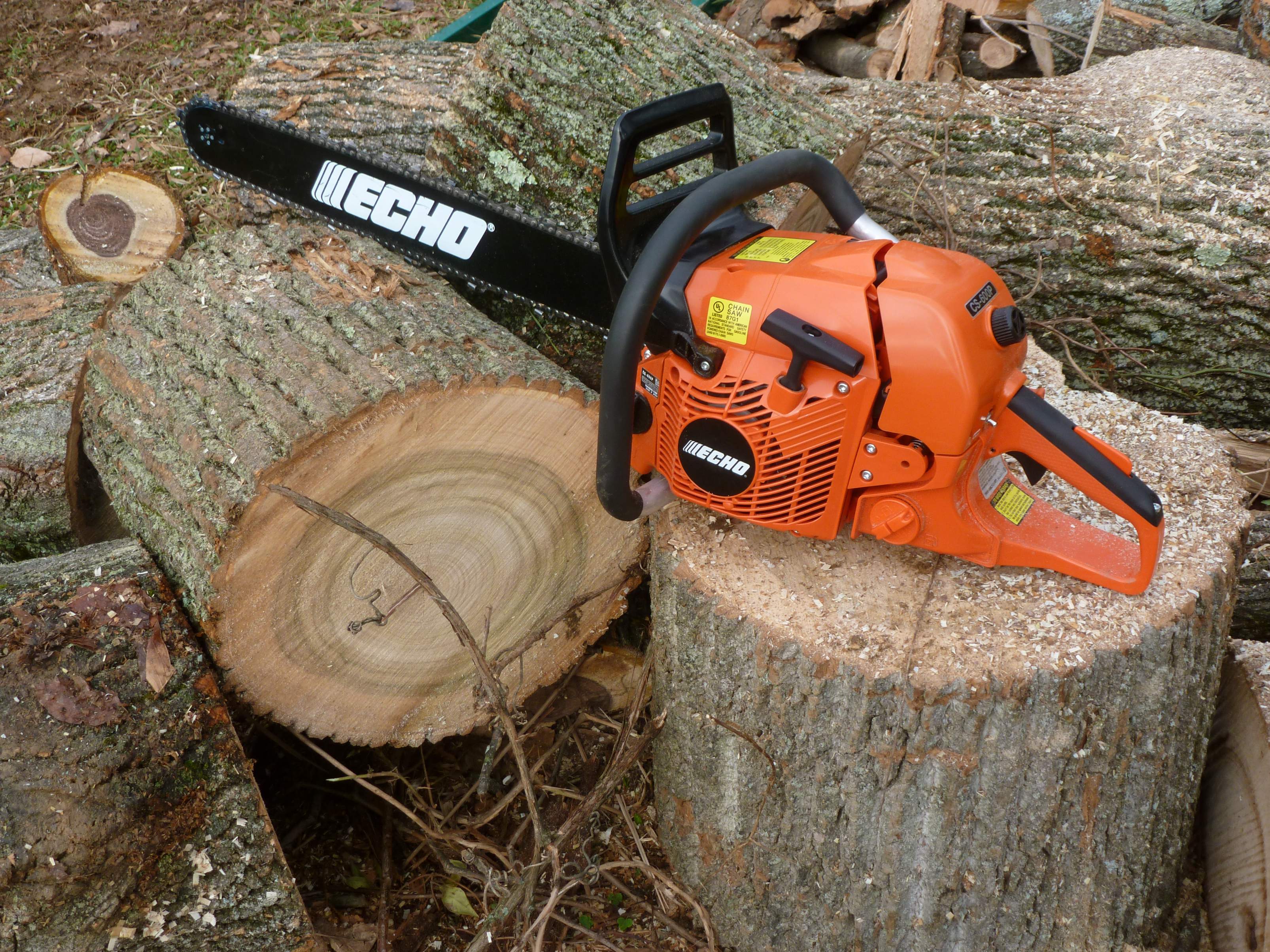

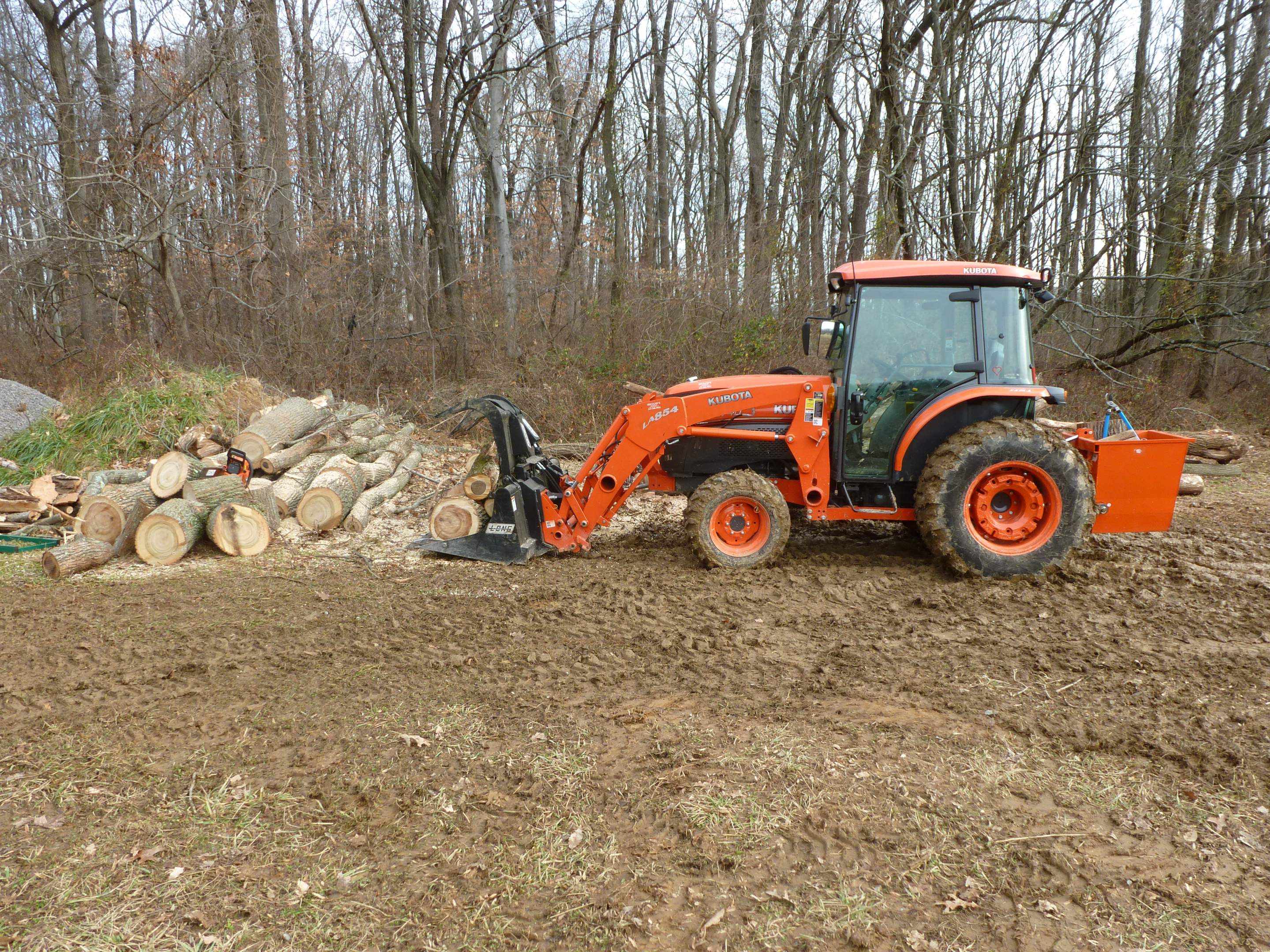

I put the new chain on the 450 today, it made more noise, a whirring noise, and while it cut ok, the bar smoked at the end. And when I compared old and new chains, not sure they are exactly the same, so going to
inspect further before I run them again. Used the big saw and even with a not perfectly sharp chain, it ate the logs easily.
Getting down to the bottom of the second full pile of logs. Might wait on making another unless I have a really cold winter day; right now it's mud city.
my new log holder worked quite nicely. Clearly one can't cut in the middle of the saw or it will yank the wood your way, but cutting where I think one is supposed to, near the motor, the logs just fell off zip zip.
Yeah, you have to lug the log to it, but this way nowhere near the ground, and the whole thing is visible.
now that I'm not flooding it, the 600 starts just fine.

Back to the dealer time. It sounds like they gave you the wrong gauge size for your bar. Continuing to use will damage the bar. Heat will build up quick. There are only a few size guages used on chainsaw chains. 1.1mm (.043")
1.3mm (.050")1.5mm (.058")1.6mm (.063"). If you have a mike check the gauge size on the old chain and the new one. I think you will find the new chain has a larger gauge.
/ Grrrrrr
#24
makes sense, I had problems installing the chain, but got it to rotate smoothly by hand, so thought it had to be ok.
I had greased the bar tip and I think the grease in there was smoking, a canary in the mine that something is not right.

Glad you got the 600P sorted out -- that is a nice saw! In my experience, you'd have to try extra hard to make an echo hard to start, so I will bestow on you the honorary idiot of the day award. I give it to you with full accreditation as an idiot myself ;)
Does the 450 bar have any specs stamped on it? I agree, you should confirm the chain is the correct gauge. That saw would likely either be .050 or .058 depending on how it was originally equipped.

too wet and foggy to be out today but did run my saws to the local shop where I bought them and they confirmed I had bought the next larger pitch chain from the other dealer.
Its the "more aggressive?" pitched chain similar to what was on the 24 bar, but sized for my 450's 18.
And it likely mucked with the bar a bit, which luckily I had thoroughly greased. But we both eyeballed the bar and the channel still looked pretty good.
Having two saws with two different pitches is something apparently I have to get used to.
I think you mean "gauge". Pitch is the distance between drive links, guage is the width of the drive links. Pitch change would not affect the bar, only he sprocket.
