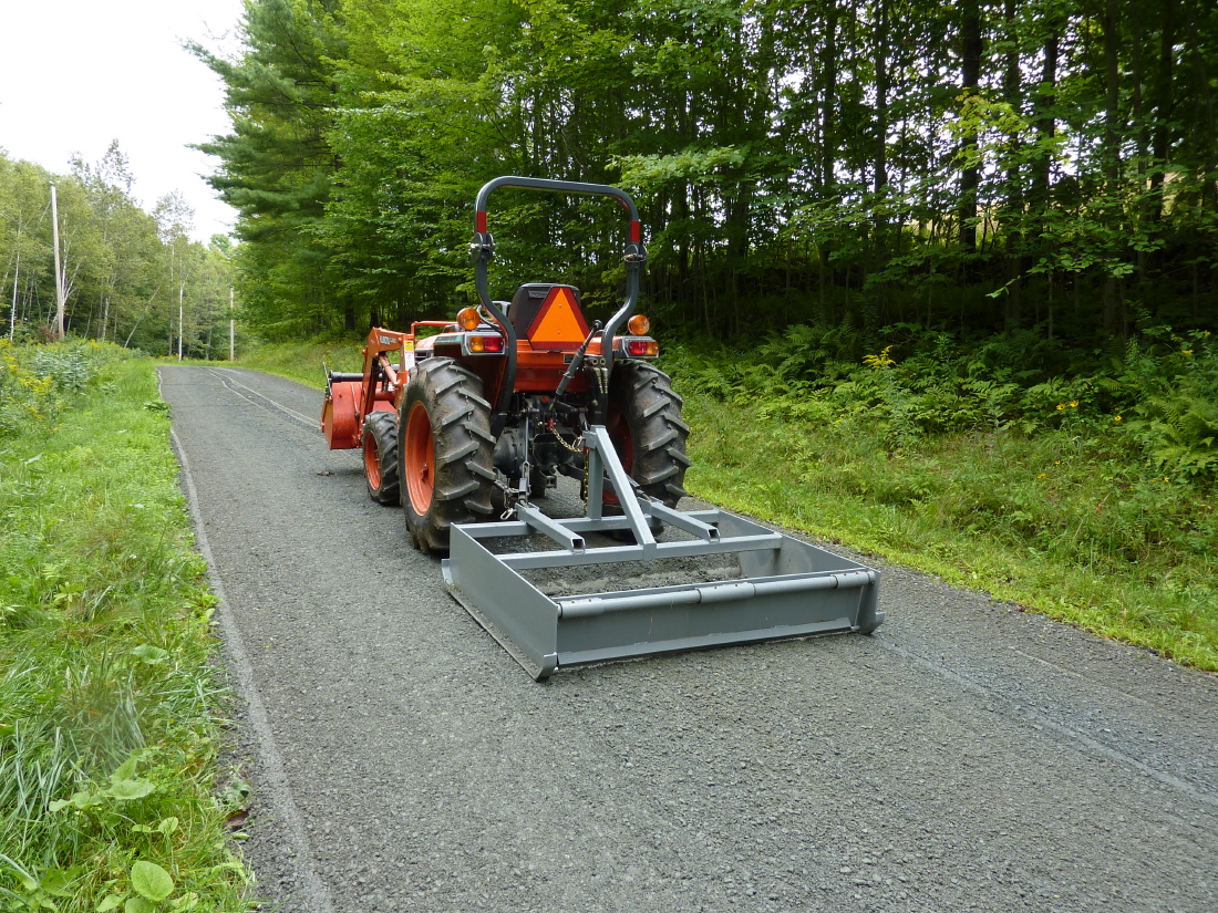

I have all three and use all three to maintain my roads. The dirt road off the paved highway has a constant slope of 4%. The unfortunate problem with roads in the desert is that they are always lower than the surrounding land. This means that all the water drains into the road which is a big trough, hence a lot a water running from a small amount of rain. Four percent doesn't sound like much, but when water runs over desert sand at 4% it quickly erodes. The second problem I have is it is part loose sand and part caliche. The sand erodes quickly, the caliche stays.
After every rain, which fortunately only occurs once or twice a year, all three implements are put into use. The road is superelevated, that is it drains to one side as there are no neighbors across from me. This both minimizes the erosion in the middle of the road and makes the silt removal easier.
First passes are with the rear blade, angled and pitched to throw the silt up and out of the low side. Next comes the box blade to reestablish a constant superelevated slope. Final finish is with the land plane to get a nice smooth driving surface again.
Due to the caliche, I usually have to wait 1 to 3 days after a rain or it's too gooey. If I wait more than 4 days, it hardens into "concrete" which my 7800 won't even rip.
It can be a real PIA if it rains on Saturday - Sunday as the timing is so critical.

Not having a plane, I can only base my two cents on the numerous pictures that other have posted, and thus the basis for my suggestion that a rear blade be the choice, if only one implement is to be purchased.
Every one of the pictures shows an extremely flat road, with little or no crown. Also, often it appears the planes let some gravel fall to the outside, which seems to establish a little berm, which also helps to hold water. Thus, more frequent grading it required, as potholes will develop. If more of a crown was established, it would seem less grading would be required. Again, from the pictures, it does not seem the plane (or a box blade) can be angled, so creating a crown would appear to be more diffiicult, and why my vote is for the rear blade first.
I wont argue with your choice of a rear blade first. Everyone will have different ideas there. However on the picture of my road section you are right - there is no crown. That is on purpose. The road is flat (not level) and pitches to the low side (left). Water flowing off the right side has no where to go except the shallow ditch which cant be deeper because of ledge. So I want all the water to go left. The gravel outside the runner mark is not a berm (it might look like it). It is loose gravel the flowed down the slope on the left side of the road. You dont see that on the right because the edge is flat. Not getting a planer blade because you think it leaves a berm is a huge mistake. If you are saying a rear blade doesnt leave a berm you are wrong. It depends on the operator doesnt it.

If a person understands how to use implements in different ways, a lot of different results can be obtained with that one implement. I can bring material to the middle of the road with my landplane/grader blade quite easily if desired. Just takes a little adjusting of the side link. My blades are set at an angle as most of the OEM grading blades are and they are always trying to move the material sideways to start with. Raise that side just a bit and you have more material being deposited on one side vs the other. Have that side towards the center of the road and you are now building a crown in the road.
I can say similar things about all the road building/maintaining implements. If I had to, I could get by with just one, actually any of them, but some are better than others for accomplishing different tasks that may need to be done. And when I say better, I mean that one may do a certain task faster and easier than one of the other implements available. Not that any of them get better end results, just that the desired result may be able to be obtained quicker and easier with a different implement. Does any of that make sense to anyone?
When a person asks what is the best implement to maintain a road, the first implement in my mind is a landplane/grader blade. To me that is the best implement to maintain a road overall. Not to build a road, not to dig ditches down the side of a road, but to maintain a road, it is the easiest implement to use with the best and quickest desired results. Does it work for everything, no, and it is a bit specialized, but they sure do work good.
Just my opinion based on my usage and others that I have seen and read about. ;)
