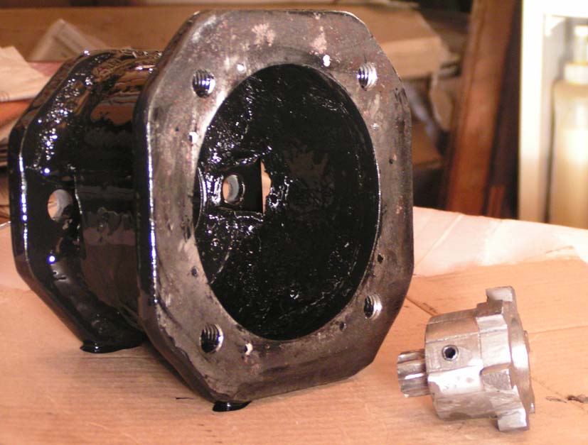

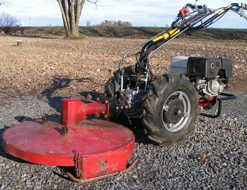

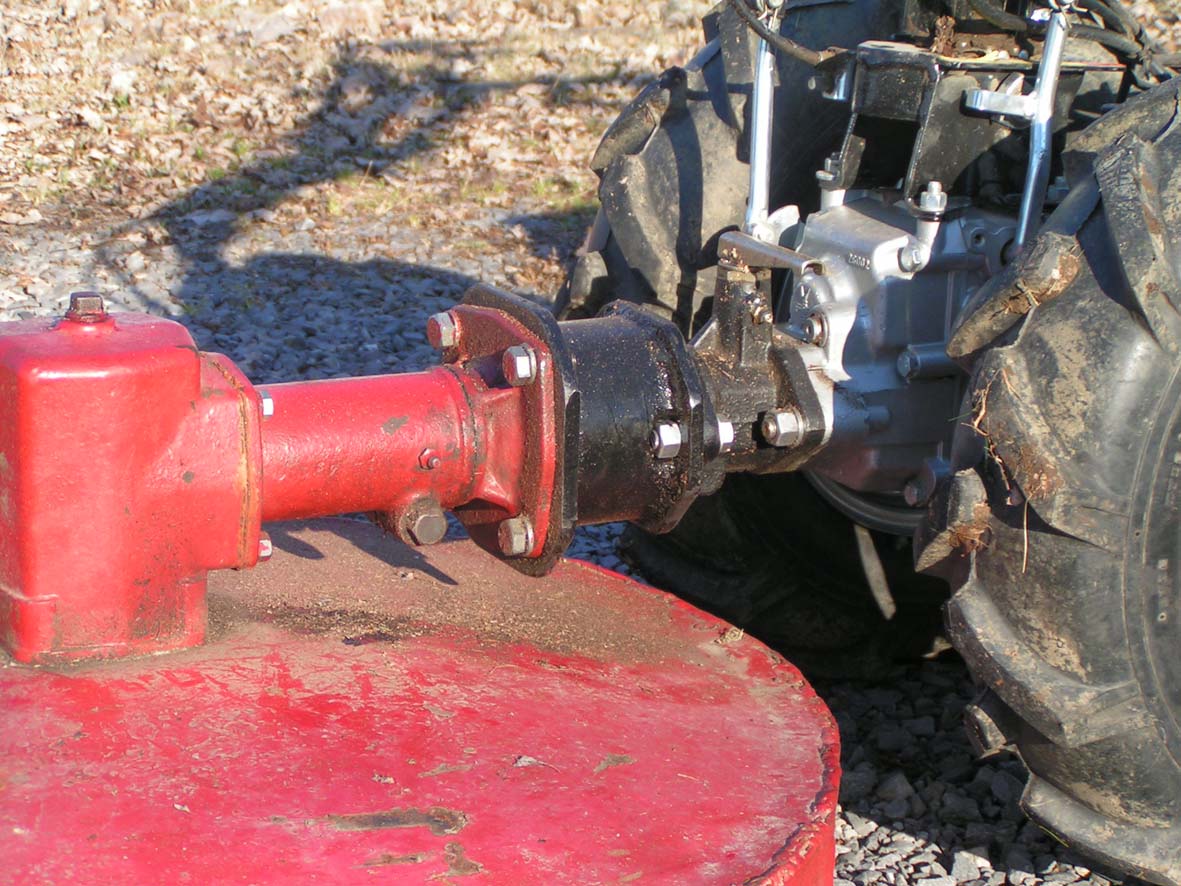

Hi! I make one adaptor for use my Gravely implements. Front PTO on GRILLO is SAME rotation as GRAVELY. I try this afternoon the 30 in. Gravely mower. Good balance. Easy to drive. Maybe I could remove 1.5 in on bottom of mower for better level I dont know. Later I could try my Gravely snowblower on my Grillo. Good luck! Oldmech

Congrats on the adaptor. It looks great. Are you gonna make a couple to sell? You could also put taller tires on the Grillo to make it more level.

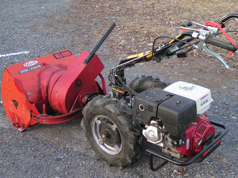

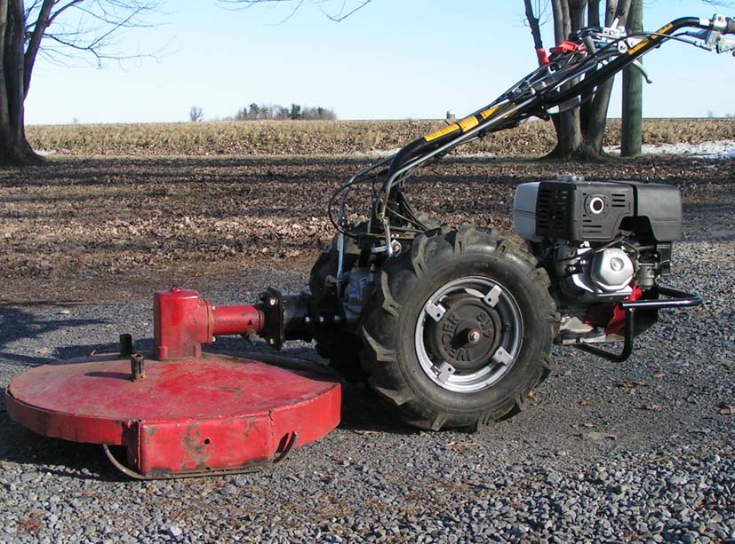

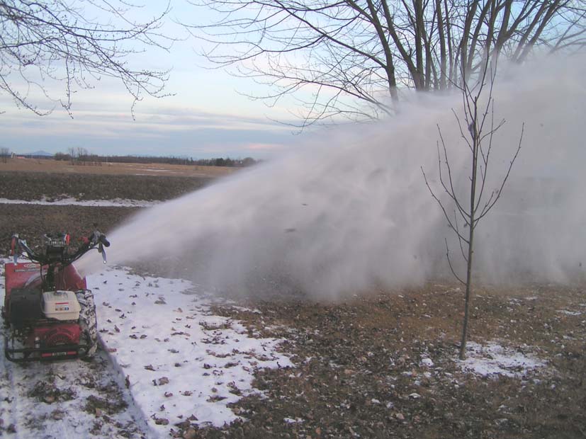

Hi! I adjust my 30 in. Gravely mower for good level I Just remove one inche. I try my Columbia-Gravely snowblower on my GRILLO 107d. I must Put counterweight (About 15 lbs) on engine side for better balance. I use also weight on my Gravely diesel engine because Gravely snowblower are very heavy. I am glad. I can use now my Gravely implements on my GRILLO 107d. All run very well. Mowers and snowblowers are very expensives . Gravely implements are very strongs and reliables . Good luck! Oldmech

Good job oldmech,, looks like it works very well. What size tires do you have on the Grillo? Might think about putting the caster wheels on the blower, with them on you just steer no need to manhandle the blower and add counterbalance weight, it will also help keep the blower down in hard snow. Very nice now all us Gravely guys can get a modern 2 wheeler at a reasonable cost and gradually update the attachments instead of having to do it all at once.

Hi All! Tires size on my Grillo is 5-10 With 5-12 center pto height will be near the same as Gravely. We can order Grillo with 5-12 Too late for me.
