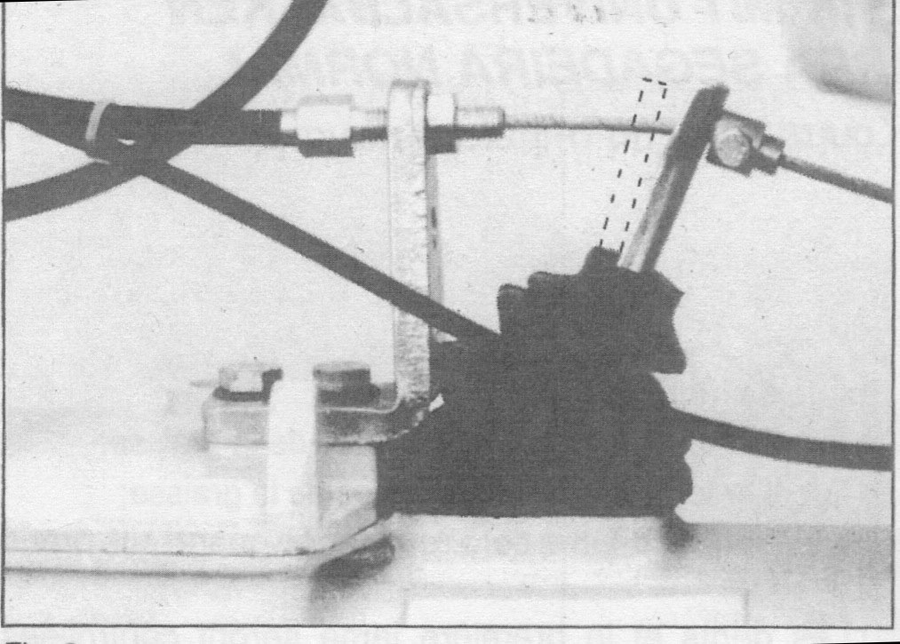

On my Grillo G85D, I've been encountering an issue with the OPC lever. Does anyone else have an issue with these when you squeeze the clutch trigger into the locked position the OPC switch will not catch properly (on the clutch trigger), and it retracts far enough to kill the engine (or prevent it from starting)? It has been happening to me rather frequently lately, and was wondering if there is some sort of adjustment I can make to prevent this. This is my third season of use with the tractor, and it's an issue that I've not encountered until a few weeks ago...

Hi! First try to adjust clutch cable Very important you must to have 1/8-1/4 in. play. MAY BE this could correct your trouble.I add a pict.Good luck! Oldmech clutch.jpg
