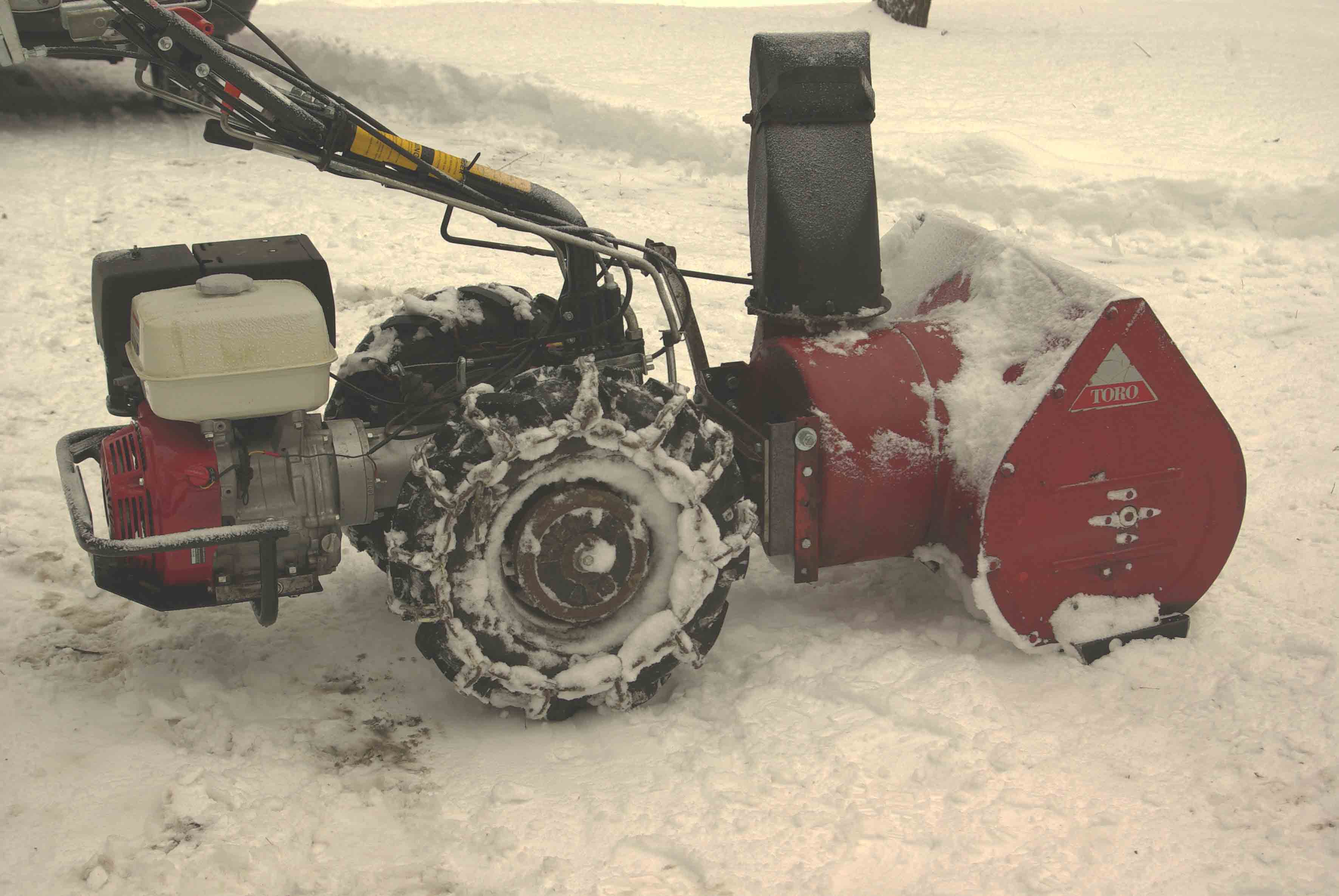

Hi! I own a Grillo 107d for now more five years. The 5-10 tire are ok for the most use. 5-12 add some height more clearance but add speed no always a good thing. I think 5-10 are a good choice . Except may be (I dont have) for rotary plow. For winter I add tire chains for snowblowing.

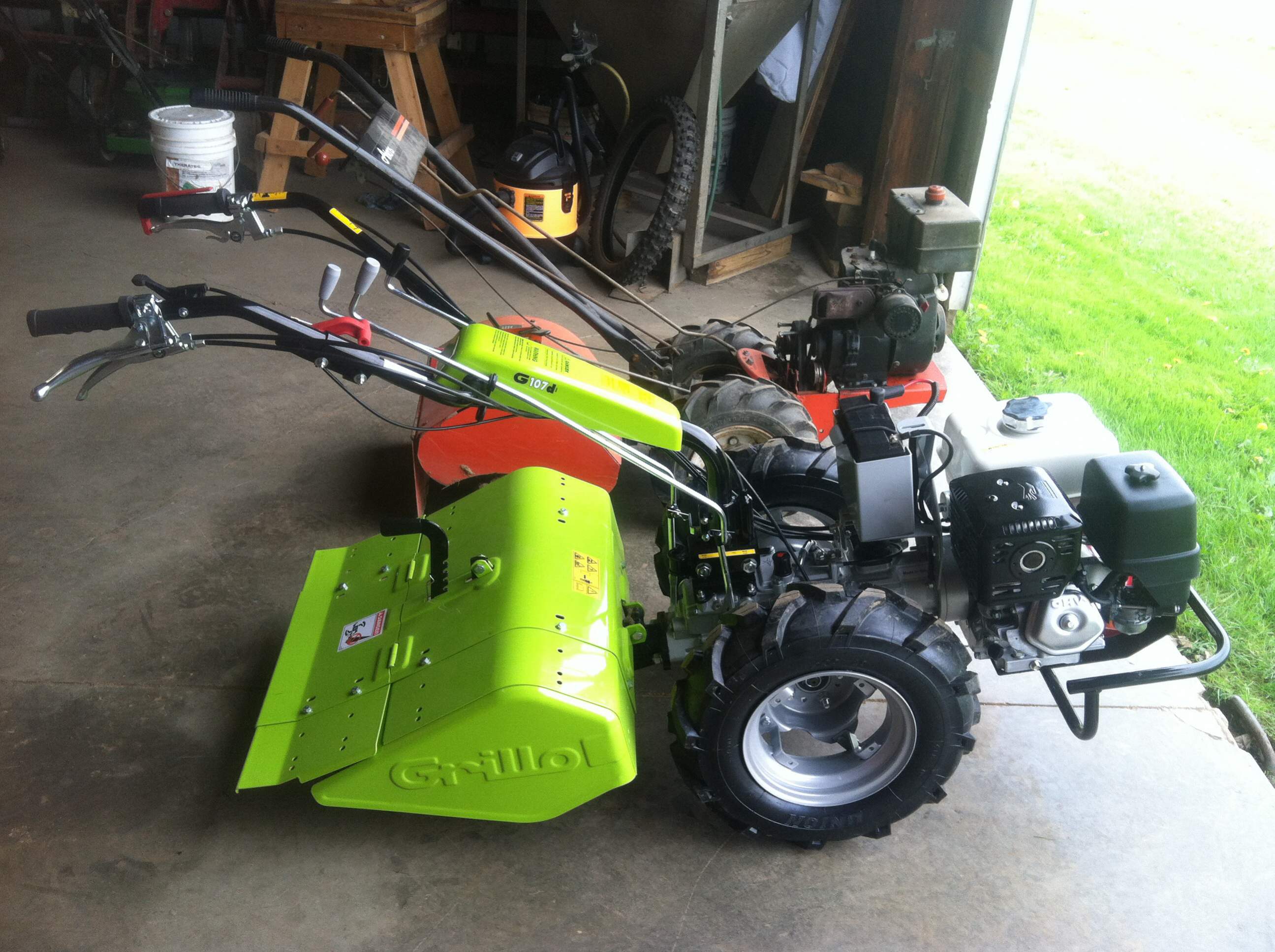

I also like the 5-10 setup. I used my 107d to push heavy carts and have never had clearance issues.
Congrats on your purchase!
I thought I would upload a photo too...

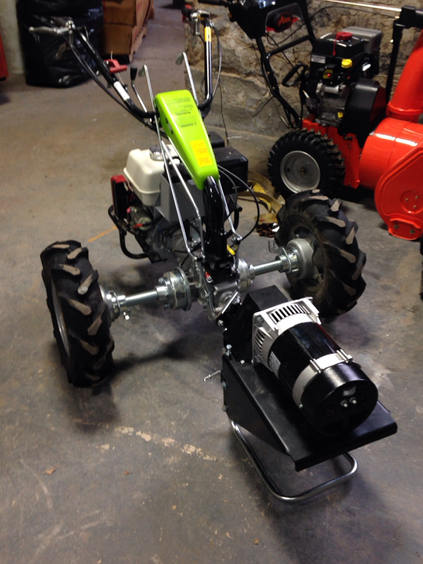

Timber, how do you like those axle extensions and the generator?
Bill, have you sold any of the zanon 33" mowers? Is it a nice route to take or better just getting a dedicated mower?
/ Grillo g107d tire size #11
I like the generator. It's greatest feature is portability. There is something wonderful about not having to drag out a full sized genset. But the tank is small. I get an hour and a half of run time. I started to look into larger tanks, but can't find anything.
The wheel extensions are excellent for balance, that's why we bought them. But the also make the tractor turn slower when one wheel is stopped via the brake. This is a huge plus in my opinion. In third gear the "turn on a dime" move can get away from you, it's manageable with the extensions. We didn't account for how wide the tires remain in the shortest position. It looks like they need to be removed before installing the snowblower.
