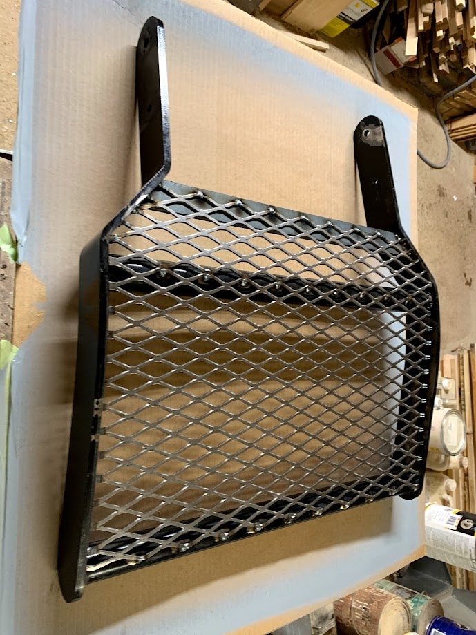

I had a friend that can weld get some stretched metal for me, I painted it myself.

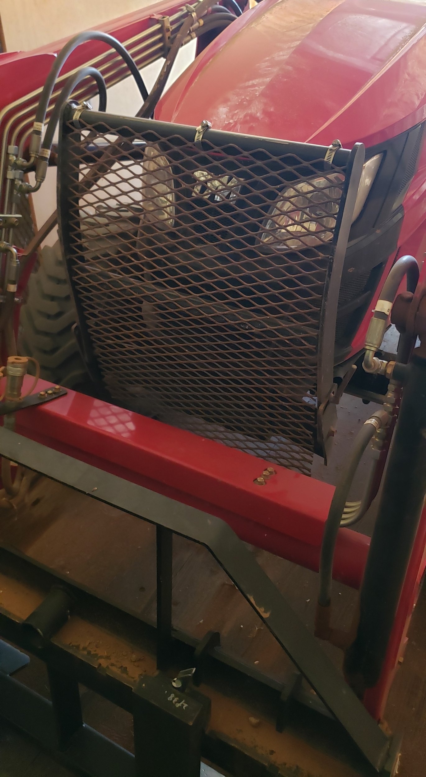

Anyone know where to find a decent grill guard for the TYM T474? I found a place selling grill guards, but unfortunately not for the TYM models. The guys says maybe in the future, but not likely in the NEAR future. I would rather buy one before getting damage, rather than afterwards.
I used the same expanded metal sheet for my TYM394 grill guard. Instead of welding, I just used hose clamps on the top and bottom. Does the job and I can easily remove in the future if needed for any reason (although I honestly cannot see why it would need to be removed). My grill guard is pounded and deformed from use. Definitely a "must-have" living in very rocky terrain where I pretty much dug up my entire yard, screened out the rocks, and put all the clean dirt back.
I call that "work" to my wife, when in reality that was just plain ole fun to shift all that soil...

It isn't difficult to weld expanded metal onto a grill guard if that's something that interests any of you or you have trouble finding a welding shop to do it for you.
Take the factory grill guard off and lay it on a table or something so you are working at a comfortable height. Grind off the paint where you'll be welding so the weld will stick. Then clamp the expanded metal onto the guard using a big enough piece of expanded metal to cover all of the guard. Don't try to cut it exactly to size. let some expanded metal hang over the edges of the guard so you don't run short of metal as you weld it up. Tack weld the expanded metal onto the guard. Remove clamps. Cut off any excess expanded metal and paint. This job could probably be done with one of the small Yeswelders from Amazon that sell for under $130. Then you will have a welder to use later for other small projects if you don't already have one.
