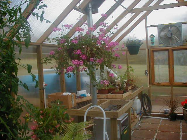

Tony, was this one of the tube type radiant heaters that runs on propane? Do you know the type I am speaking of? They usually hang between the gable ends.
/ Greenhouse
#51
No, Ken, it wasn't that type. I often wonder how one of those would work for me. It might do a better job than what I have.
Mine is a floor mounted model made for greenhouses. I don't know what type it is but I have attached a photo that shows it (partially). It is stainless steel with a green front panel in the bottom middle of the photo.
