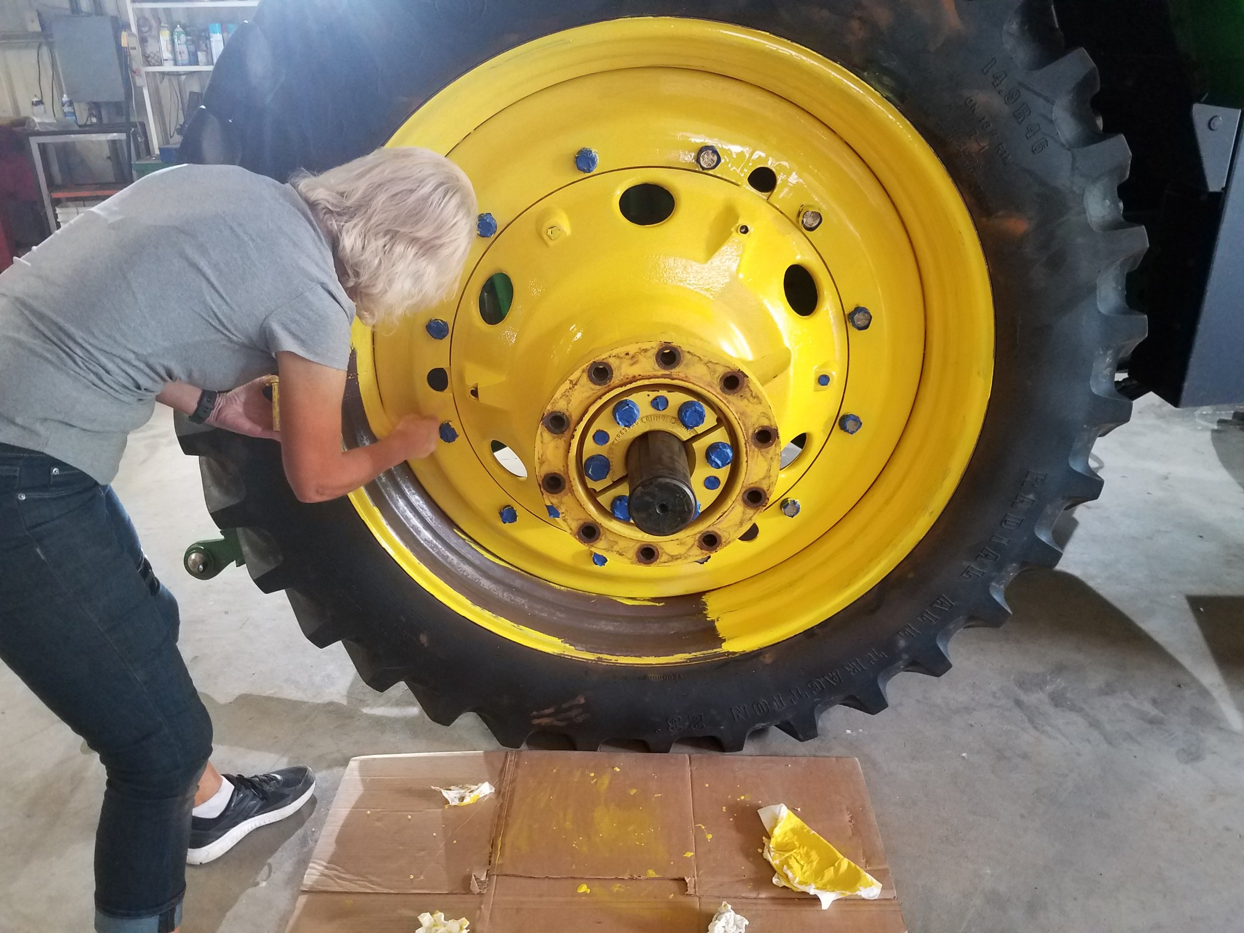

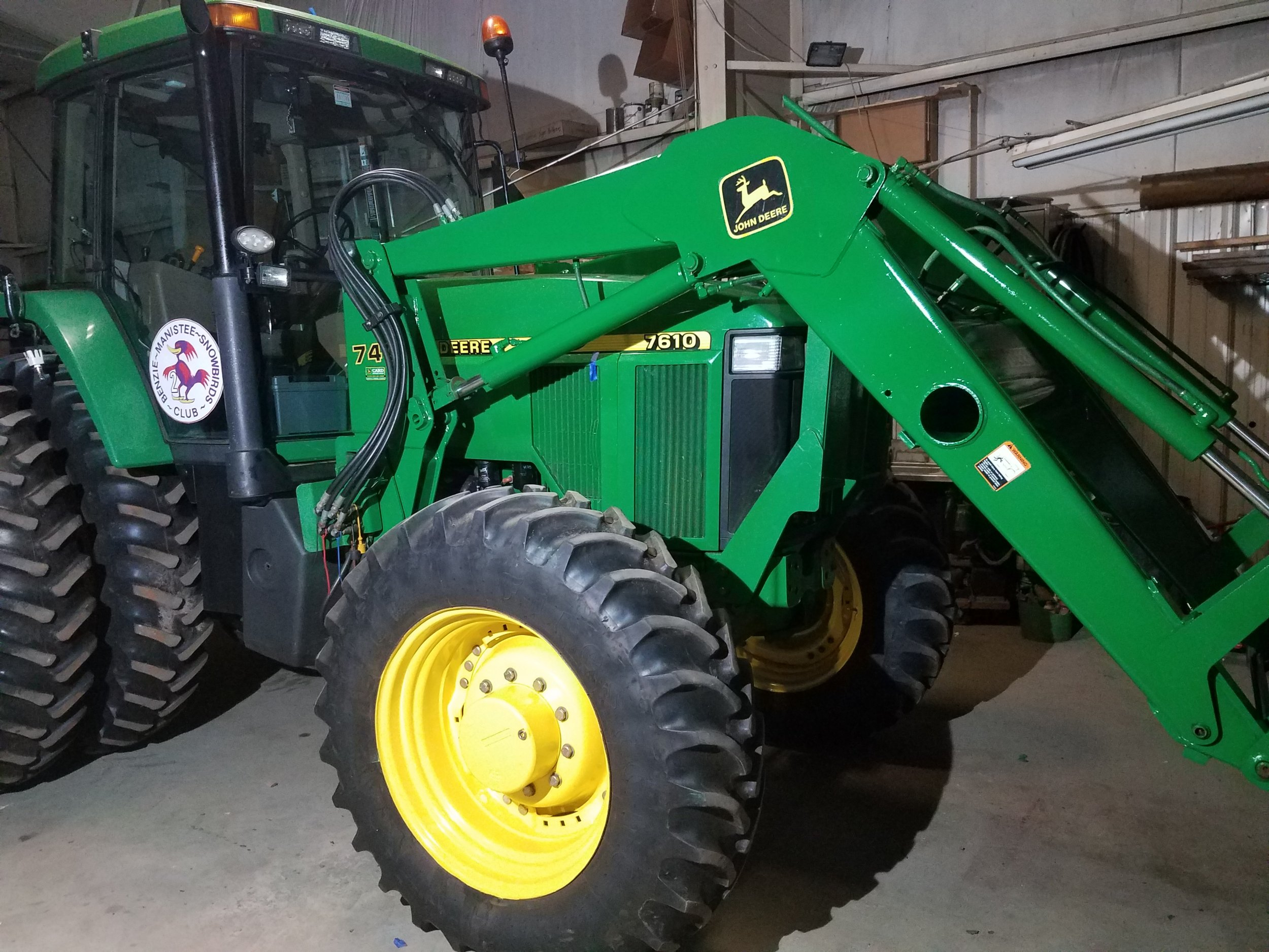

Mostly green

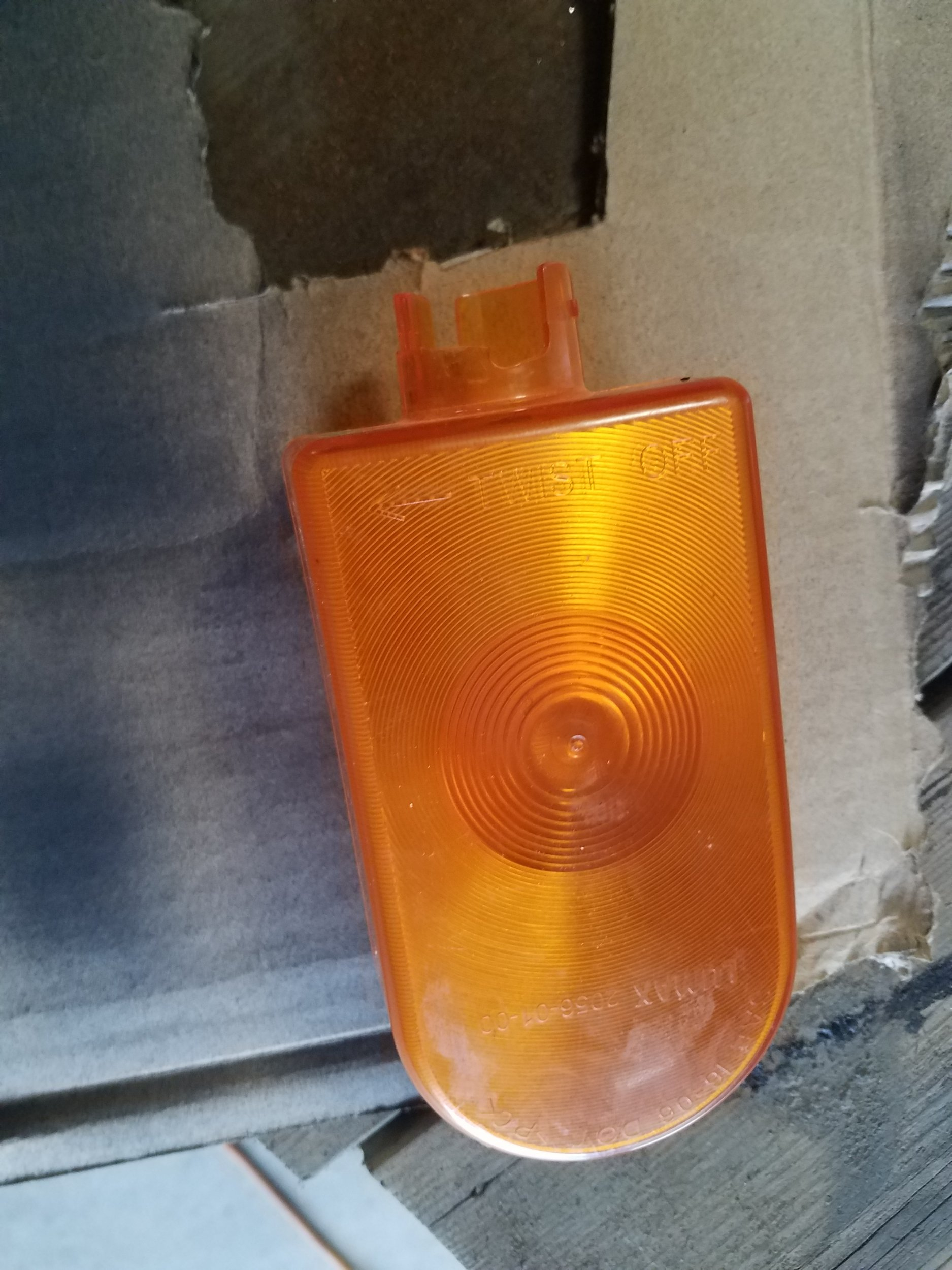

I thought I had pics of the overall and will get a couple later. Rusted wheels was the main thing it came in for. Got some other things, anyone know where to score the amber light?

I should have said green tractor, yellow paint.

Tractor mfgrs sometimes use some lights made for after market on road use. Look at lens for for Dot approval and mfgr's part # to see if Napa can order it for you.
   / Green paint #4
Is it worth chasing around a substitute for a customer's tractor? (assuming it's an OEM light)
   / Green paint
We did take it to auto parts, havnt heard back, she might have found one today.

I just switched to Valspar Armor from using Rustoleum. At Lowe’s, they can mix any color you want. Sells by the gallon. The base is clear and I buy it separate to use as as a protective coat on top of the color. Before I spray it, I mix in a capful of Japan Dryer into the paint(quart). It acts as a catalyst and makes the paint dry hard and shiny.
edit: not sure how long it will last in the weather, just started using it this year.
