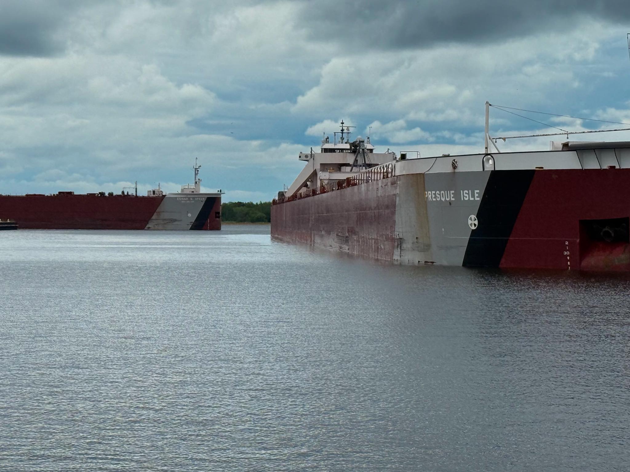

The Edgar B Speer pulls up to the Calumet fuel dock while passing her Great Lakes Fleet mate, the Presque Isle, Duluth MN. Two 1000 footers once again parked adjacent to each other.

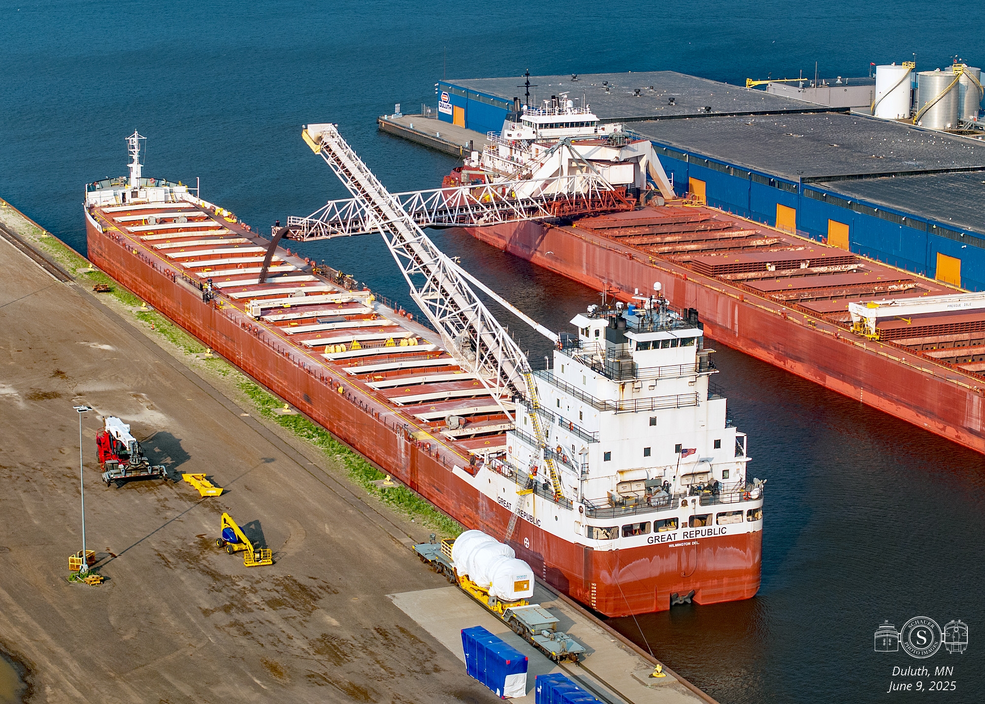

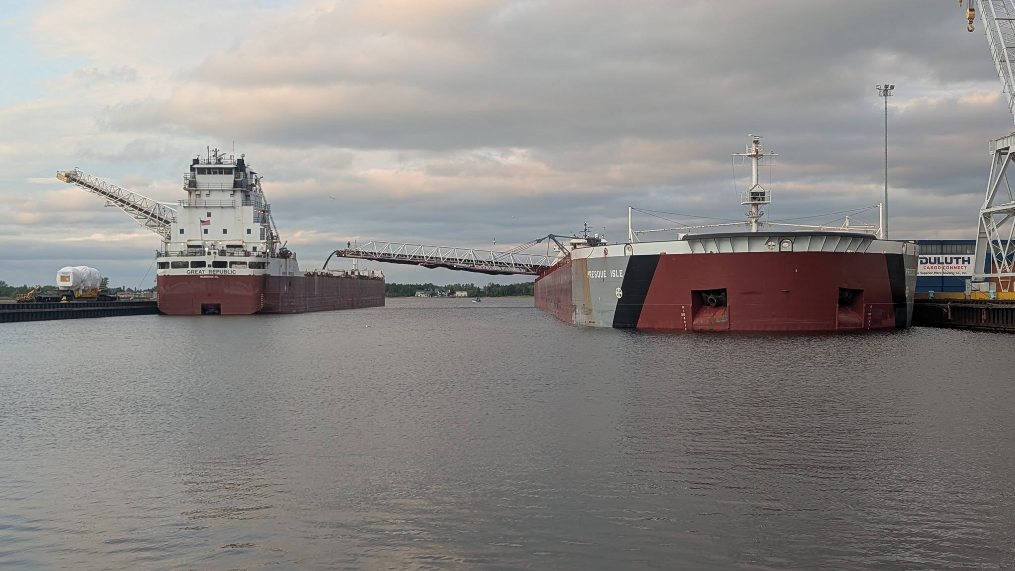

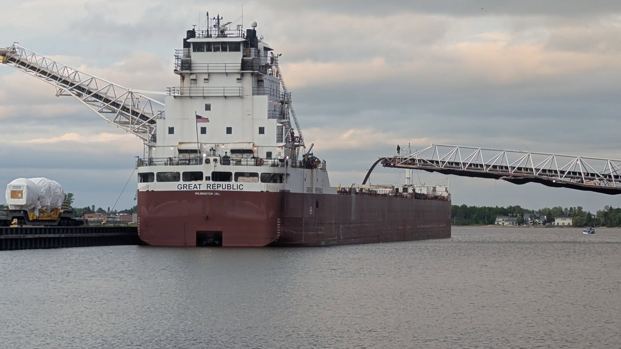

All I've read is.-----------------------------
Nice early evening light illuminates the pellet transfer from the Presque Isle to the Great Republic. The Presque Isle has an unspecified issue that they need to get at by raising it higher out of the water. This is coming on the heels of the pellet transfer between the American Integrity and American Century about a week ago. The odds of two lightering operations at the port within a week, or even a year, is rare. Duluth, MN - June 9, 2025
   / Great lake boats, a good video #2,476
Any word on the reason for the transfer?
I assume Presque Isle is having a mechanical problem.
Vibe with Mike has an excellent YT Video om them (Fraser Shipyard) working on the boat, they have the bow ballast tanks mostly flooded to raise the stern out of the water, exposing the rudder, which they are working on... Stands to reason in as much as she almost hit the retaining wall a couple days prior. It was noted they were having a steerage issue
When I worked as a Longshoreman at GW Industries, that is how we worked on and installed new bow thrusters, we flooded the aft tanks which raised the bow and so we coud cut through the hull plates and install bow thrusters.
All large vessels have segmented bilge tanks, used for stability and keeping the vessel level. Salties have more advanced bilge tanks but same principle.
