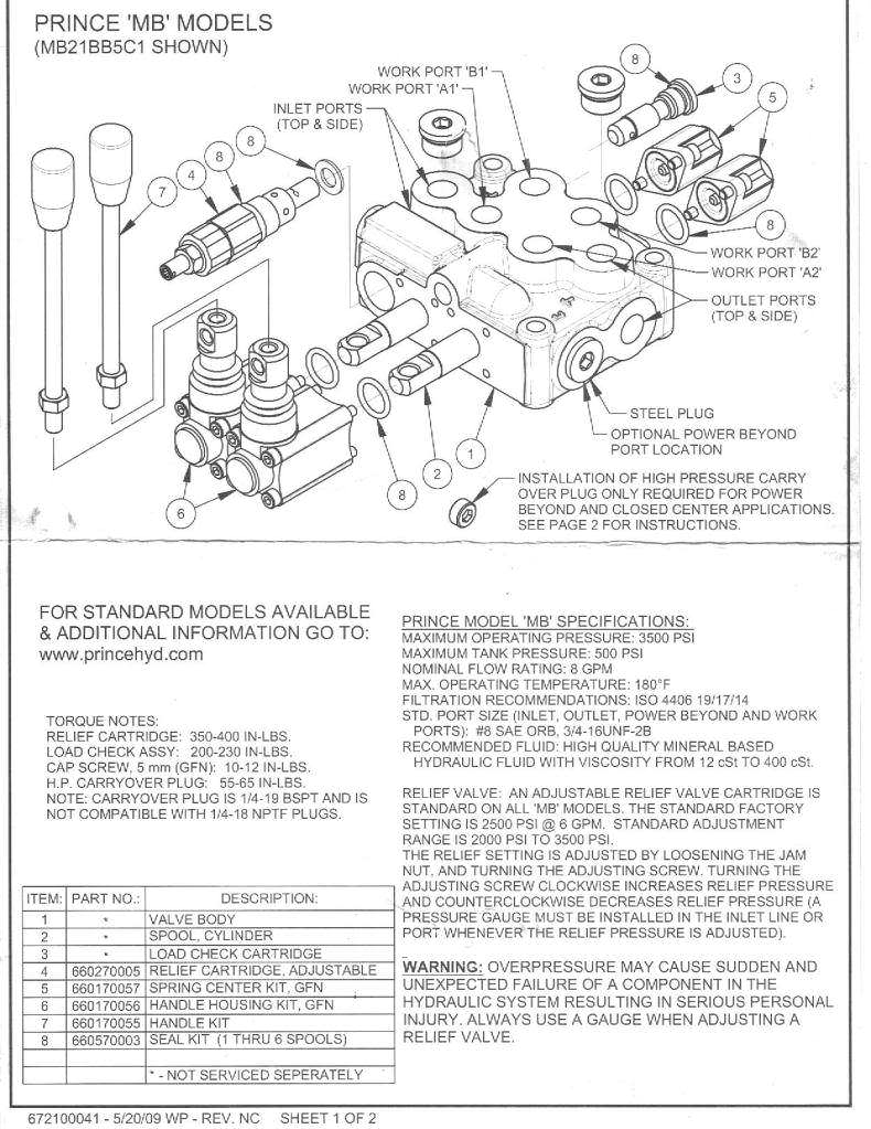

/ Great Bend 652 spooler Valve issue #4
I am not familiar with your exact valves, but there should be caps on each end of each individual valve in the stack. On one end the valve spool sticks out and connects to the cable or lever that controls the valve. On the other end there is usually springs under the cap to center the valve. There should be o-rings or seal packing around the spool on each end. They may be in a groove in the body and you might have to pull the spool out to get to them. The o-rings seal any oil that gets by the spool to bore clearance. If valves are leaking on either end then you probably blew out these o-rings.
See item 8 in the attached diagram.

/ Great Bend 652 spooler Valve issue #5
here is another picture...
The rest of the spool is designed, by tolerance, to allow a small amount of leakage, between the highly pressurized cores and the low pressure cores....just enough to lube the spool and secure spool from not binding....
this is a typical rating for spool leakage...
btw....3 c/c is about 0.18 cui.....thats the normal leakage per minute between to cores at a pressure difference of 1500psi....you cant even see a 3" bore cylinder drift from that low leakage....unless you watch it for 10+minutes...
