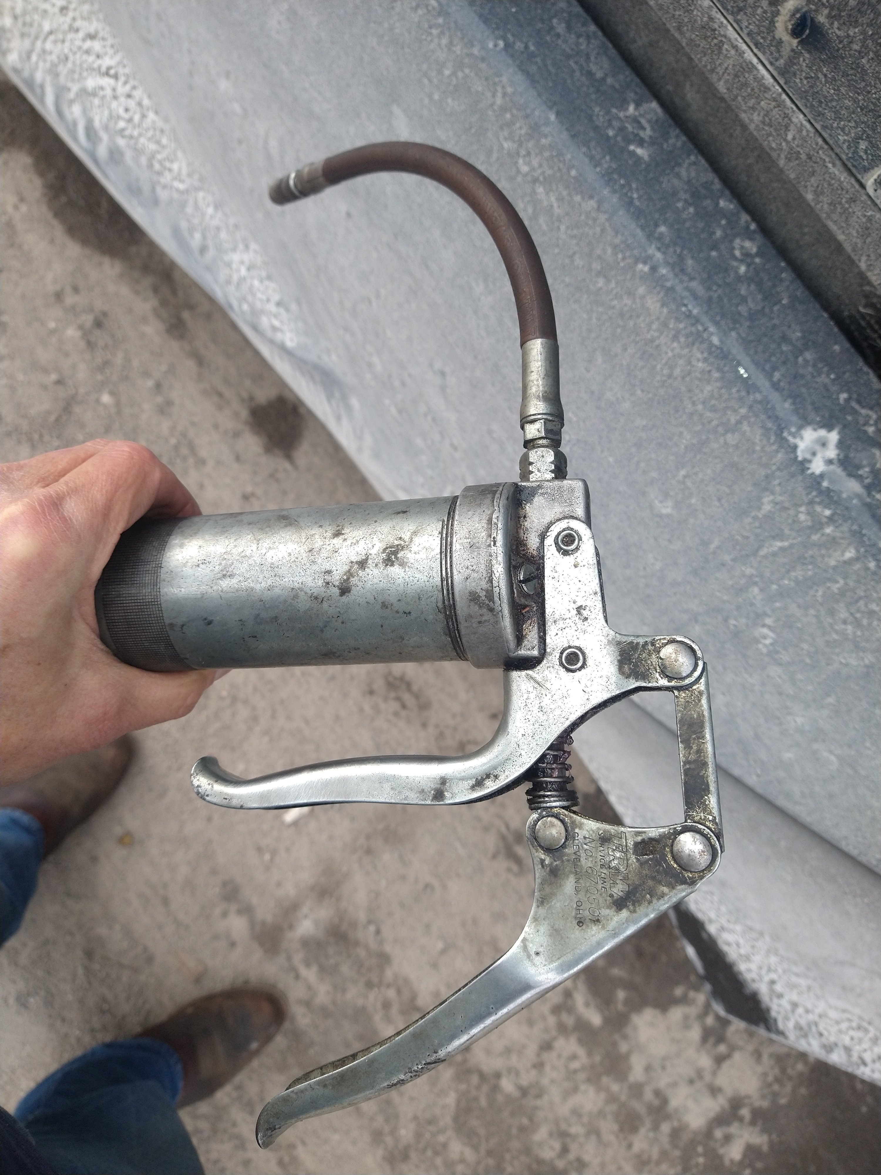

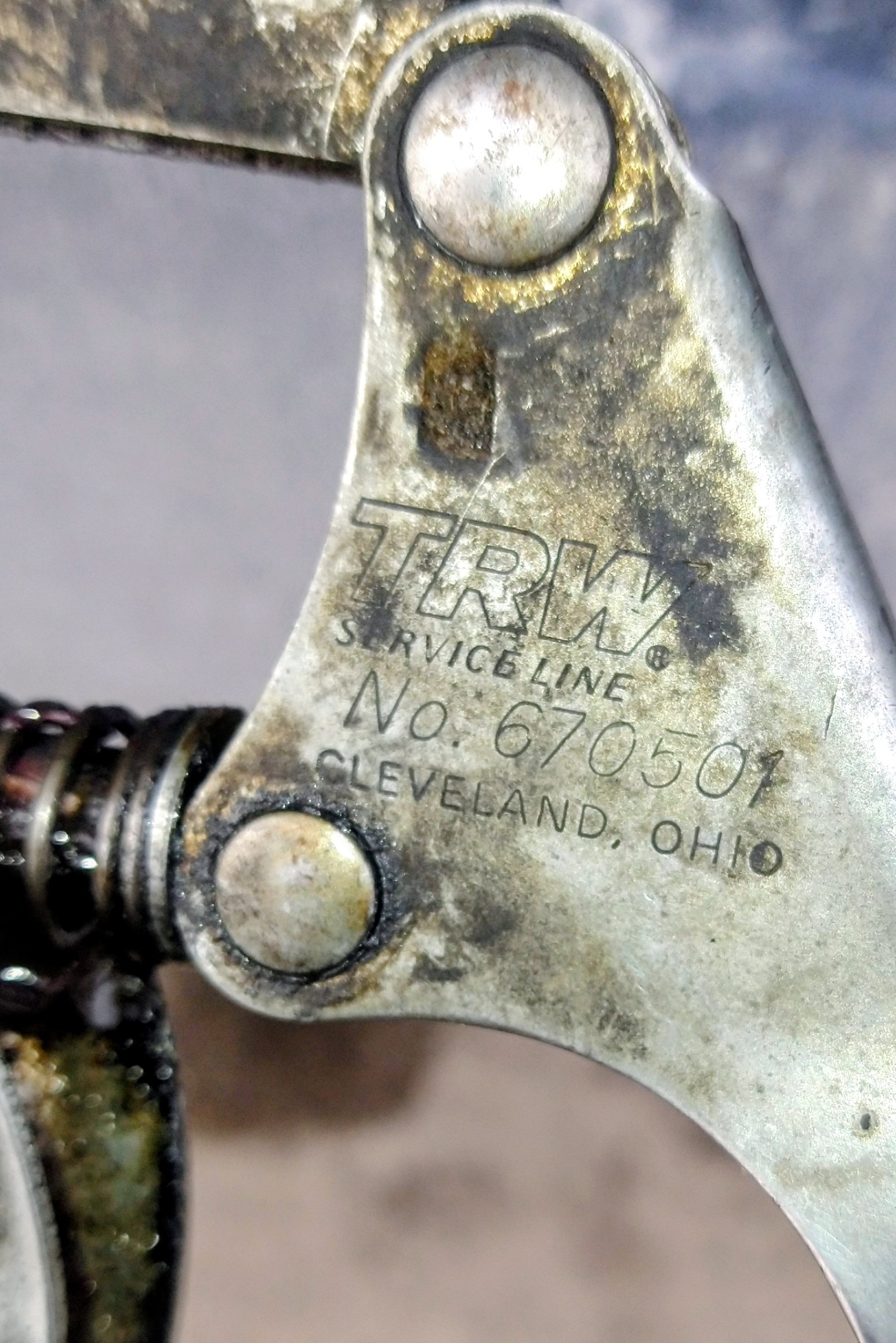

This is what I carry in my side box of my semi-truck, has a few million miles on it!
Bought it over 40 years ago ... I don't use the bleed screw on this, or the button on my M12 Milwaukee to purge the air, I just don't screw the tube in all the way, then pump or squeeze the trigger until it's happy!
I actually prefer the manual over the electric ...
I have a couple of pistol grip guns too, but with a longer hose. I used to have a lever action gun, but I like the pistol grip much better!
