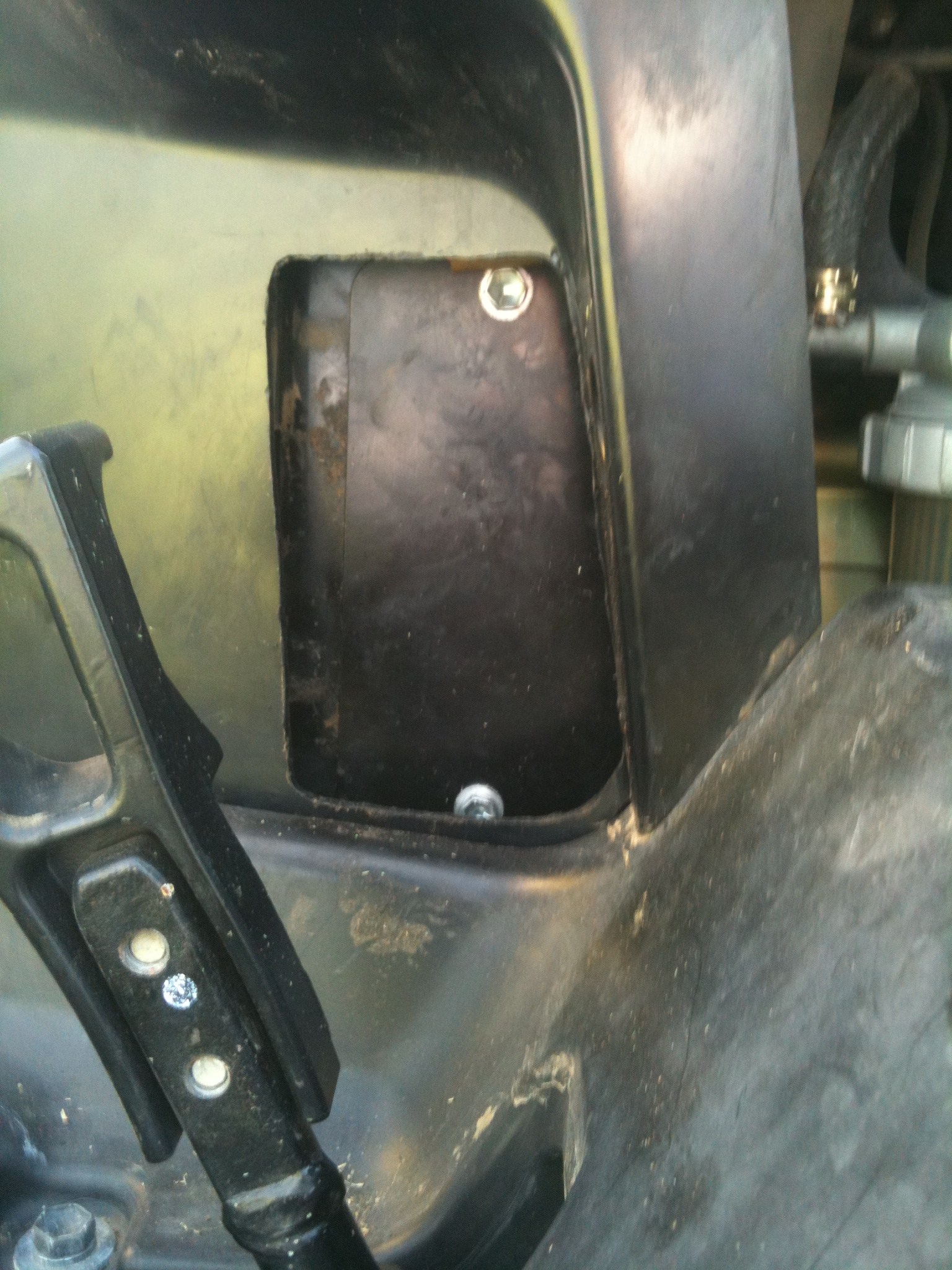

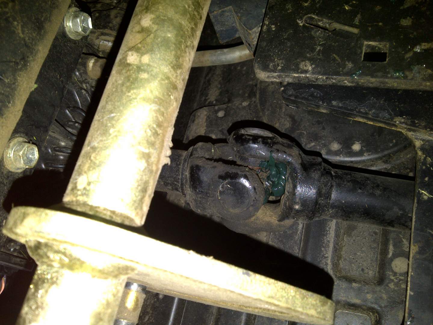

This is the easiest way I have found to grease the dreaded 2320 driveshaft that connects the engine to the transmission.
After removing 8 or 10 screws and loosening the throttle bolt, I am able to seperate the top and botton dash components enough that I can move the lower panel out of the way and expose/remove the service hatch on the right hand side. Using a wrench to turn the crank, I was able to get the grease gun onto that nipple. The rear U-Joint is accessible from underneath the tractor.
Anyone found an easier way?

Plunge, Thanks for posting the pictures and the method you used to grease the u-joint. I purchased a 2320 in December of 2011 and have wanted to check out your method. Yesterday was a nice day so I gained access to and remove the cover plate. I found I could get a grease gun on the zerk using a rubber hose extension. It worked great!

Hope the grease is in the joint as it looks like it is around the joint. ;)
Appears to be a lot of work to get at that joint so hope all will be fine.
/ Greasing 2320 driveshaft
Yeah :) -- first try made a mess, second try got grease in there.

Well I greased that shaft this past weekend. Here is my observations.
Rear u joint: It is accessible from underneath. You can rotate the shaft by grasping the harmonic balancer at the back of the engine.(turns stiffly but it does turn). Once the drive shaft was lines up so I could see the nipple, I just had to adjust the nipple a bit in the u-joint cross so it would allow the grease gun on. I used a pry bar to line this up. Make sure the grease come out of the four caps. Mine was 268hrs and supper dry.
Front joint: NO NEED TO DRILL ANYTHING(really guys it's a Deere, no hill billy stuff PLEASE!). Remove the throttle level, one bolt, than two more bolt on either side of the upper dash, now its as loose as it needs to be. Remove the 6 or so bolts that hold the lower dash, remove the two cotter pins that hold the cruise control and park brake levers. Voila the lower dash comes right out! Now you can see the famous side access panel, remove it. now you can see the drive shaft again. You can access from the panel if you so choose or go from the center of the floor board(I found this easier). I bet things would be smoother with needle a adapter for the grease gun, I didn't have one.
Extra thoughts: The first time will take an hour or so, but the second time can be done in 15 minutes. The worst part is actually getting the grease gun on the fitting as those u-joints are so small.
Good luck, (not as bad as it sounds but there is a lack of engineering!!)
