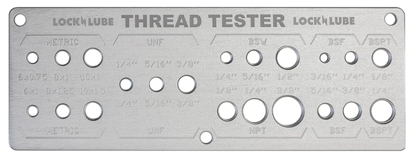

Front axle grease zerk needs replacing. Does anyone know what the size is?
I went to my local Napa store and they gave me a metric zerk (10 mm) it doesn’t work. I’m not sure if it’s SAE or Metric.

Been there...done that and it was a no-go. I had a zerk that came damaged from the factory on a 2538 backhoe cylindner. Had a pack of metrics and no good. Got a pack of SAE and no good. Huh ??? So now I measure it with a pitch gauge. The threading is 5/16 x 24 which is BSF. It is essentially unavailable except for 1 place which was zerksplus.com and your going to pay a lot more than its worth.

I picked up a tread tester and then bought what I needed for our 4540.

Drill and tap it to a more readily available conventional size or that's what Ive done with no problems. I also use a pinch of blue loctite when I install new sized fittings
