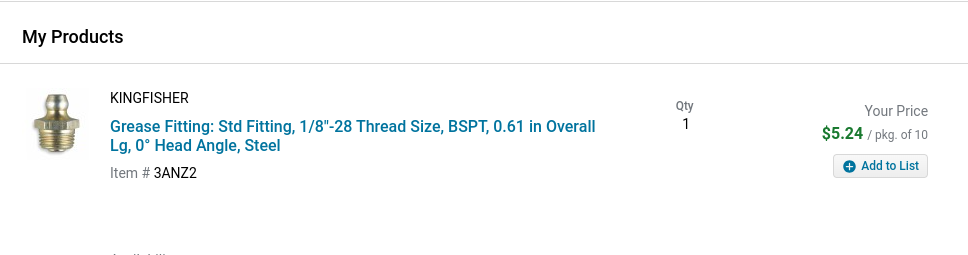

I have just about completed my 300 hour maintenance schedule on my 2022 Branson 2515H.
I have noticed a few grease fittings have damage on the BH150 attachment.
Would anyone know what the correct grease fitting size would be for the hydraulic pistons?
There are (10) straight and (2) 90 degree grease fittings on the BH150.
They appear to be brass and I am not sure if they are metric or SAE, though I was able to remove them with a 10mm socket.
Any help would kindly be appreciated.
Jim
   / grease fitting size for Branson BH150 hydraulics #2
1/8" BSPT (British Standard Pipe Taper). Not to be confused with BSPP (British Standard Pipe Parallel).
BSPT has tapered thread, while BSPP is parallel thread used in hydraulic fittings.
McMasterCarr has them.
Thank you very much for the information. I will note this in my maintenance journal and will place an order from McMaster Carr. have a great day!!!

   / grease fitting size for Branson BH150 hydraulics #5
I also found that Grainger Supply in my distant area (Austin), also have these grease fittings as well.
Thanks again for the reply. It helped me out big time. J
That's great! To be fair, I'm not from the US, I just remembered that Mcmaster Car pretty much sells any time of hardware and more. Really great source.
