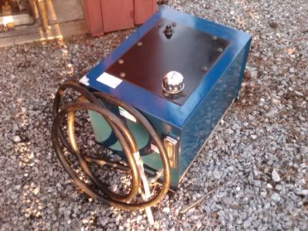

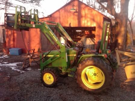

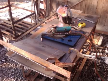

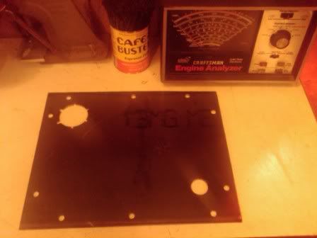

I needed a cheap/easy way to get fuel to my tractor, dozer, house, etc. and thought I'd fab something up. Don't want to pay any serious money for an electric pump, so I've tried to keep it simple.
Started with this thing that I bought at auction. I've stripped it of its hydraulic and electrical components for other projects, but I had a 30 gallon hydraulic reservoir left over....hmmm...:cool:....what to do?

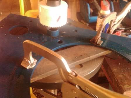

Only significant fab job was a replacement plate for the top of the reservoir. The old one had a 3-phase motor and provisions for a hydraulic filter, etc.
Old school oxy-acetylene. Angle iron as a guide piece for cutting and grinding:

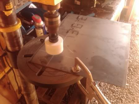

Drilling new holes....
Recycling the bung in case I ever want to add a 12v pump...nothing fancy about this fitting, other than cutting it out this way would make a nice flange for welding it to the new plate.
The finished plate.

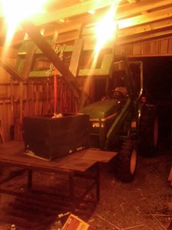

Moving the tank inside to do a little night welding. Tight fit.

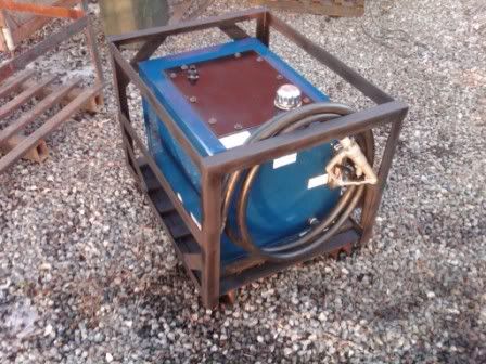

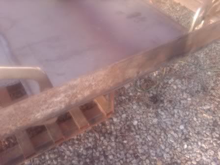

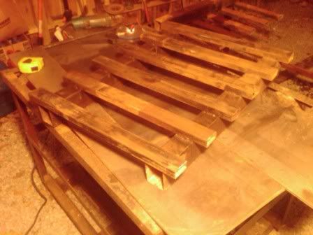

The skid, made from recycled pallets.

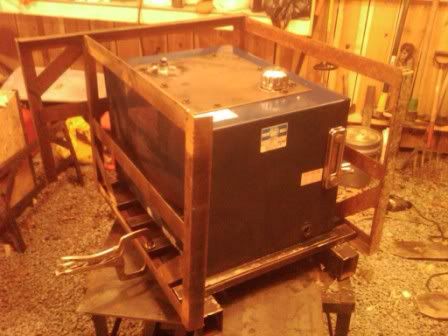

Mocking it up---all the steel is recycled from other projects, hence the crazy fit at this stage:
Coming together:
Voila:
Gulp!
:thumbsup:
Haven't tried it yet but I did fill the tank today...no leaks so far

Cool! Just make sure you don't run out of fuel in that tractor before you lift it up!:D:laughing:
   / Gravity Fuel Transfer Tank
Yep, I admit there's a fatal flaw....it'd be real hard to refuel if I was already out of gas....:eek:

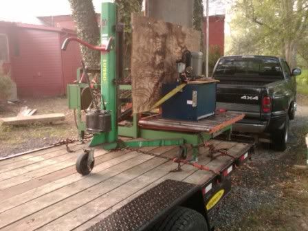

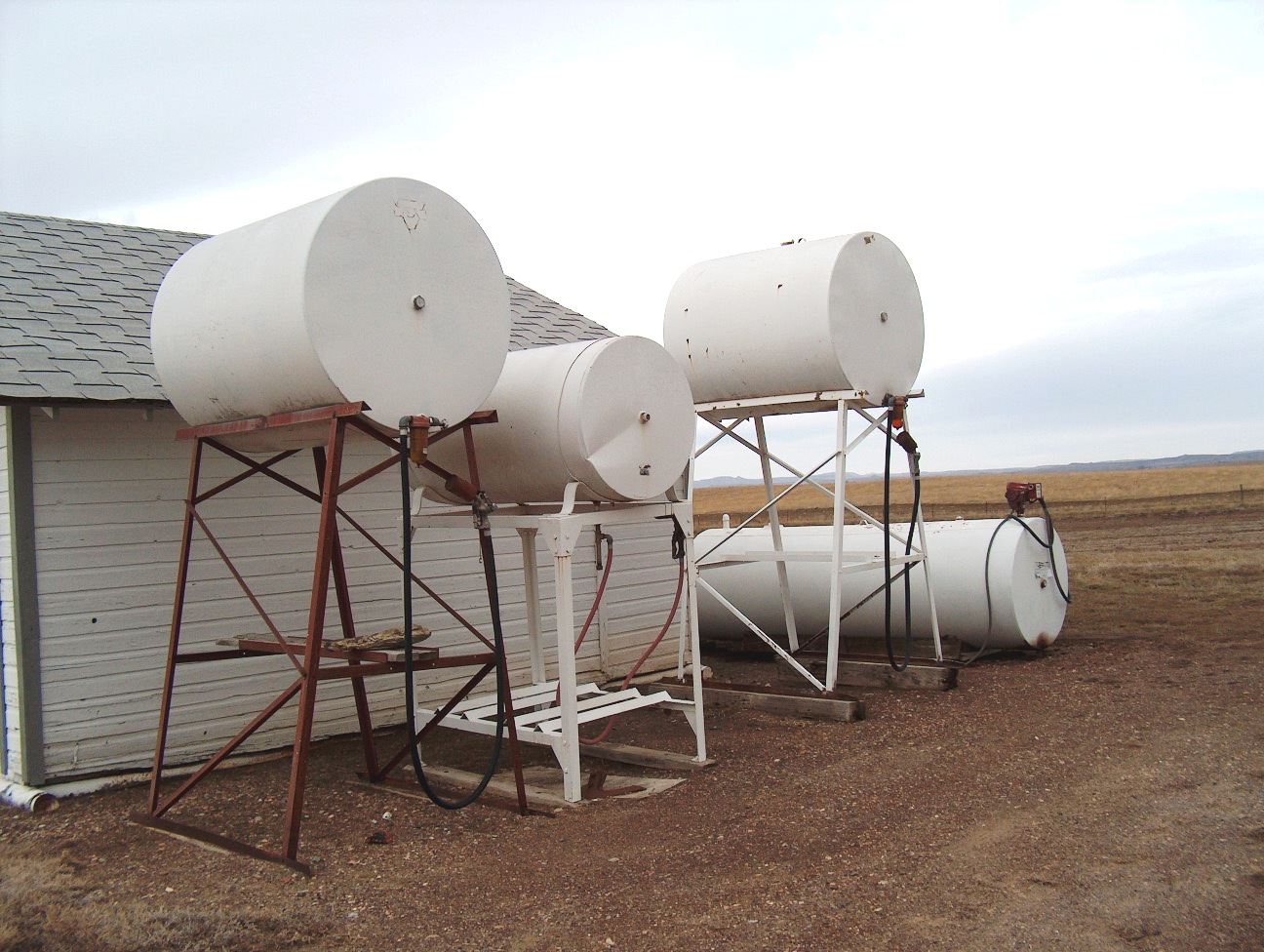

this is the type of gravity transfer system I use,
