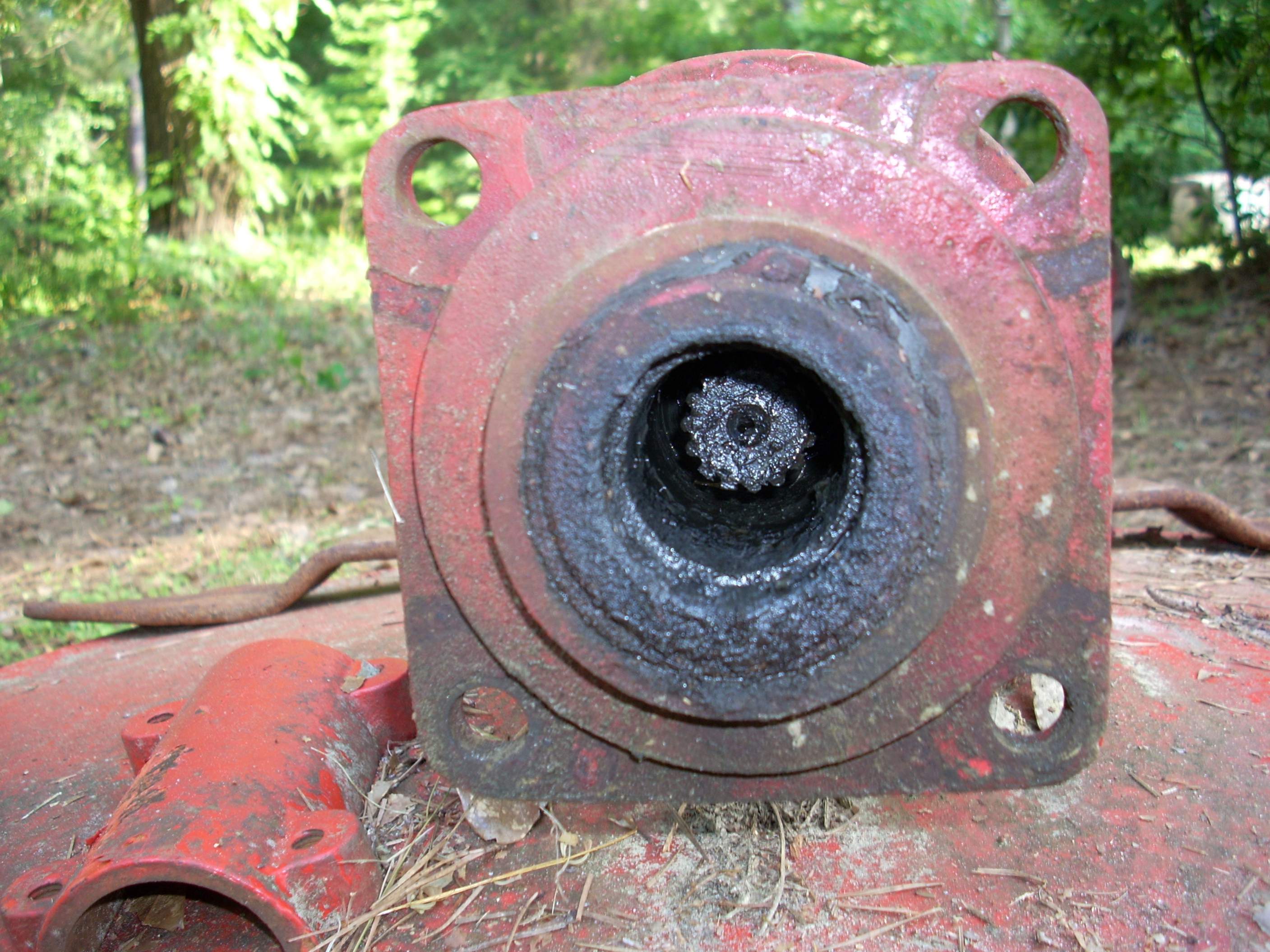

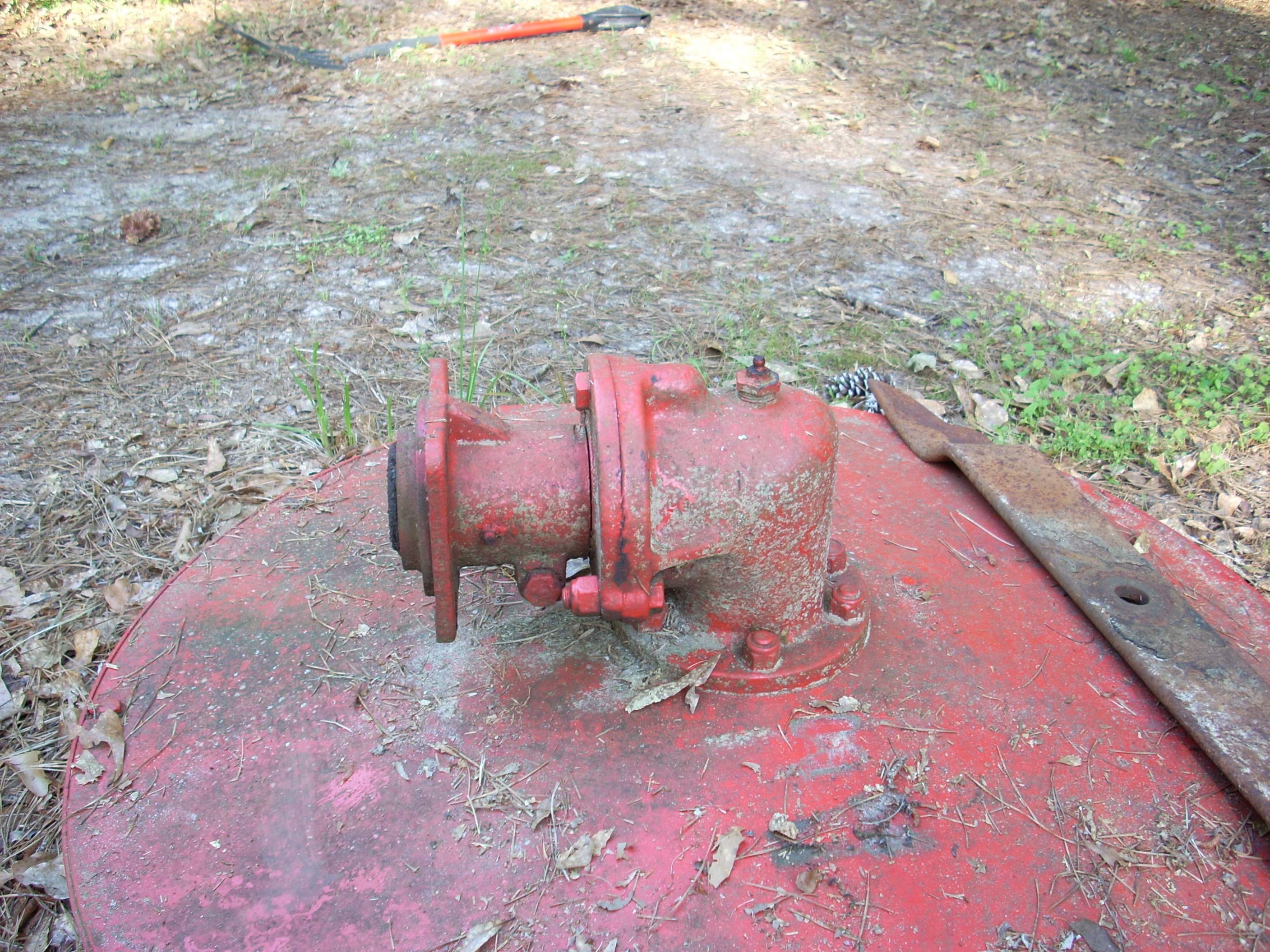

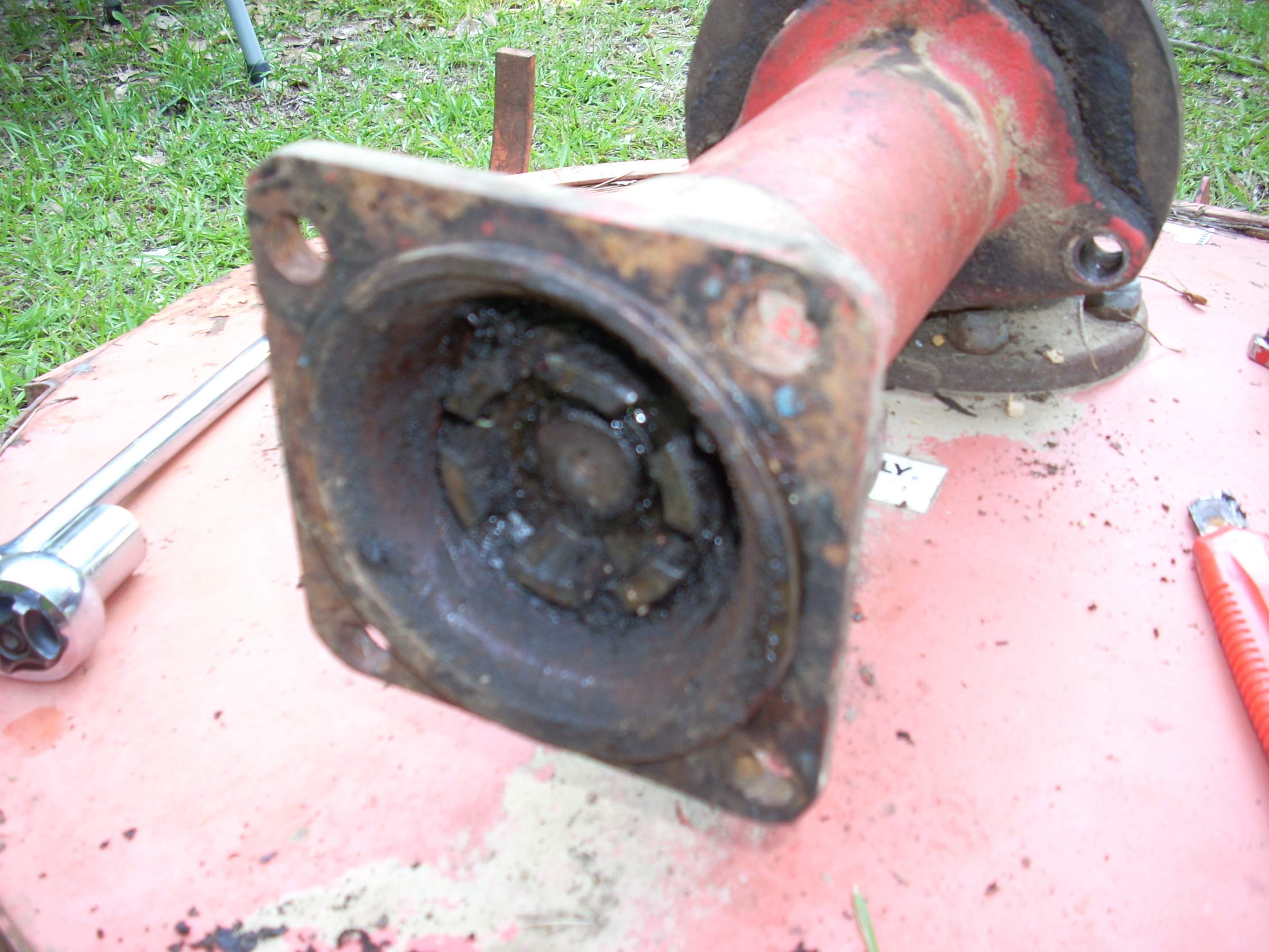

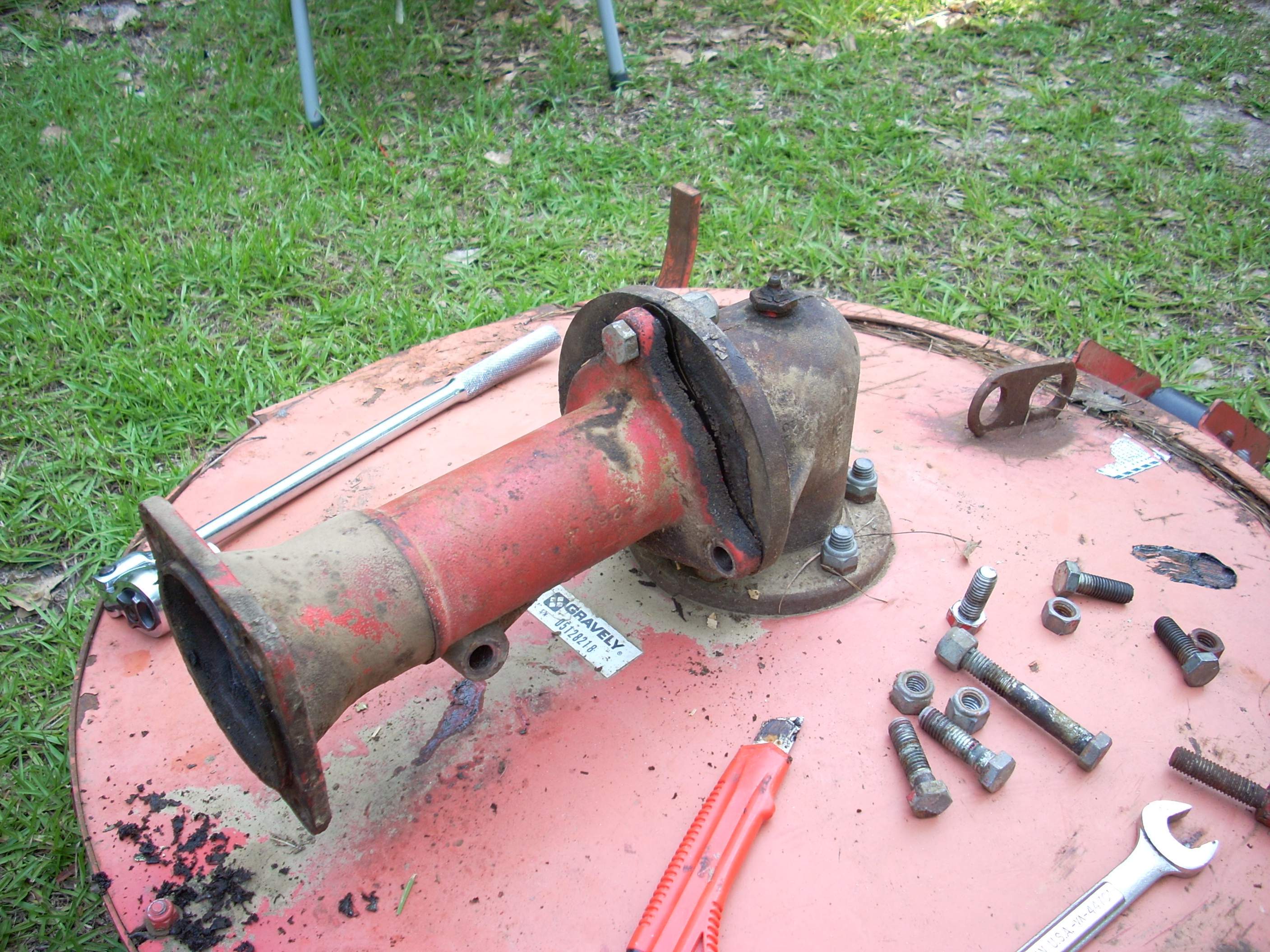

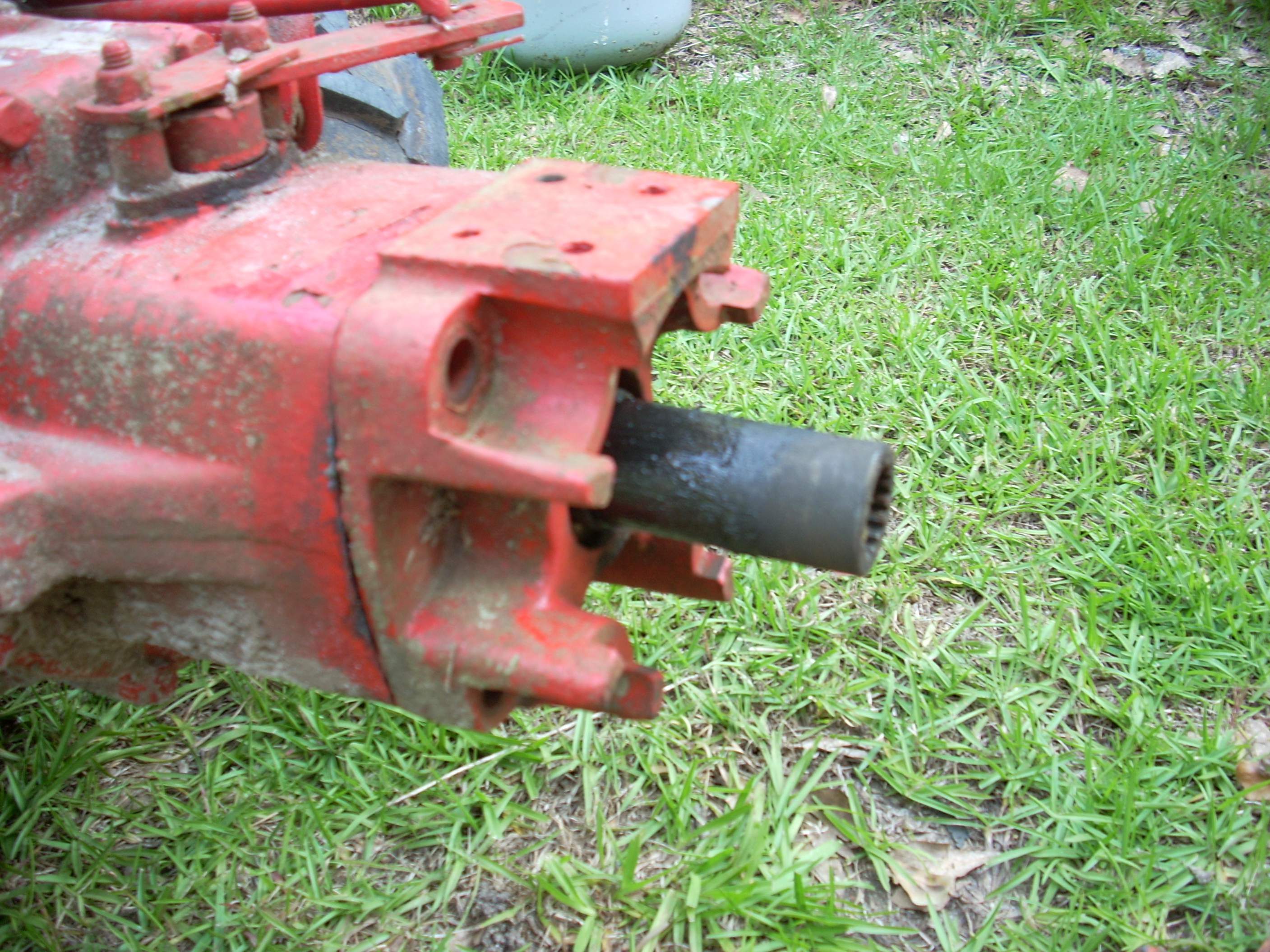

Not the quick disconnect . I have that for the short shaft. If you look you will see the spline shaft coupling for this. On the long shaft the PTO engages differently. Also doesn't connect direct. Tried that today. Pull PTO engagement lever but gear doesn't go out far enough to engage. Most be missing a piece or something.
Quick connect with spline coupler
Short shaft Mower
How the splined coupler connects to the tractor to the mower
Long shaft mower
Connection for Long Shaft Mower - as you can see it does't work with quick connection. Also doesn't work with quick connector removed from tractor. I must be missing a piece
/ Gravely 30 inch Mower Deck confusion
Ok I think I figured it out. It is a new style deck. What I am missing is the Attachment Dog. That would go in place of the tube with splines in it. One end looks to be splined and the other end has 6 lugs that engage the six slots that are on the end of the mower main shaft you see in the bottom picture. Now to see if Richards has one or if I can find a used one.
