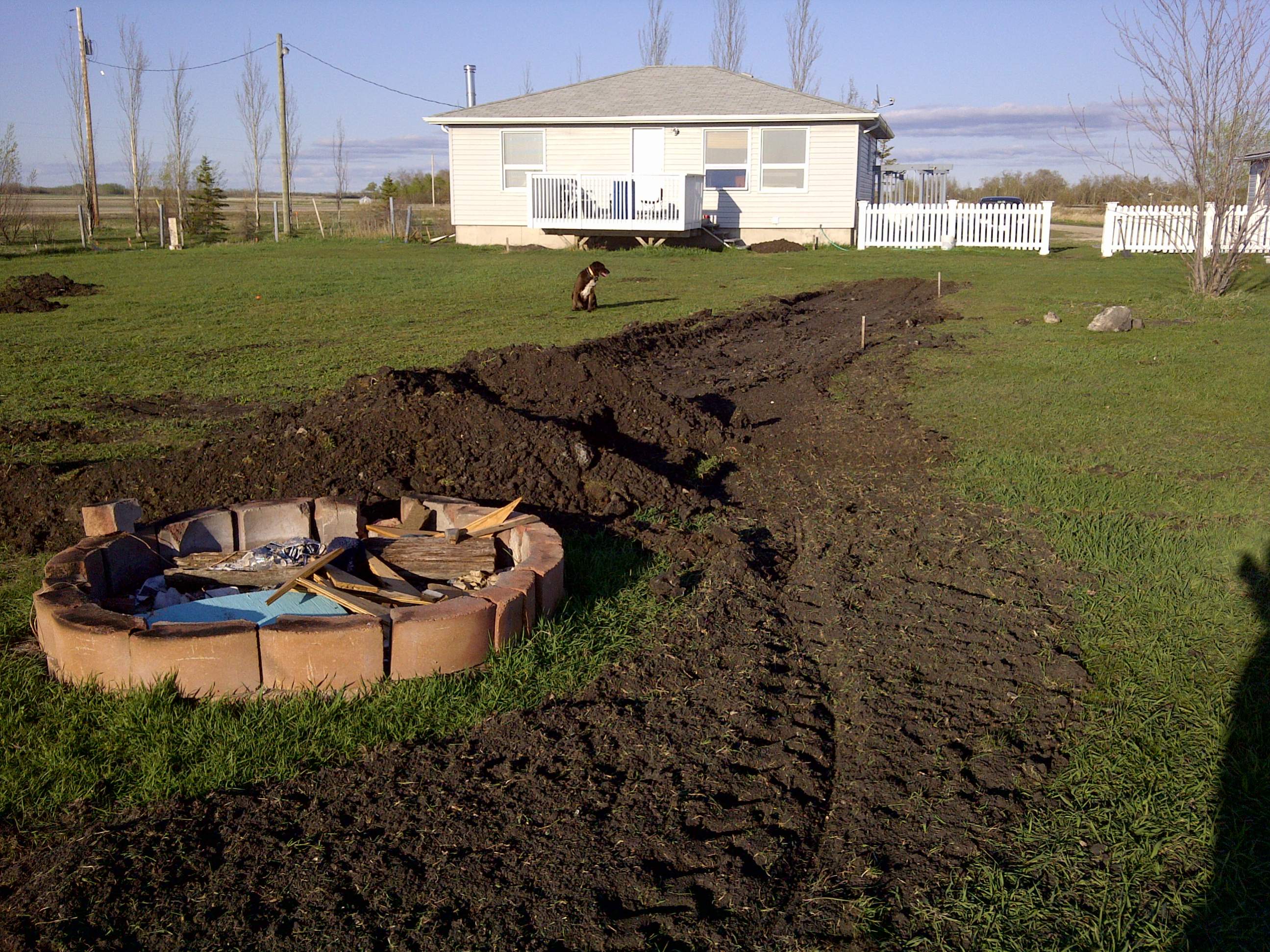

I picked a bad time to start this project.
I hadn't planned on starting til the fall.
On Friday I found myself in the backyard with the tiller attached and 1 thing led to another. Now I've got a landing strip 65 feet long and there's no going back!
I'm hoping to be done next Sunday.
I started by tilling then scraped what I could with the loader.
Using railway ties as edging, gravel as the path.
Pick and axe to set my edges.
It's slow going but there is progress.
Would be much easier if I wasn't a sissy!

psssstttttt.... the FD recommends extending the top of the ladder 5 rungs above the edge of the roof. This gives you something to grab on to as you step on/off the ladder.
so from the pic, it looks like the path to no were.... you have a barn or something planned for the back of the property?

Looks like you are putting in a path out to your fire pit?
/ gravel path=giant mess
Path leads to our firepit.
5 feet wide between the ties.
Lots of clay coming out.
Not pretty.

It is to late now, but this is what I would have done.
RoundUp the path and then spread some landscape cloth double layer on top of the grass and top that off with about 4 in of gravel. No mess no fuss. You could have laid that landscape cloth inside the railroad ties.
You could have been walking on gravel by now.
A gazebo over the fire-pit would be nice.

I want the ties to be flush with the graound so I can drive over it.
Would also be a trip hazard going back and forth to the firepit.

Agree, The ground looks soaked. No drinking and driving a tractor. Bad things happen.Let ground dry ouy and box blade flat again.

Your dog is laughing at you. I bet the wife is impressed as well. Good luck, you need some.
