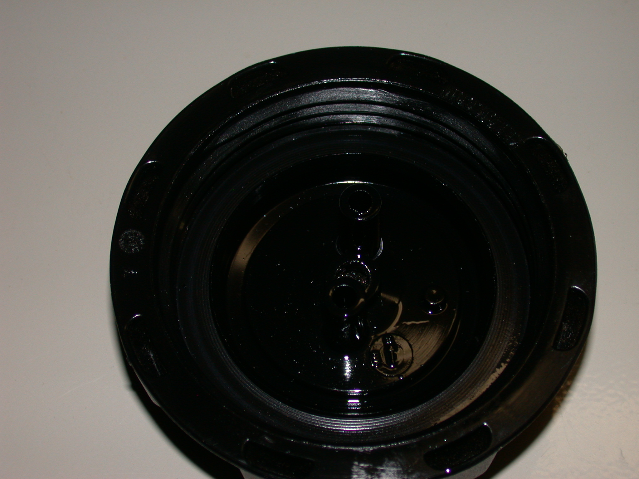

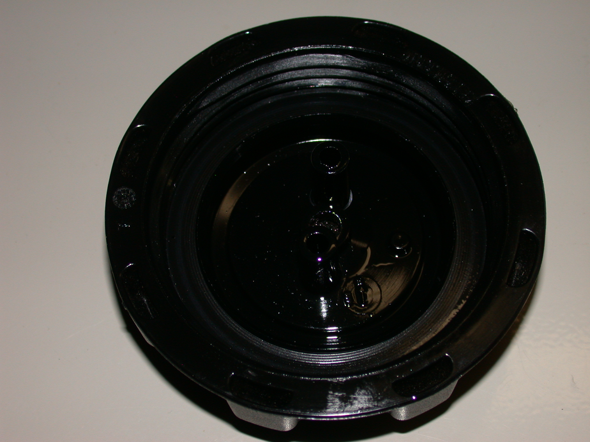

I ordered the filter should be here on Friday. Now how do I cut it and how wide. Some how I got the #s backwards must be sicker than I thought.:eek: See cancer Doc tomorrow.:thumbdown:

There is no need to cut the K&N 25-1480. You can simply pull it onto the filler neck in one piece. However, if you want, you could cut the K&N 25-1480 into two or three separate loops, each approximately 1.5 to 2 inches, so that you can swap them out. You would be cutting horizontally so as to preserve the loop nature of the prefilter. E.g., like so...

Yes, at least for now. I may end up cutting it into two or three pieces. I have not decided whether I will do that. It does take a fair amount of force to stretch the material so that it will fit onto the filler neck of the fuel tank. I was concerned that if I cut the material, it might not have as much strength, and might rip when I tried to apply it to the filler neck. That is why I did not cut it initially. You will want the prefilter to be snug up against the underside of the filler cap.

Did not try it yet, seam a bit weak now to stretch it. May wait till my brother stops over. It is very wide.How about a cap pic shot and a cap on pic?

Got it on, tight fit..
