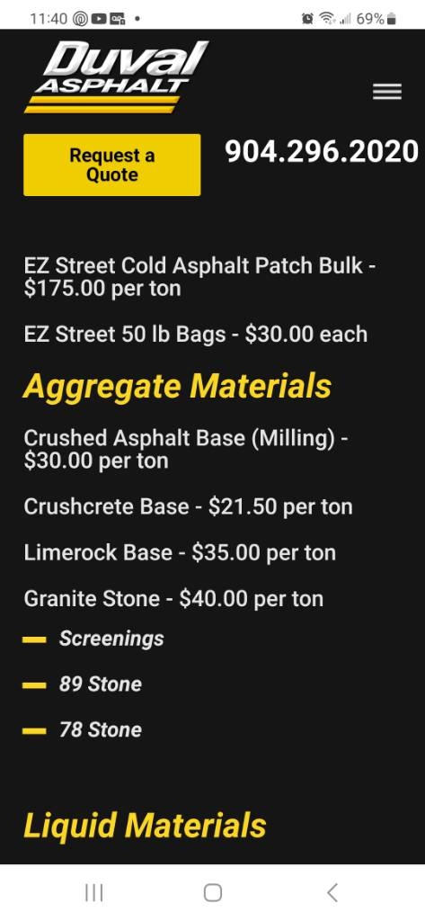

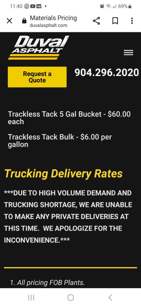

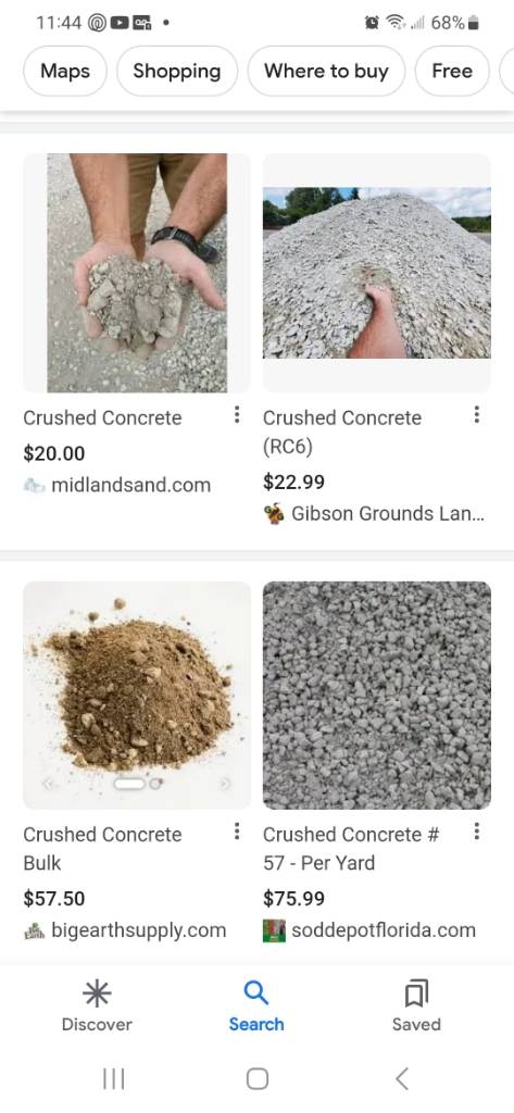

I would be curious what other regions' prices are like, even though it will be hard to compare, with different names/different ways things are billed (ie are you paying for trucking and material as a single load price, ect).
   / Gravel Driveway - reduce/control aggregate movement #39
Attached are some more local prices.
That Hot mix-recycle, I dont know what the recycle percentage is; but $100/ton is less then I expected. That limerock base is very high, as it's hauled from Ocala, and stockpiled in Jacksonville, so it's already been handled twice, and trucked 75 miles
Note: those are all FOB prices; forget the actually words its stands for but the easy way to think of it is Freight On Buyer
