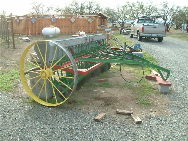

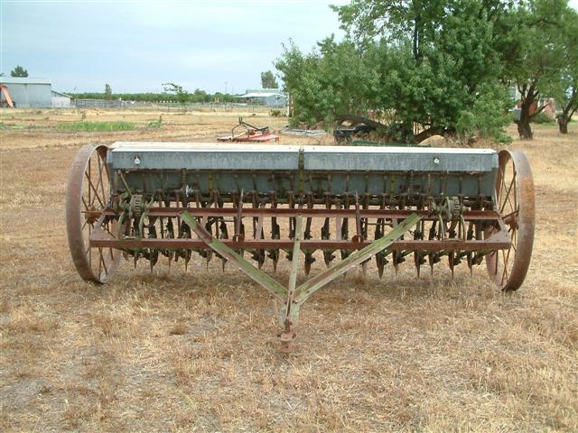

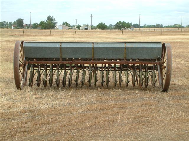

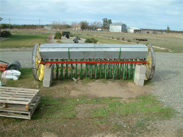

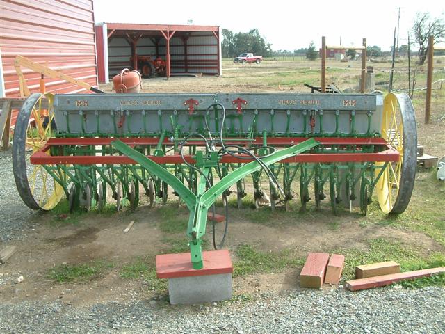

I just calibrated my recently restored Minneapolis Moline P3-6 grain drill (10 ft wide, 20 drops) for fertilizer and oats. It has a pair of grass seed boxes to handle the kind of seeding you're interested in. I paid $275 for a pair of these old beauties---used one as a parts unit to make one good unit.
Before:
After:
Restoration costs mainly fasteners and paint ($150 or so).
This is the least expensive alternative I can think of.
You can find grain drills with grass seeder boxes on eBay regularly. JD B, FB, FBB drills go for around $500.
