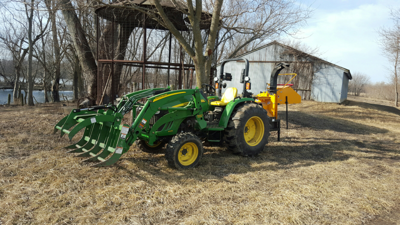

I never have my camera with me when out chunkin logs or moving rocks. So... we will just have to be happy with my grinning grapple.

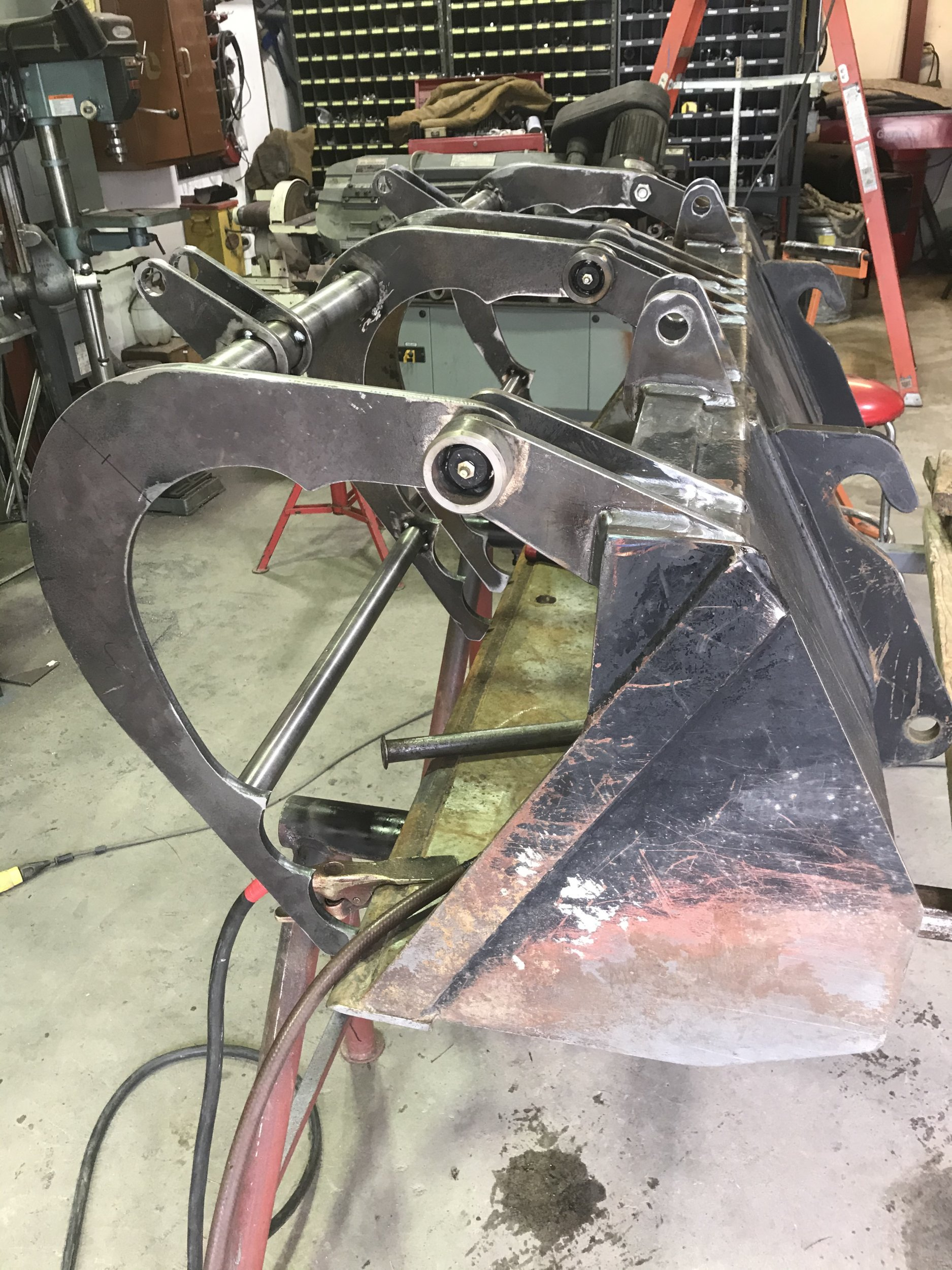

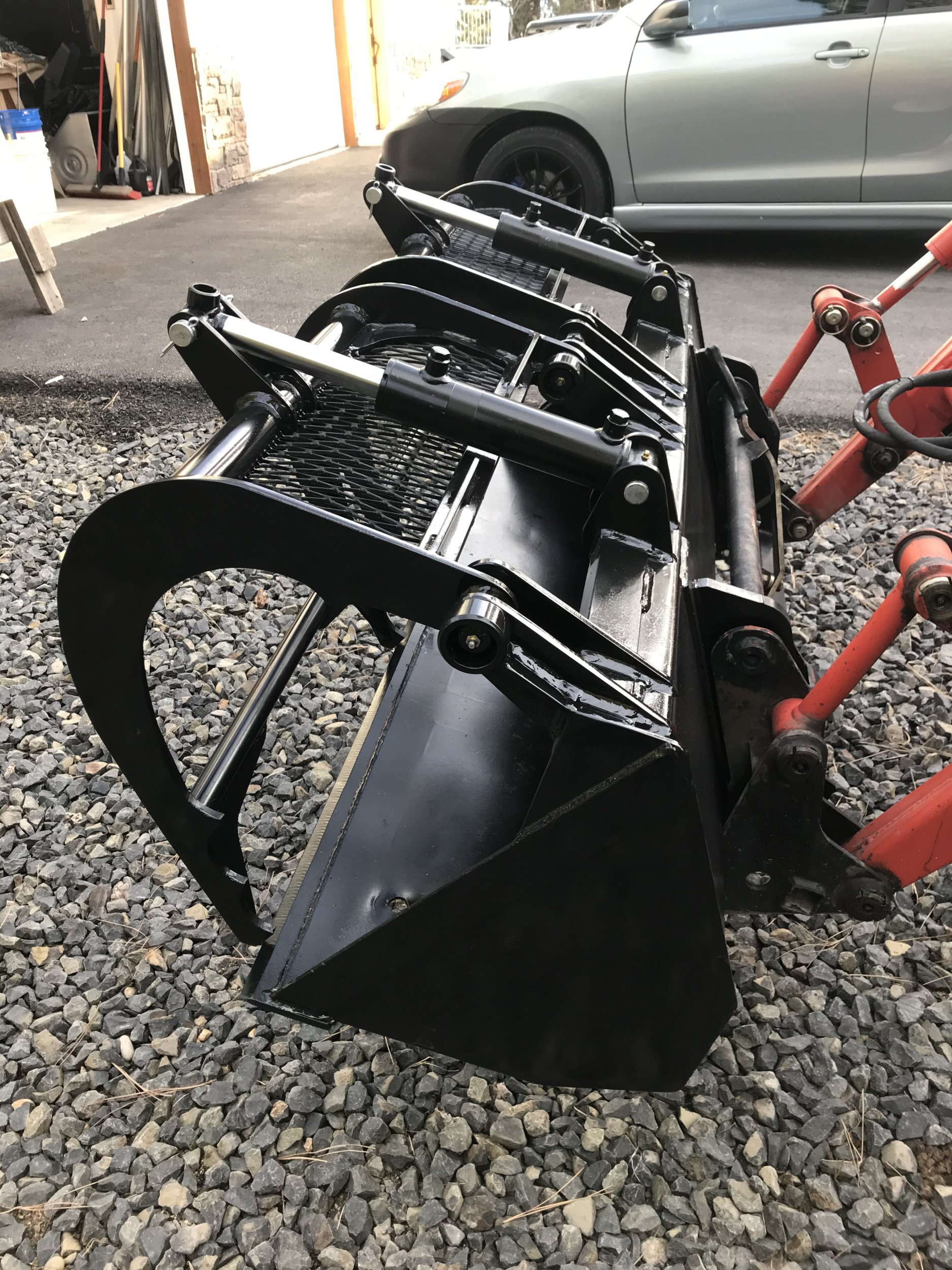

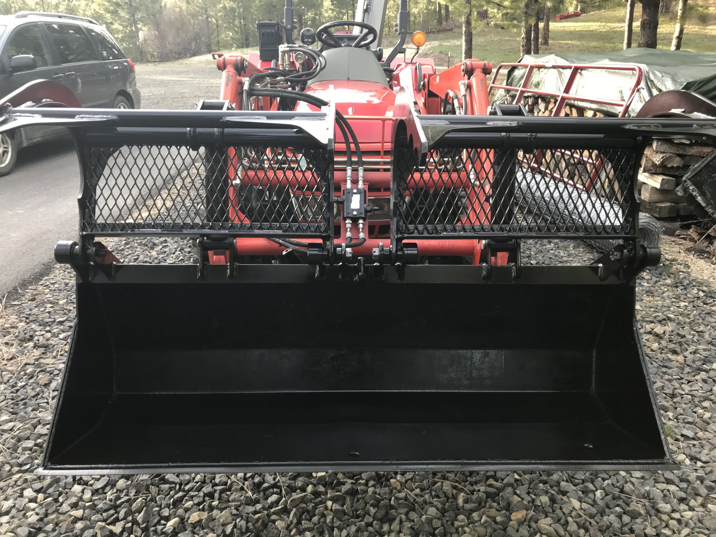

Fun build and a very handy tool for sure. I will probably eventually remove one and move the other to the center of the bucket, I don't think having tandem grapples is worth the extra weight for how I use it (most of the time)
/ Grappling fun - A Picture Thread.... #1,909
/ Grappling fun - A Picture Thread.... #1,910
/ Grappling fun - A Picture Thread.... #1,912
I like that!
Did you make all the parts youself?
How much do you have in it?
Thanks!
I drew up the grapple on Sketchup, then converted the drawing (of pieces I wanted cut out) into a .DXF file and had a buddy with a plasma table burn them out for me.
Some of the steel was scraps I had laying around.
I guess I spent $500 or $600 on steel, DOM tubing, cylinders, hoses, fittings etc.
Allready had front remotes, so that saved quite a bit.
That first time picking up the log must have been extremely satisfying! Really nice job, and looks so useful. You are obviously a skilled individual!
/ Grappling fun - A Picture Thread.... #1,914
First pick was three railroad ties at the same time...and not having to get off the tractor was so cool!

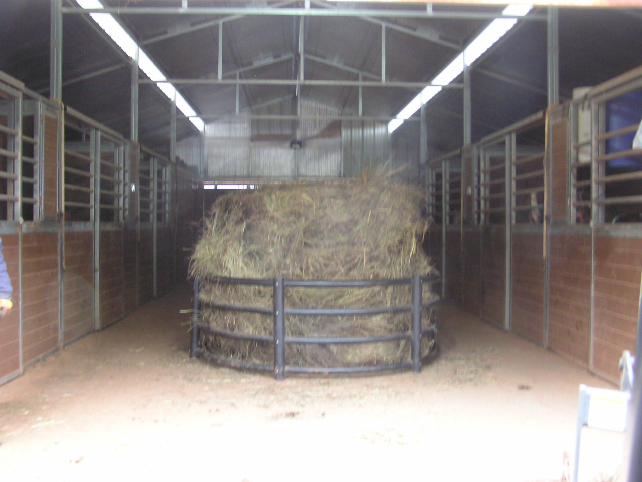

That reminds me, I have used the Monster Grapple to set a 5x6 round bale on end:
