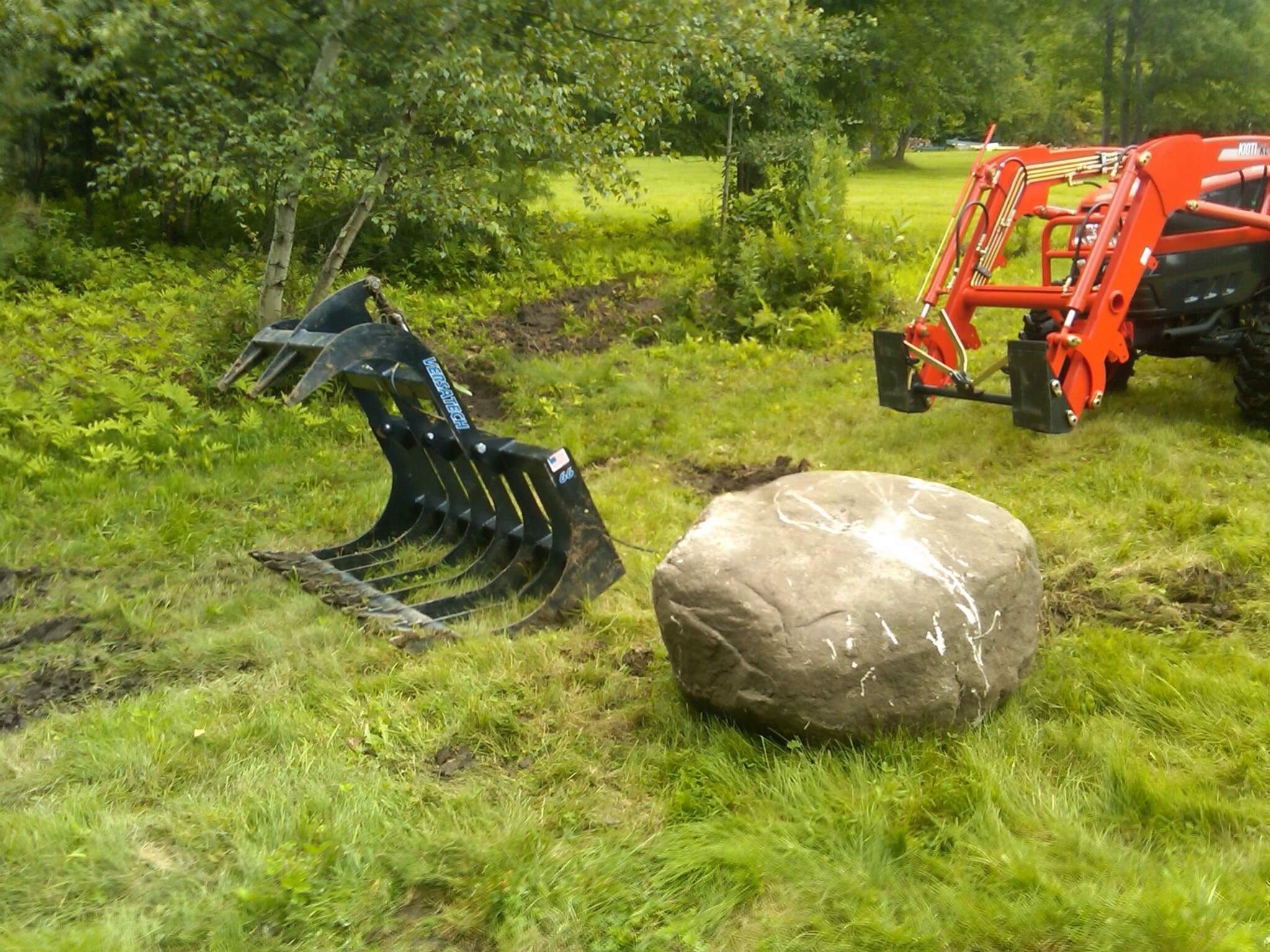

Look around at auctions, i picked up an orphaned "new" versatech 66" for 800$ and its been a bruteimage.jpg
/ Grappling fun - A Picture Thread.... #167
Look around at auctions, i picked up an orphaned "new" versatech 66" for 800$ and its been a bruteView attachment 403030
He has the LA524 loader and would probably be better off with a lighter duty grapple unless he finds a CL bargain like you did. I think the versatech weighs something like 500 lbs or more which would put a pretty big crimp into his net lift capacity. As I recall the LA524 lifts only about 1200lbs to full height so is about half the lift capacity of the Kioti. The EA light duty weighs less than 300lbs. My Millonzi light duty 48 weighs about 300lbs and is currently mounted on a Kioti DK40se. I've always used it appropriately in the sense of lining up the load so as not to twist either the grapple or FEL but other than that precaution, I've beat the snot out of my grapple and it is going strong after 8 years. Some battle scars yes, but fully functional and my favorite implement.
Great point, was only thinking price, mine is probably a little less than 500 lbs, 3 of us put it in my silverado, guessing 400 lb, but lift would still be impacted on tractor in question.
This is why TBN is so great, all angles are covered by a broad community!:drink:
