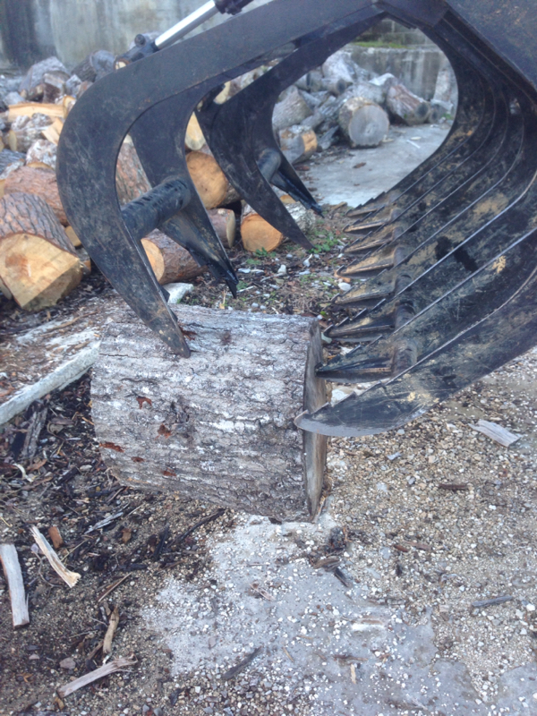

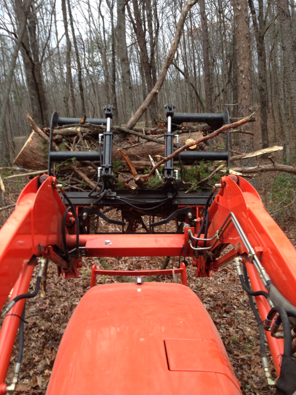

Any idea how much it weighs? You seem to get a very good sized load considering your loader's lift capacity.
/ Grappling fun - A Picture Thread.... #1,082

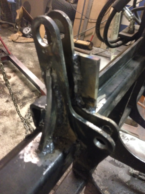

Well, I said I wasn't going to :D ... but here goes:
My guess would be somewhere around 450 - 475 lbs ... probably closer to 475.
That's based on a couple of things:
1. Some (very) rough calculations I did late in the design phase, before I actually started building it, and
2. Just manhandling it around, while I was working on it.
But that's just a guess and may be way off ...
Without the hydraulic cylinders mounted and the jaw closed, the grapple is bottom-heavy and will sit back at an angle on the QA plates.
I can lay it all the way over on it's back onto the floor and then stand it back up by myself ... barely ...
Factory spec for the relief on my loader is 1991 psi ... I have it set to around 2100 - 2200 psi IIRC ... so that may account for some of that.
Most of the loads he has been lifting are brush and single bigger trees. I was able to lift loads like those with my 1070lb capacity CK20 loader with a 300-325lb grapple. I'm sure he can lift more but until he decides some big boulders or much bigger tree trunks or stumps need lifting we won't know. Also, in practice we literally never lift a grapple load to full height so if he can lift a load 24" he still has a practical way of moving debris.

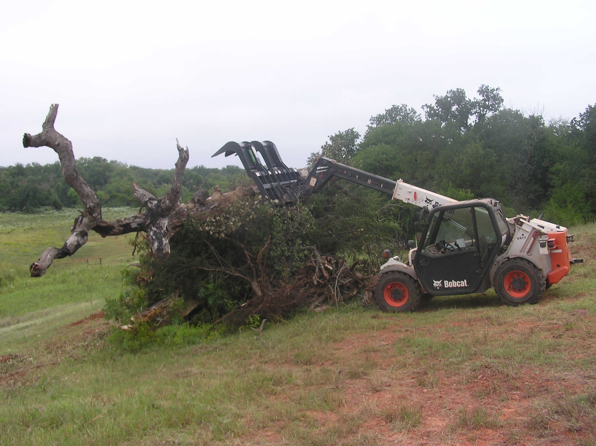

I have a HD 84" dual lid Blue Diamond grapple and a 73" single lid EA Wicked Utility grapple which are nothing like your design. I envy your 55" opening. I bought the EA specifically for brush / limbs and 42" jaw opening.

I have a HD 84" dual lid Blue Diamond grapple and a 73" single lid EA Wicked Utility grapple ...!
The ones in the face-off pic right ?
Nice equipment.
... which are nothing like your design.!
LOL ...
Yeah, yours were designed and fabbed by actual professionals ...
I envy your 55" opening. I bought the EA specifically for brush / limbs and 42" jaw opening. !
How do you like it?
Yup.
Interestingly enough, I almost started pickin' some boulders day before yesterday. We have about a half dozen or so out in the circle in front of the house that are kinda submerged in the plants ... was thinking about relocating them to a better place in the landscaping but decided to wait until I had the big ballast block on, rather than just the box blade.
Yeah ... I won't be lifting anything that's very heavy real high.
Surprisingly, I have had the grapple up a ways (4' or 5') while motoring around when it's empty and the tractor seems pretty stable ... which kinda makes me really wonder about how much it actually does weigh.

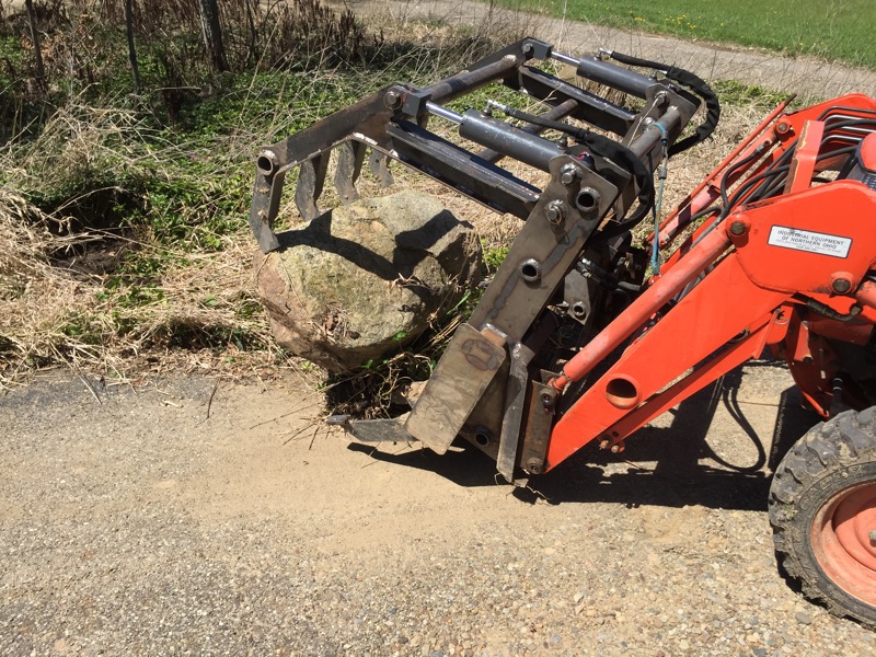

Soooo ... I checked the tire pressures, greased the loader up, and went ahead and put the big ballast block on and decided to try a little rock pickin'.
This is the first one I tried ... couldn't lift it very far:
But one I got a little better pick point and rolled it back ... no problemo :D:

Somewhere along the way I tried this one ... couldn't lift it. Probably due to where it was laying. I have a basket made out of nylon webbing ... might try that to drage it up on the driveway where I can get a better shot at it:

That's actually a pretty good sized rock. Granite is 175lbs/ft3. I'd guess your rock is closer to 1000 than 750lbs. I'm not surprised you couldn't lift it higher. The LA402 loader only lifts 900lbs to full height after all. The physics work in your favor with the short bottom tines so the rock is close to the pivot pins. I doubt even with your standard bucket on that you could lift that rock much higher and you'd be a fool to do so anyways. I'd say that if you can lift that rock even a couple of feet off the ground to move it then functionally that's all you'd ever really want to do. I'm sticking with my 425lb guesstimate but if I'd seen that photo first I would have lowered it by 25-50lbs.
Which one ? :D
I wouldn't be be surprised ...
Yup ...
Yeah ... generally I tend to keep things as low as I possibly can ... if 6 or 12 inches will do it, that works for me.
With rocks that's no problem ... but with long logs sometimes I have to raise them higher to clear obstructions.
