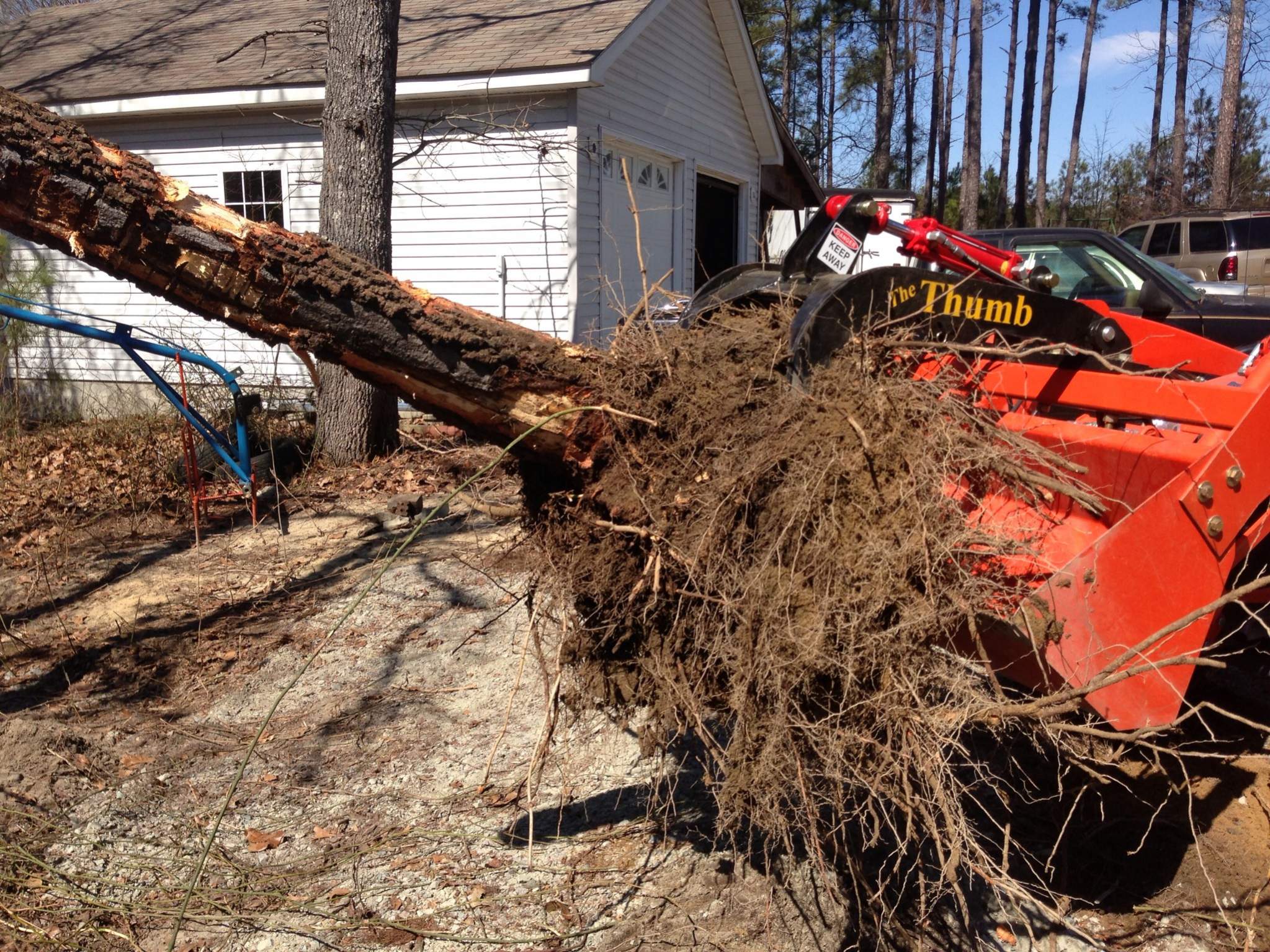

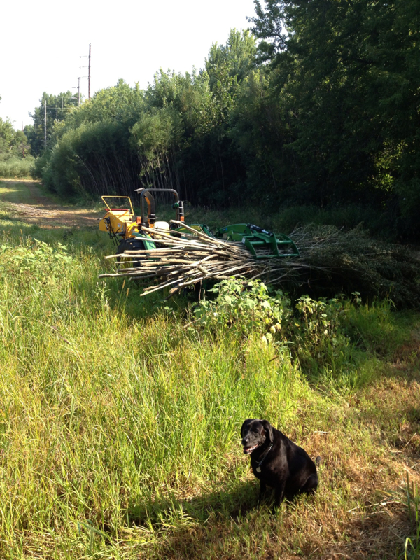

Here is my 60" Frontier Root Grapple -- and some willow trees ready for the chipper.

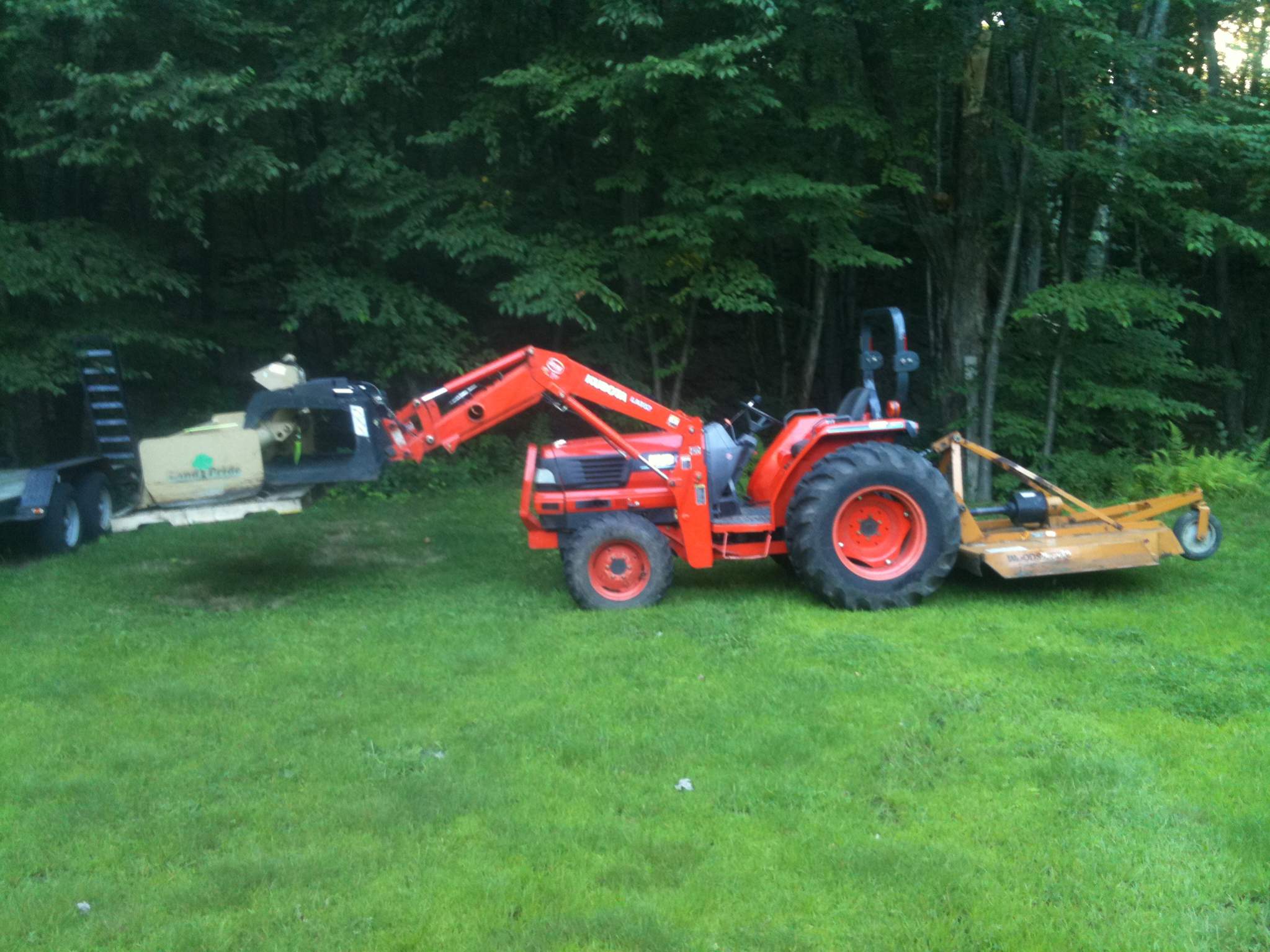

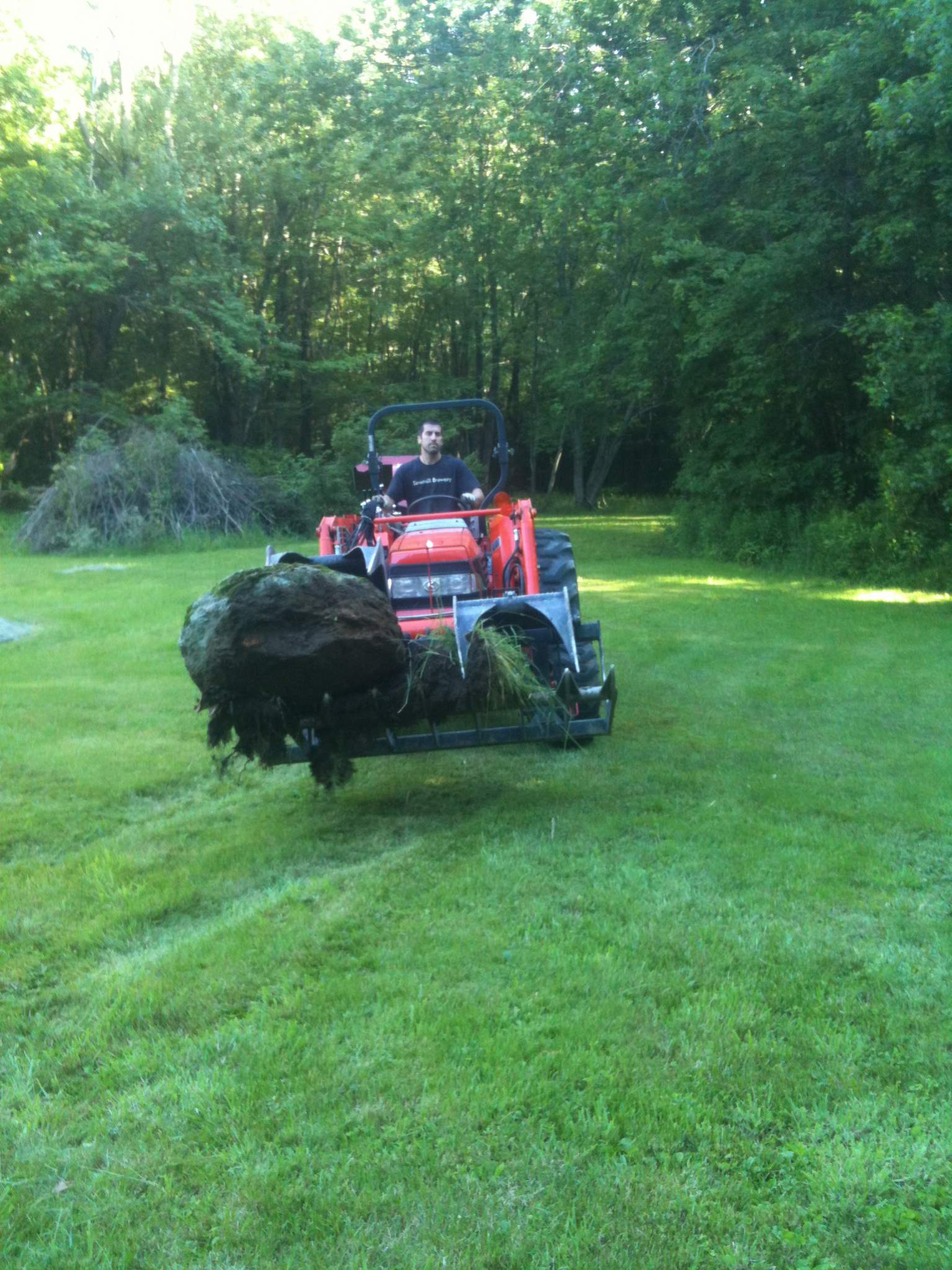

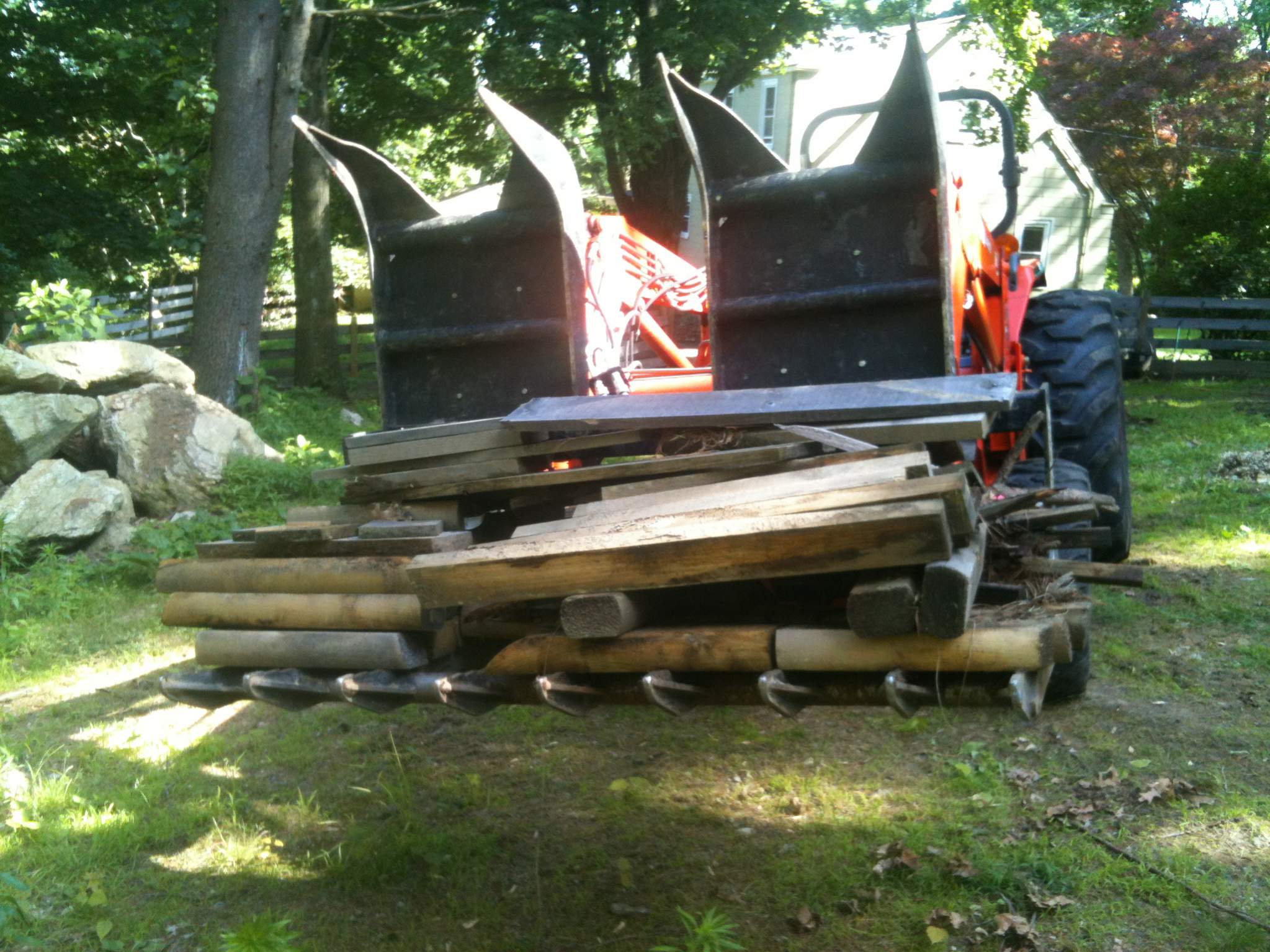

Is there anything cooler than moving brush with a good grapple?:thumbsup:
I don't know about "cooler" but I find ripping out brush, knocking over trees and carrying so much brush in a load that you cannot see where you are going to make me REAL happy it is the grapple/tractor and not my back that is doing the work!
Oh, yea, almost forgot the rocks......hurts my back to even think about moving those without a grapple.

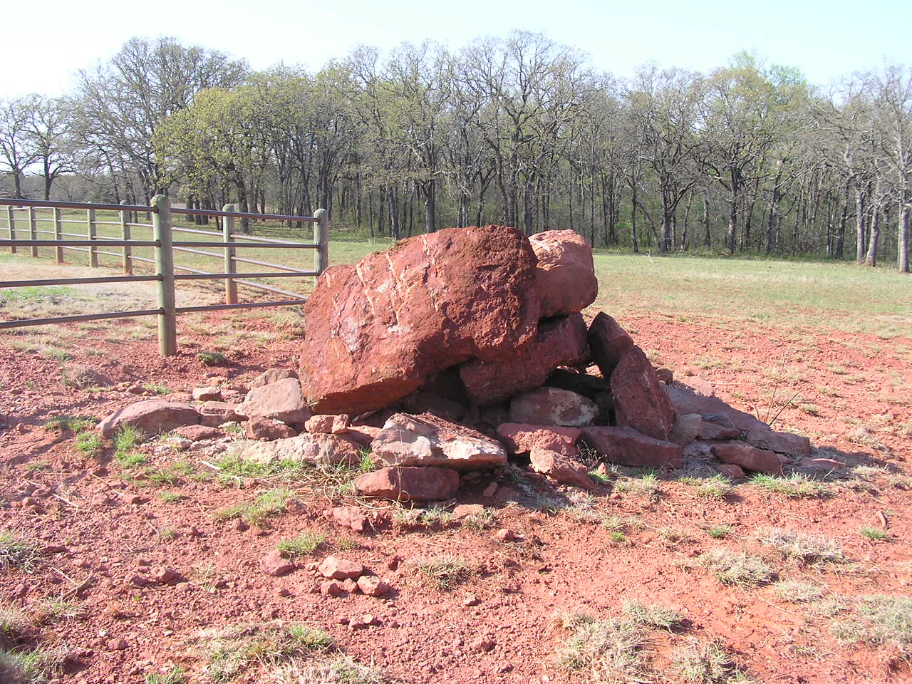

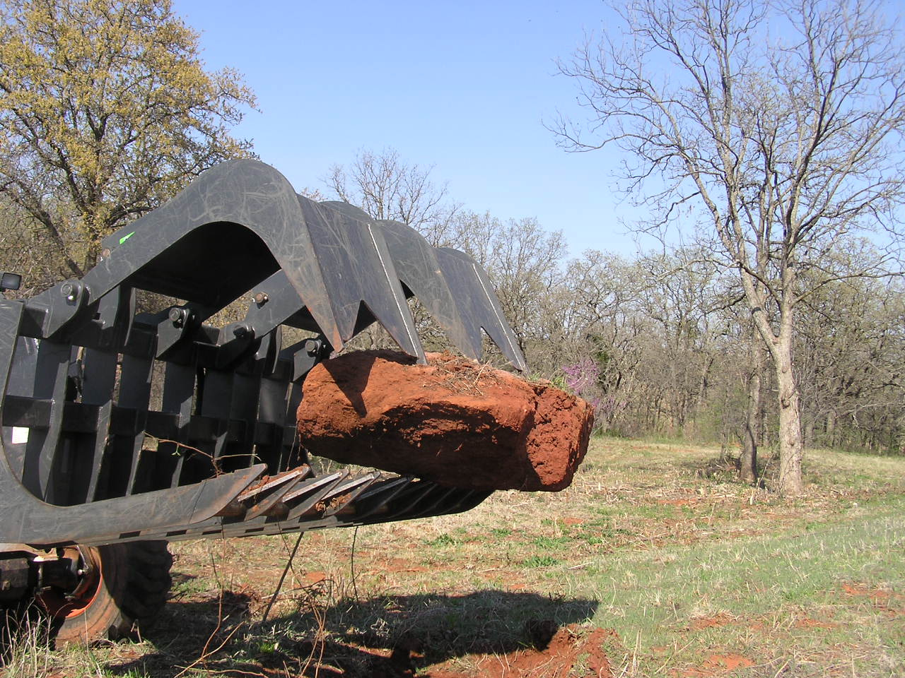

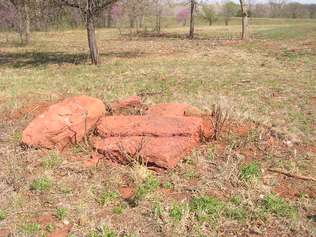

Yep, Rocks.
Got two rocks.
Got three rocks.
Got four rocks.
Took them to the pile.
One more rock on the pile.
Another rock and the pile.
/ Grappling fun - A Picture Thread.... #87
Is that a burn pile:laughing:
No, that is a rock "mating Klatch". Kinda like one of them snake balls. How did you think new rocks are around every spring when you plow.. They have to propagate somehow. :D

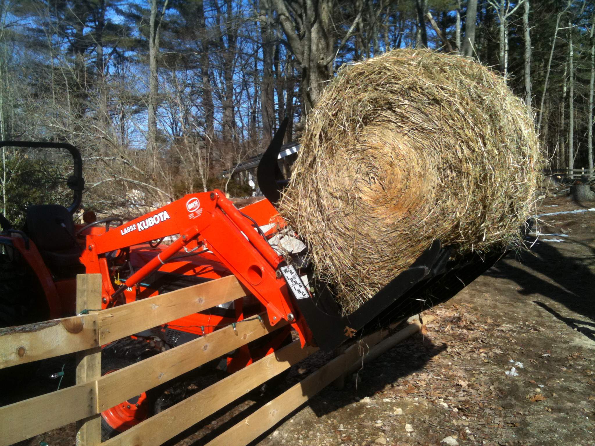

Grapples are cool in general. Using the grapple to move brush is definitely fun. It would take forever to get a load like that on the truck by hand. The grapple is a huge times aver.
or green ones
O.k., Roger, now I'm really impressed! :shocked::thumbsup:
/ Grappling fun - A Picture Thread.... #90
I started a thread on that log to see how much it weighed. I punched the weight into log weight calculators and came up with 3,500lbs. People in the thread estimated it weighed between 3,000 and 3,500lbs. Once I showed the pictures of the 4240 lifting it they said it did not weigh that much:confused2:

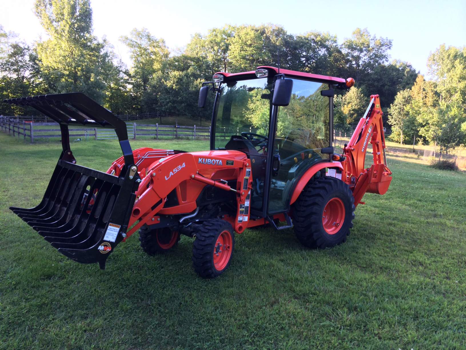

I recently got this grapple for my B2650. Have used it to move brush and a few stumps that I dug out with the backhoe. Sorry, no action shots yet, but a very useful attachment.
/ Grappling fun - A Picture Thread.... #93
Hi Matt
Its a Land Pride SGC1060, and I got it from my friends at Townline Equipment in Plainfield NH.
Thanks
Scott

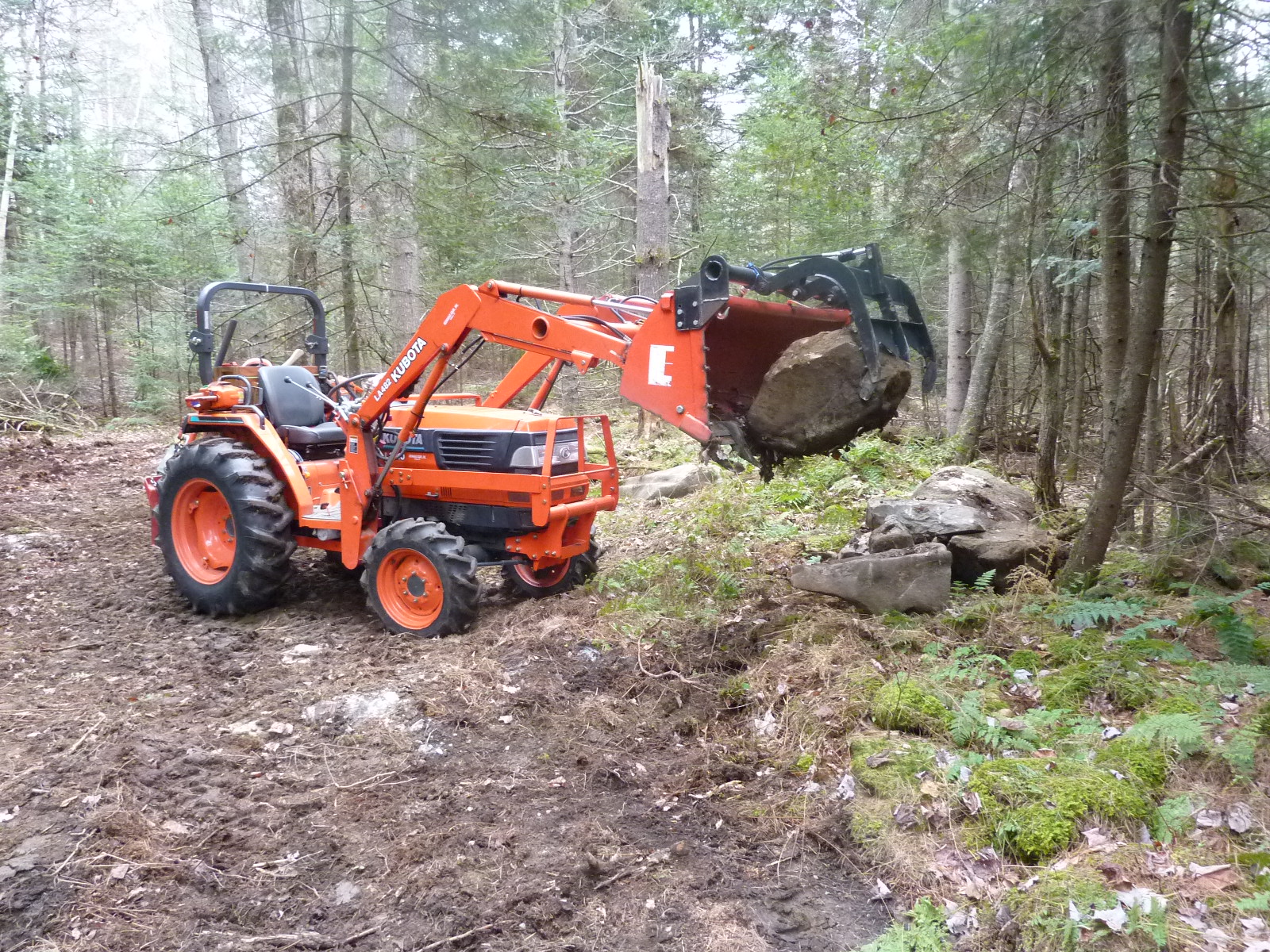

I have an older pin-on bucket vs the newer easy-change bucket so switching between bucket and grapple would be a lot of work. So I got a bolt-on grapple. Even if I had a easy-change system I am not sure I would get a dedicated grapple because a lot of the work I do requires both bucket and grapple. One minute I am moving a rock or stump and the next minute I am moving dirt with the bucket to fill the hole where the rock or stump was. No matter where I am I have both available all the time and even though my grapple is less capable than a dedicated grapple I have always been able to get the job done and don't feel handicapped.
