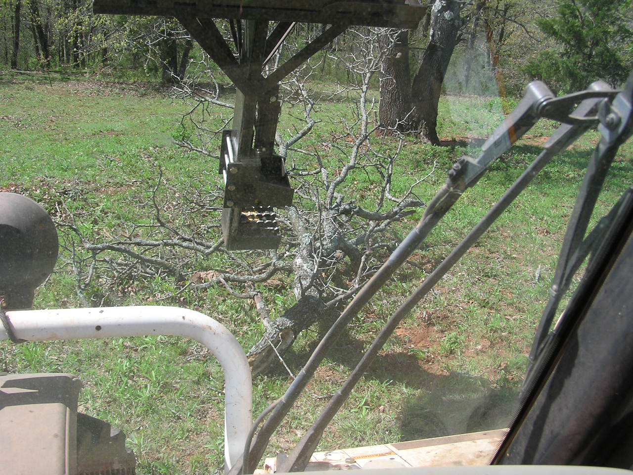

I haven't found that to be true at all... I can push the forks together and load them with small brush, grappleing it, OR leave them further apart and driving right under brush piles, grappleing the pile as I pick it up to move it...no problem at all!
As for stones, what size ??, Smaller ones,
Medium size?,
OR big ones ?,
Heck, I can drive the forks right under the rock in the ground, grapple it and pull it right out of the ground!
That single grapple is just about perfect!
SR
Sawyer Rob,
Your pictures do talk for themselves. A real eye opener as to what a set of pallet forks can accomplish with the addition of a single well designed clamp.
Thank you.:thumbsup:, and Happy Tractoring :tractor:

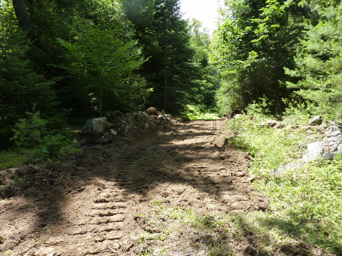

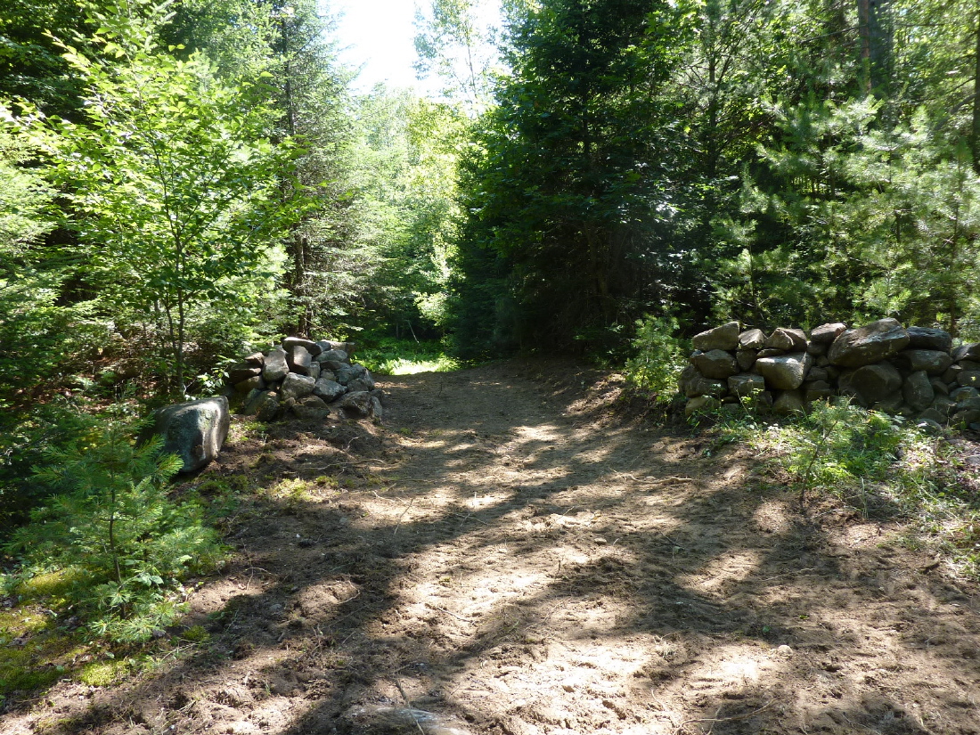

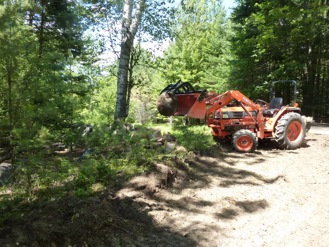

I do a lot of small scale logging so there is plenty of logs and brush to move. But I also need to be able to make and maintain woods roads and landings which involves dirt and rocks. I don't have a quick attach bucket so my bolt-on grapple works out well for me. I have a bucket and grapple with me all the time. Here is an example. I had an old skid trail that was made before my time that I wanted to use. It went thru an old rock wall. The skidders just drove over the wall and broke it down but I had a lot of trouble getting my little tractor over the mess they made. To fix it I pushed a tractor road thru there with the dozer and windrowed all the wall rocks and dirt.
Then I got the tractor/grapple and picked out the rocks to rebuild the wall and make a decent opening. Largely in respect for the old timers that built these nice rough wall by hand. And I like the looks of them.
Then I used the bucket to clean up the dirt and finalize the road.
That was a while ago with the original ATI grapple. Since then I have added a tooth bar and made some other grapple improvements.
