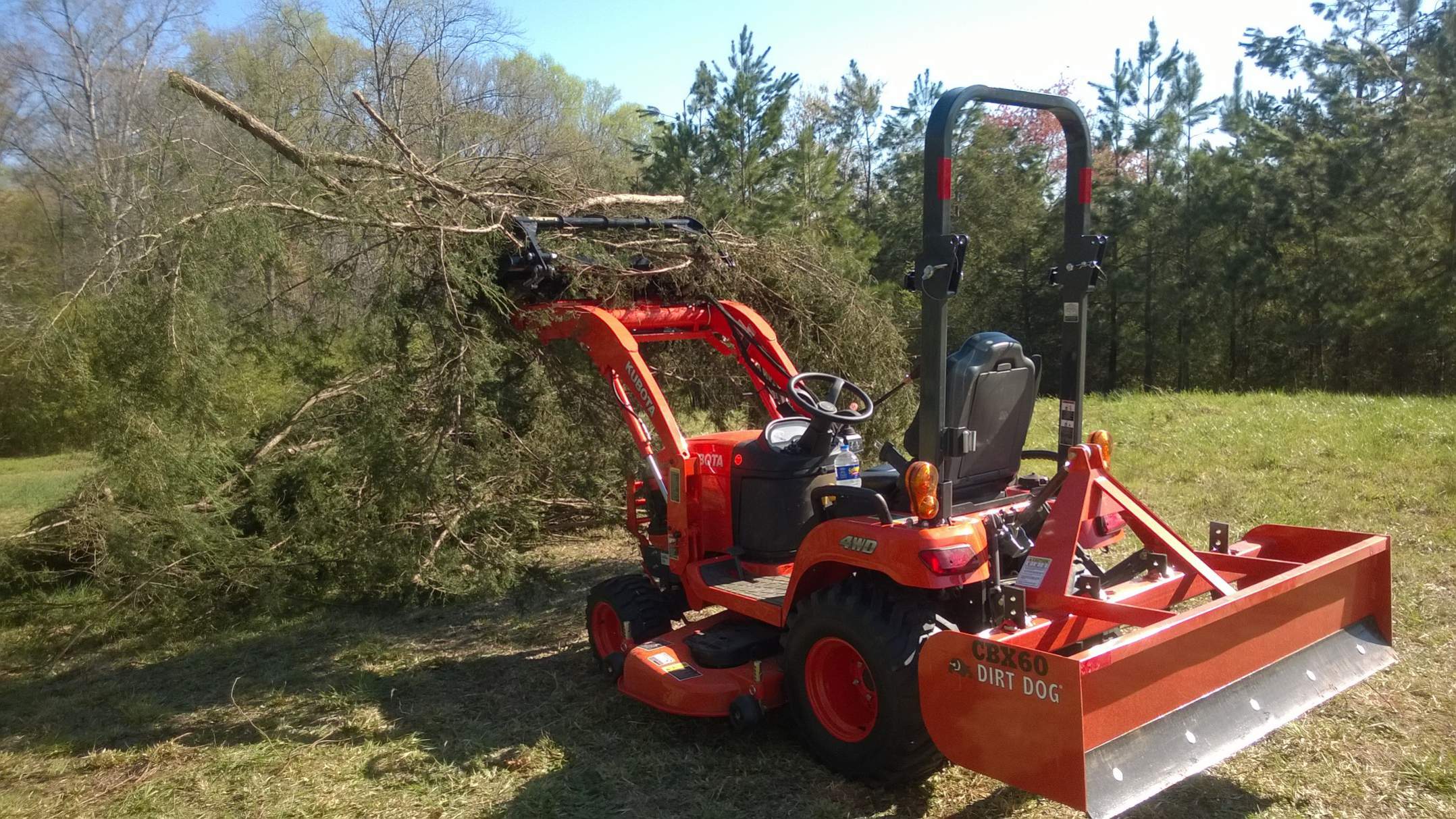

Well, you do know they make a grapple built SPECIFICALLY for the BX series right? :D

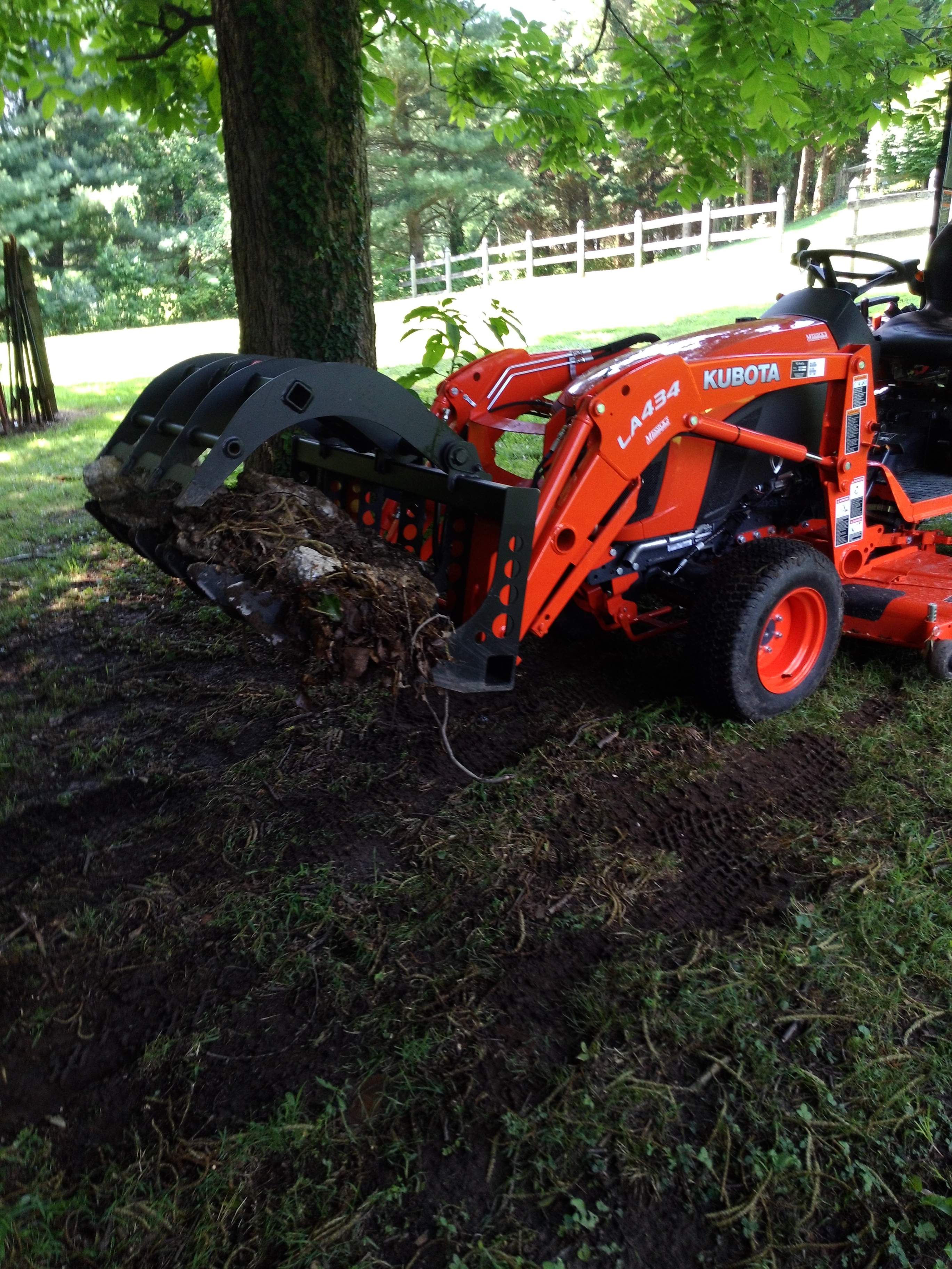

Here's mine. Sure beats the heck out of doing this by hand. Surprised at what I've been able to do with it already and I'm still figuring it out.

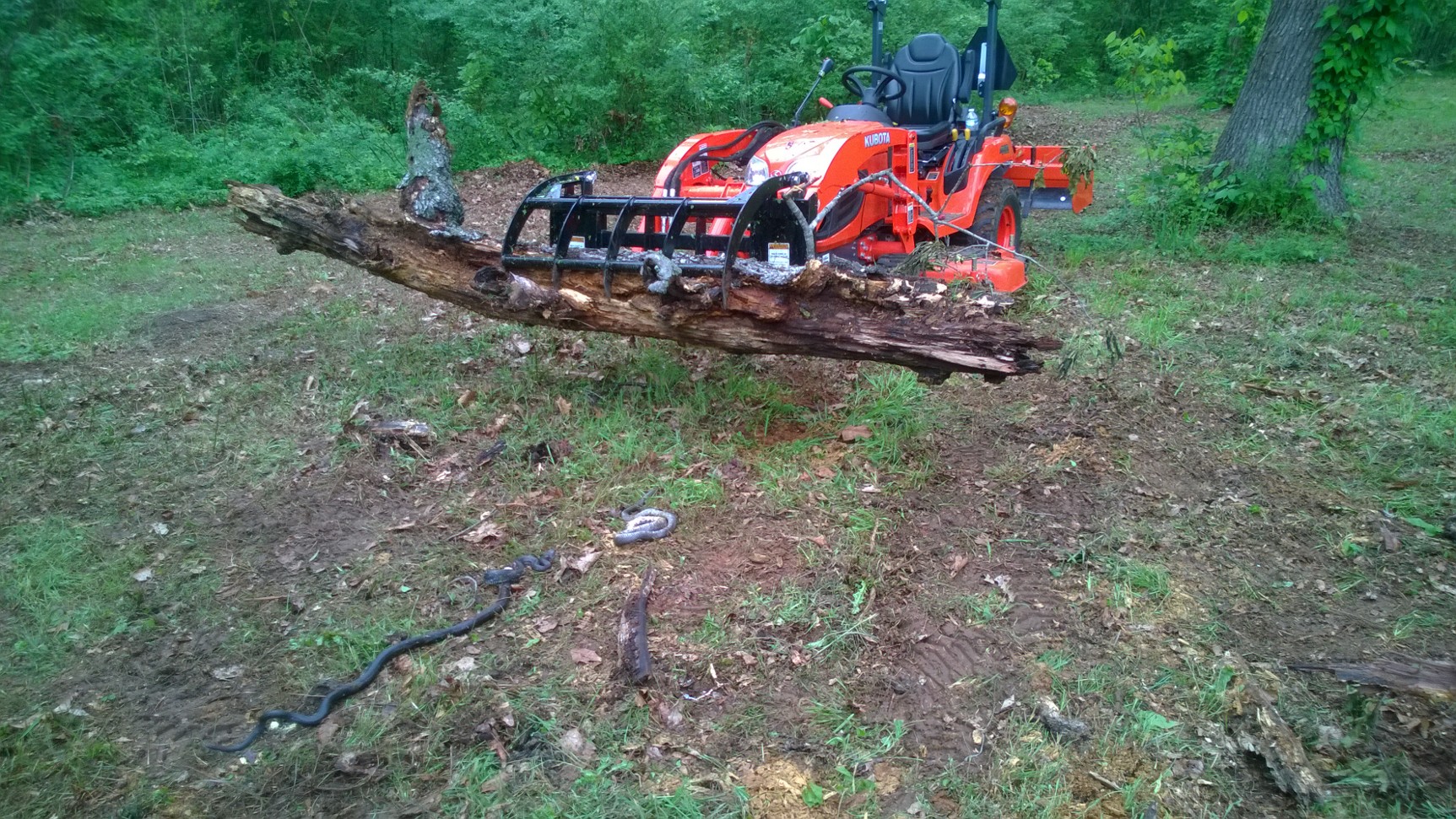

Couple more pics of it. One, I had just broke off the top 3rd of a downed oak tree and 2 snakes were nestled in the rotten part. I actually didn't notice one of them until I was tugging at that part with the grapple and had pinched it against the tree and it was trying to bite the grapple itself.
View attachment 430301View attachment 430302

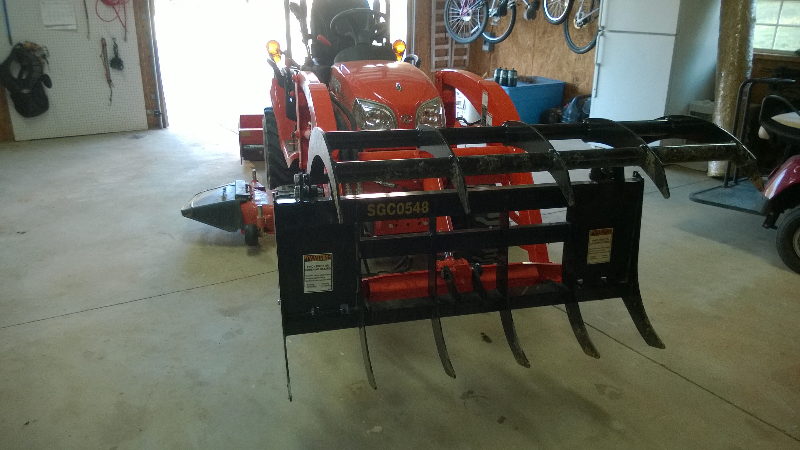

Can I have your barn/garage please? I'll PM you my shipping adress. I bet it's air-conditioned too!

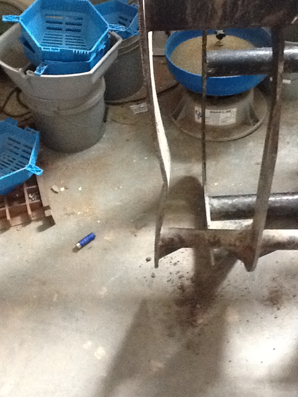

I was driving down a trail in the woods and I hit a small tree. It bent the left side of my grapple.
/ Grappling fun - A Picture Thread.... #290
I tried to straighten it with a bottle jack, but the jack wouldn't pump on its side. Someday I will straighten it out and weld some thicker plate on it and the other side. I'm not worried about it. The grapple still works fine.
/ Grappling fun - A Picture Thread.... #292
I don't remember, but it wasn't made to ram trees being pushed by a 8,500 pound tractor.
/ Grappling fun - A Picture Thread.... #293
Need heat to fix that.
Does it interfere with function? If not just consider it an honorable battle scar.
Luke, believe it or not, it's a detached Pole-garage. Looks nice with vinyl siding outside, but is pretty basic and is not insulated at all. It has soffit vents to help air flow, so is pretty cold in the winter and tolerable in the summer due to it's shade value only.

I tried to straighten it with a bottle jack, but the jack wouldn't pump on its side.-----
A bottle jack will work on its side, if the pump (handle) is on the bottom, so the oil can run into the pump.

That is one BEAST of a grapple! I would be looking for something like that if I had a 10k lb skid steer to mate it to!
Standard spacing on the OBG2 is 8". Optional spacing is 4", which can be accomplished by adding tines to the back and the bottom($270.00) OR to only the back($110.00) or only the bottom($160.00) if that makes sense.
Travis
I wish I had ordered the additional tines when I bought my OBG2 grapple years ago. I was a little concerned at the time, about the additional weight of the extra tines because of all the reading I've done on here about weight. I ended up kicking myself for not adding them when working with firewood and always losing splits between the tines. I finally welded some 2" flatbar between each tine to lessen the gap. I'm much happier now!
Try turning the jack, some only work one way.
Edit: Looks like faxman already said this.

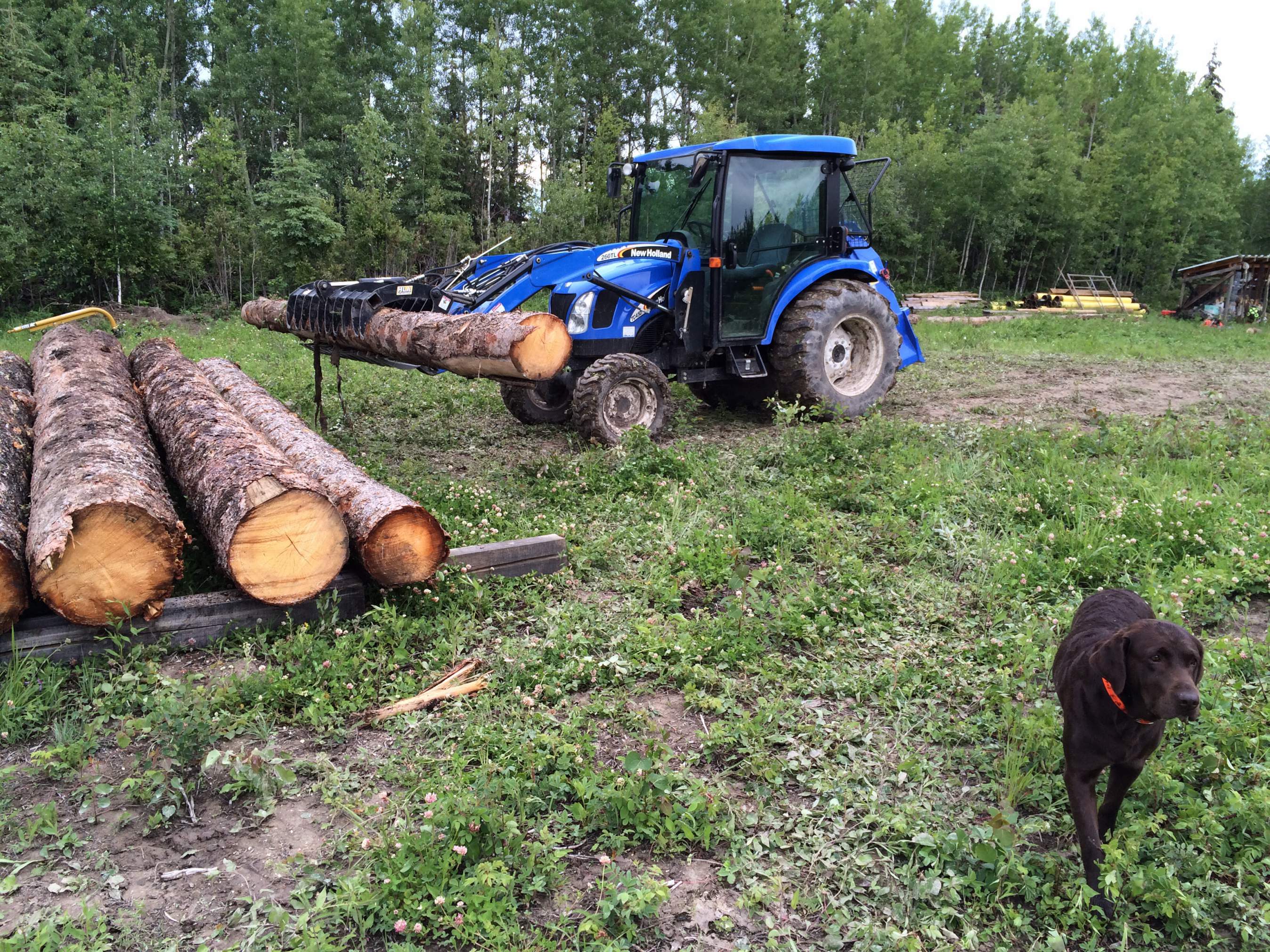

Future cabin pieces. <img src="http://www.tractorbynet.com/forums/files/attachments/430626-grappling-fun-picture-thread-image-jpg"/>
Wish I could say the same! I'm "wasting" all these nice timbers on a retaining wall.
The grapple sure did make handling them
Nice and easy though, I couldn't pick up a single one of them by hand.
