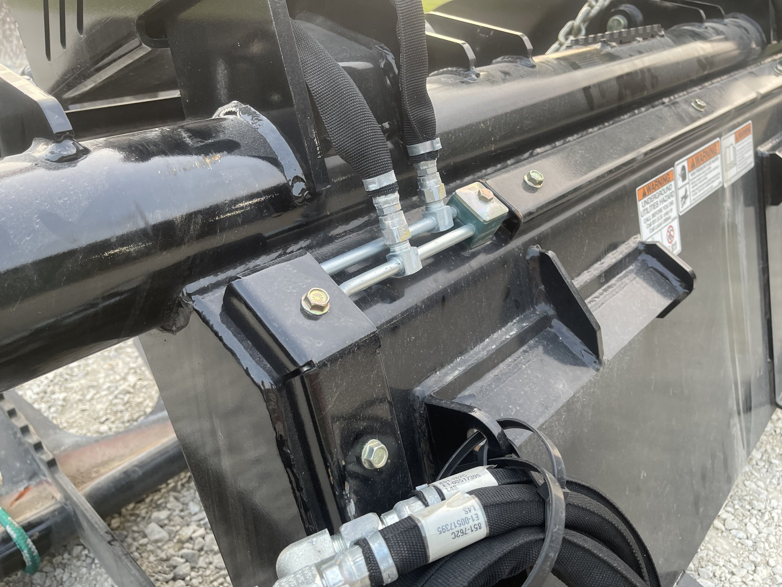

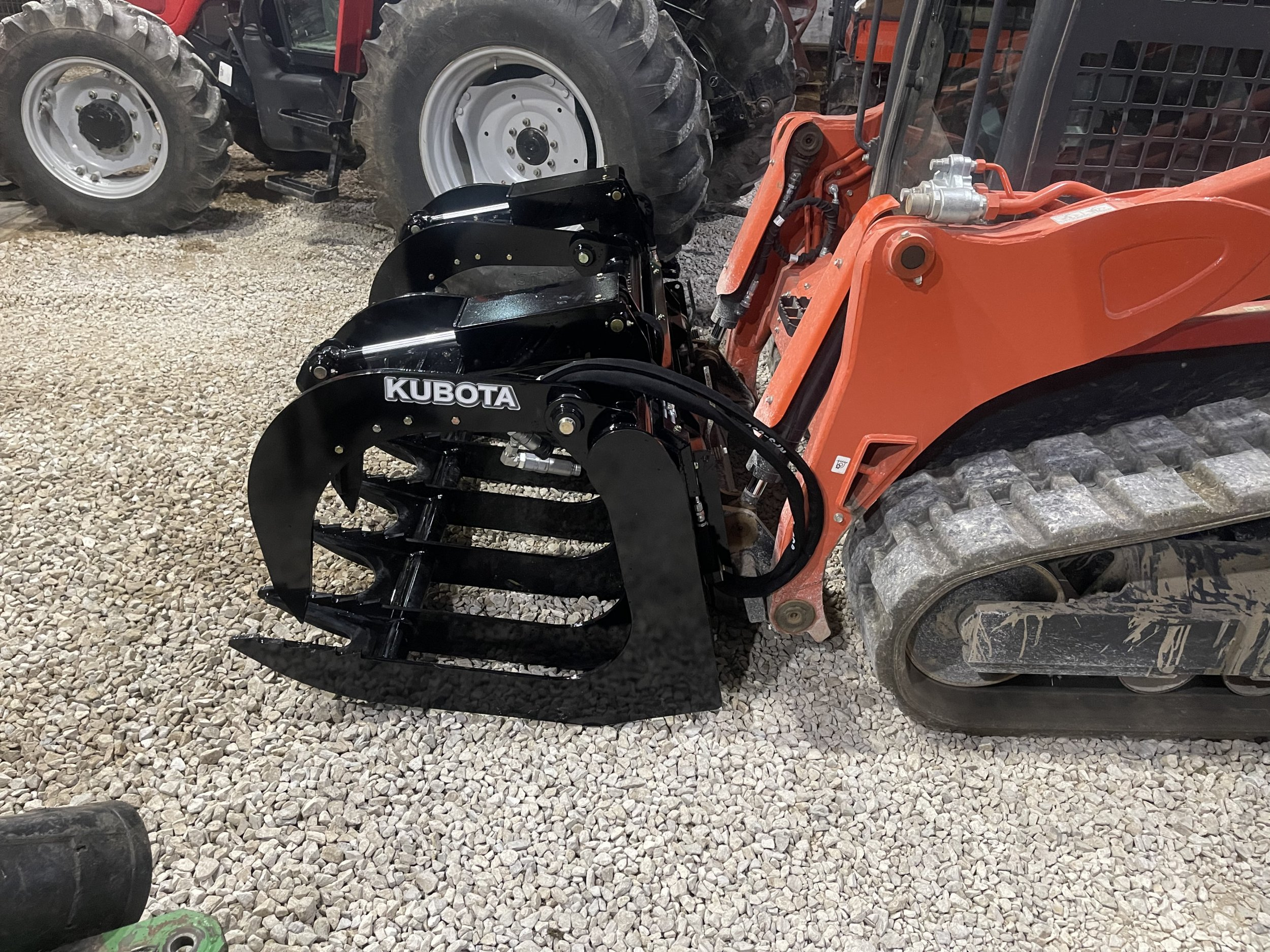

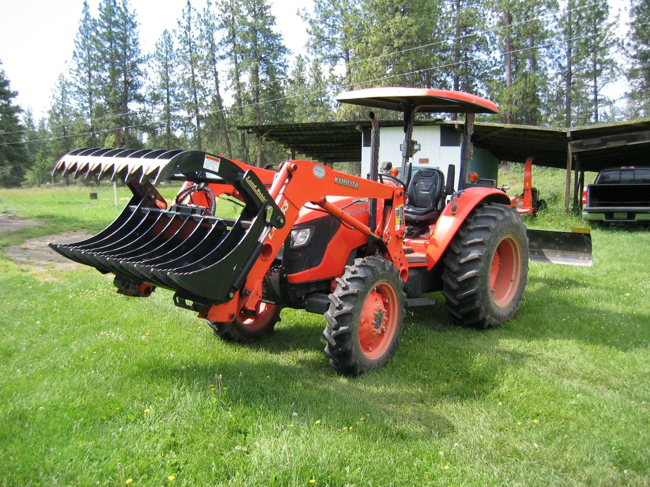

well I went with the land pride/kubota grapple. Stumbled on rg3068 and got a good price I believe, $3500. The land pride stuff is very well built. Steel hydraulic lines and 3/4 tines on the grapples and 1/2 on the bottom. The tines are are spaced 9". The info in this thread tells me 6" would have been better but I liked the land pride stuff. Oh well, this obsessive researching for the best grapple for me is over. lol
next.
You'll be happy with it. No worries.
   / Grapples. Whats the best tine spacing? #18
9" spacing - 6" spacing on the tines. Probably won't make a hill of beans difference.
You will find great pleasure in the uses of this grapple you have chosen.

Thanks. They had a landpride 4 in 1 bucket that had been there for 4 years. I thought hard about it but this was the way to go. $3800 on the 4 in 1 I think.
