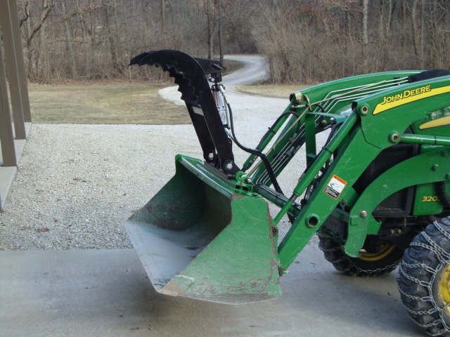

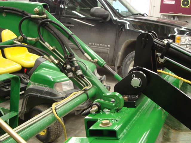

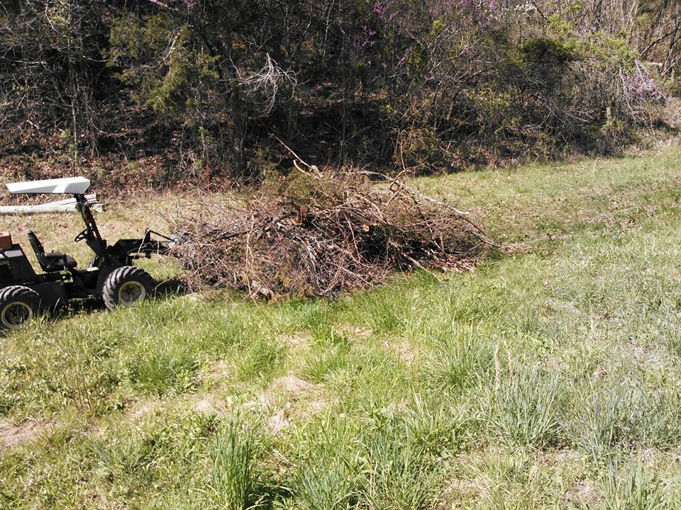

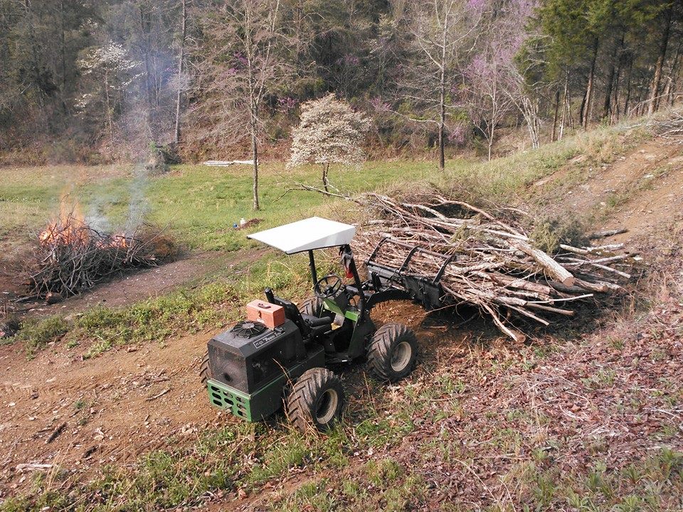

Here is the electric one I made when I had my PT-180. I still have the parts sitting in my shed. I've been thinking about using them on my 1425 hooking it all back up.
It was a little slow as it was a screw type but not as bad as you might think.. It worked great picking up just about anything.. I know you hydraulic guys don't think much of an electric actuator grapple.. But it proved it's self to me and was very handy around the house. It had quite a bit of jaw pressure plenty to pick up large rocks tree stumps as you see in the pictures.
It was asked previously if It needed the hydraulic's on the bucket to clamp down on a heavy object. The answer is no it had enough power to do it all on it's own.
http://www.tractorbynet.com/forums/...rs-home-made-attachments-improvements-17.html
If you look back a few pages it shows how I put it together.
