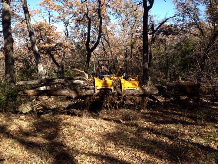

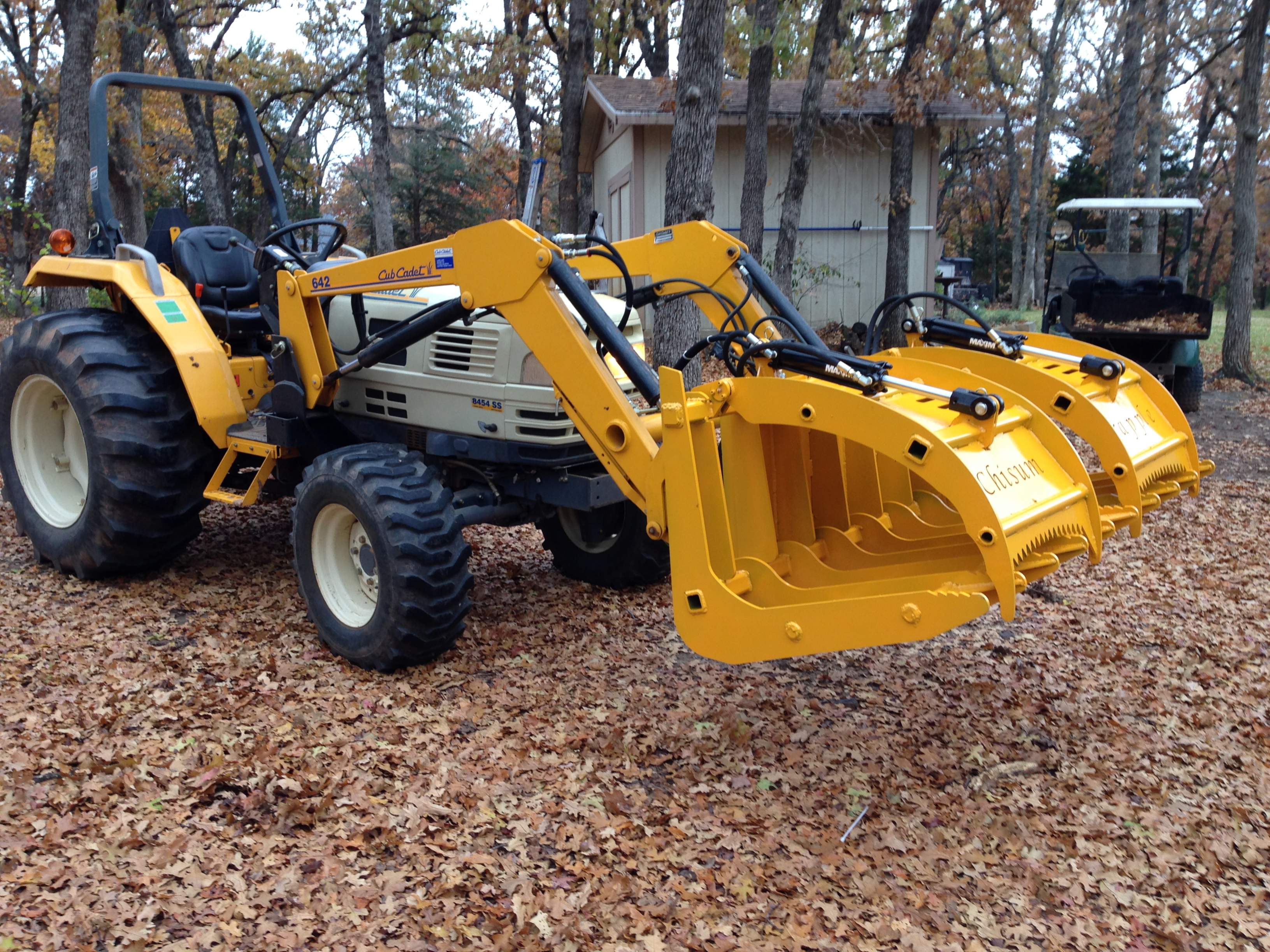

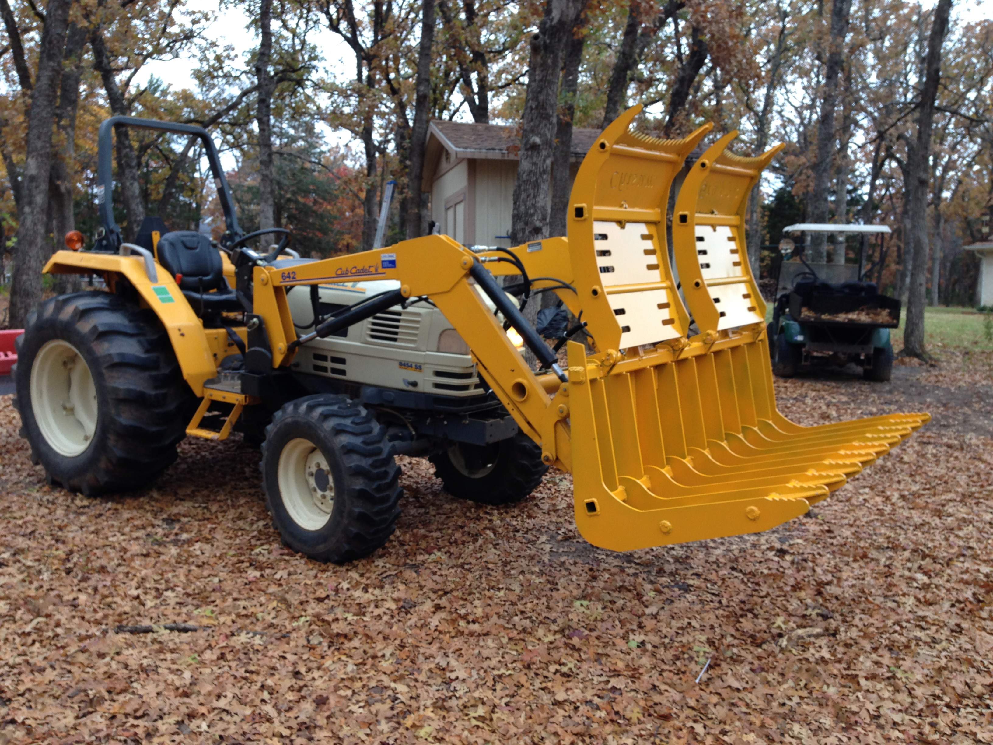

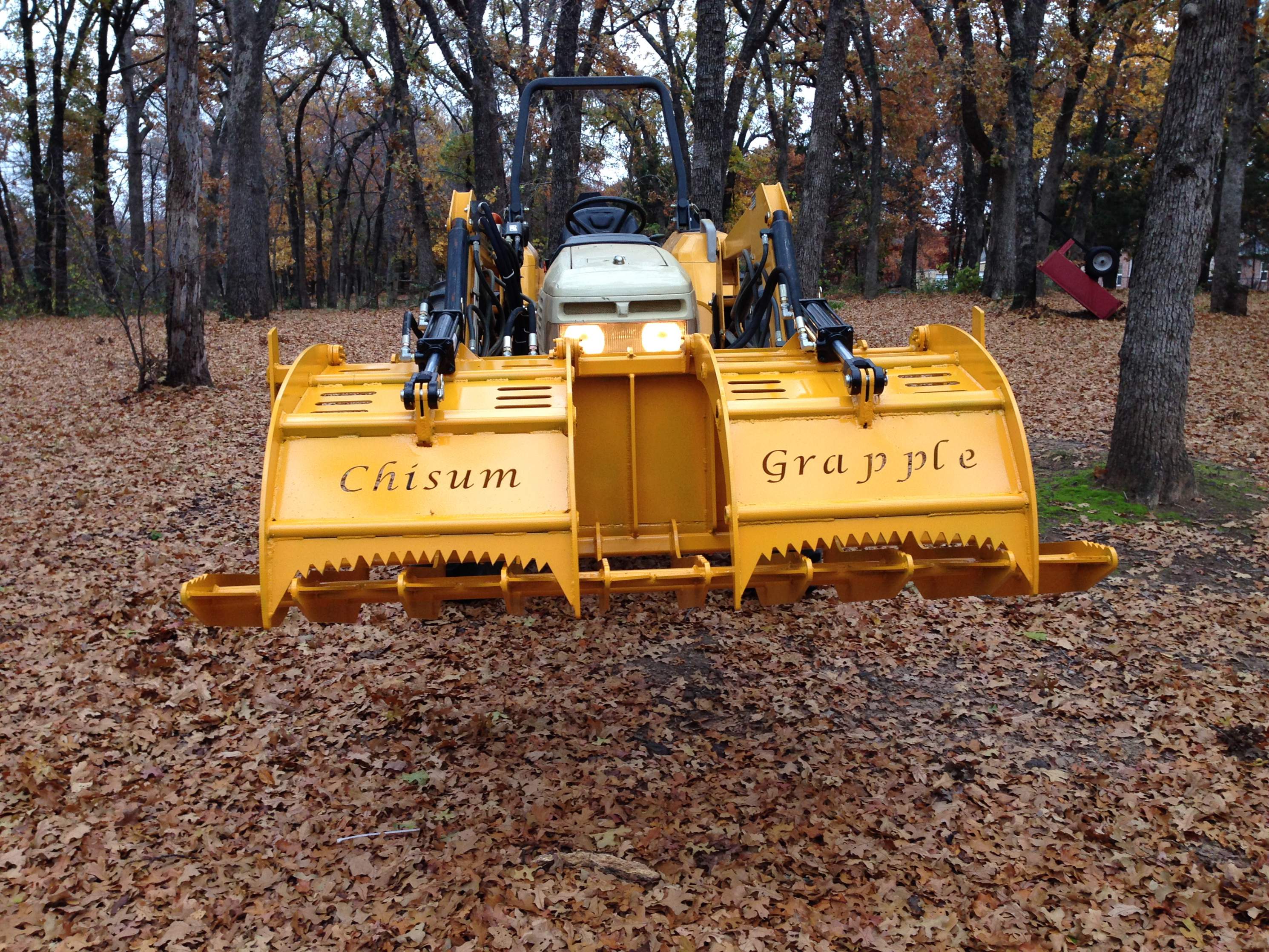

IMG_1438.jpgBuilt this Grapple for my tractor. Can do so much more than ever imagined. What do you think? IMG_1439.jpgIMG_1441.jpgGrapple working2.jpg

Very nice work. Why is there two separate cylinders/sections? I don't know anything about this type of grapple.
thanks,
dave
   / Grapple #7
thanks,
dave
On the larger grapples, it is advantageous to have 2 lids to better pickup loads that are bigger on one end than the other. Think of perhaps a tree stump, one lid can close on the larger end, and the other on the smaller end. Or perhaps a rock that is unbalanced.
James K0UA
   / Grapple
Thanks! With it being 72" long it's Able to clamp on loads across the grapple. Both work on the same valve but once one hits whatever material your carrying then the other will continue on until it hits and pressure is applied to both equally giving it more Stability.

If a person is gonna take the time to build a Grapple, you definitely want to build with two "jaws". As James said, it increases productivity dramatically. Even with Brush, it will pick up a bigger load. And most importantly, it will not drop brush all the way to the pile.
I've built a LOT of attachments and add-ons. None have a payback like a Grapple.

Very nice! Did you get the writing/cutting done or did you do it yourself?
Thanks, I have a Water Jet Machine. Makes things considerably easier on projects like this.

Nice looks like a ea wicked root grapple how much money and time do you have invested in it? Thinking of building one for my skid steer!

Right at $1000.00 in materials. Metal, Hydraulics, hoses, fittings etc. Guessing around 30 hrs, does not include any design time. Nothing my tractor can do to tear it up. I Tried!! Its by far the best attachment Ive got. Thanks!
