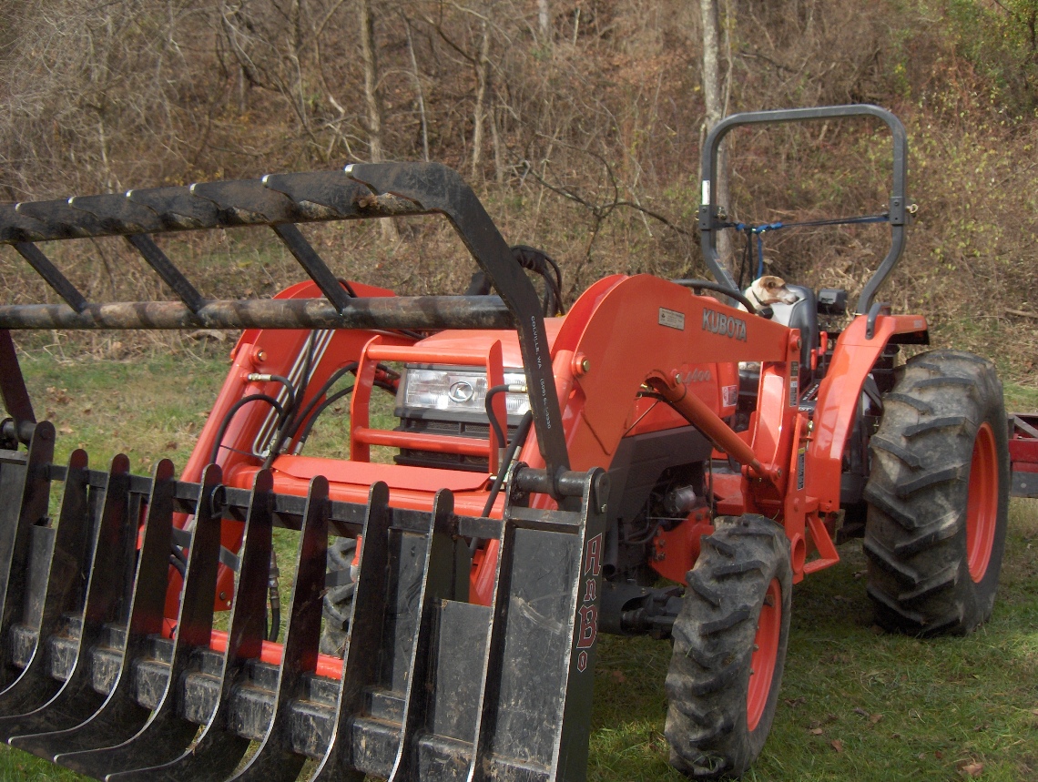

I got the same Markham grapple rake last spring, except I had them put half-inch side tines on it. The shipping sticker came off mine OK, but it took the paint with it!
Initially, I had some trouble with hooking the hydraulic lines, but I've done pretty well recently by hooking the QA up, raising the rake, shutting down the engine, then releasing it back to the ground (moving all the control levers to relieve the pressure). When taking it off, I also lower the rake and grapple the last little way after shutting off the engine.
I really like the skid steer (flat face) type couplers. It is also great to be able to connect the male and female couplers together when the grapple isn't mounted on the FEL, to keep dirt away from them...plus, they always get hooked up the same way each time.

Oh, also, while these are really tough, they aren't totally indestructible: I somehow managed to slightly bend the grapple. I noticed last time I used it that it was noticeably twisted...the cross-bar isn't parallel to the top of the rake anymore. It doesn't affect performance; for me, it is more like a picture hanging crooked!

I have considered putting a few gussets in the corners of my grapple "teeth" to overcome any bending. There is lots of potential for stress on those tines if your put a side load on them......Or get going a little fast and hit a rock or stump, etc. A few gussets in the right place may sure help. Those tines get out there pretty far.....

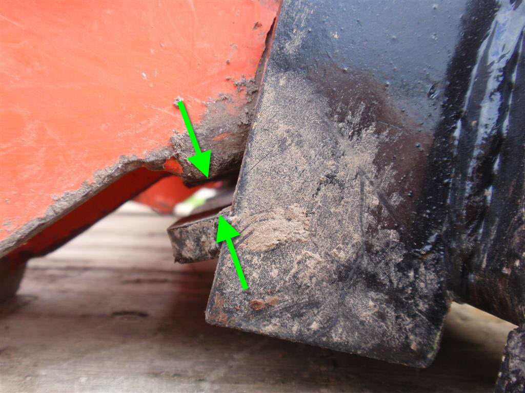

I called them and they are going to send out a couple different thickness of lower latch plates to tack on top of the existing ones and see what fits. The gap in the photo is 5/16" which they said should typically be no more than 1/16-1/8". So I get to try out my amateur welding skills. Yippee:( It's a solution that will at least keep me going, but only after the parts get here and I can get that figured out.
For now, I'm going to wedge some plywood in there and wire it in place to take up the gap. That should hopefully hold me for the weekend. Not optimal, but it keeps me moving.

Updates:
The hydraulic connections are still giving me issues. What I have found works is to activate the valve via joystick, while there is pressure on the fitting. Basically I get the fitting started, put a bar clamp on it to apply some pressure, then go trip the joystick and switch and it goes together easy. If I had a second person handy, I might not need the clamp. It appears to not be bleeding off enough pressure to easily connect unless it is under pressure of the fitting for some reason.
The QA is till popping off a lot. They are sending parts to fix, but I have to use it while I have the opportunity. Not pleased that it is doing it, or that I have to fix it myself on something bought new.

Mine had slop in the tolerance on the quick attach too and came loose on one side twice. I welded a simple straight bar on it so the QA pin hit it first, it tighten it right up....problem solved.

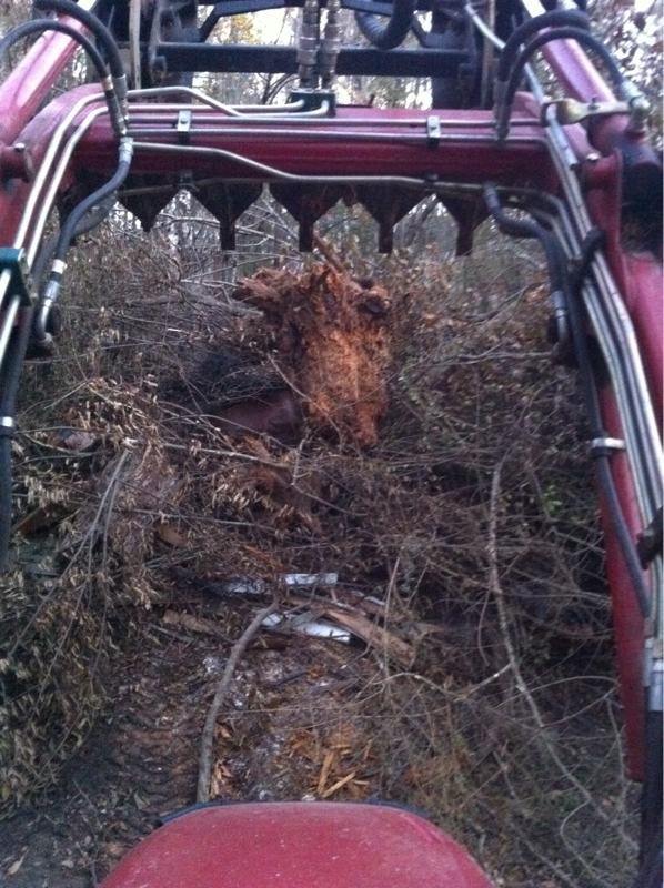

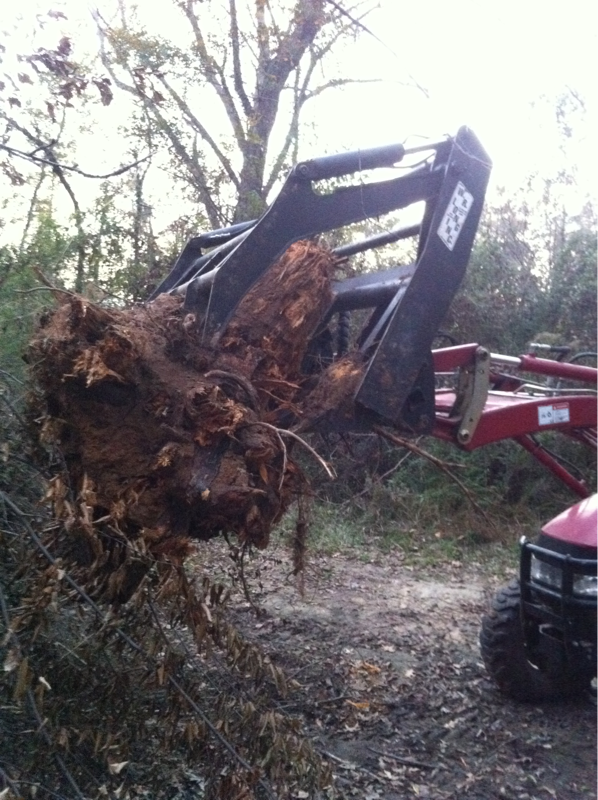

It's not quite that heavy. Actually 567 pounds (WR Long RBG 60) But certainly much heavier than a set of simple forks so cannot lift quite as much. Don't really notice the difference that much though. Here's some pics from a big pine stump we wrestled out yesterday. I apologize for not having the ropes up (Large tree limbs too low back there). Rear tires are filled and usually have 500 pound boxblade on for ballest

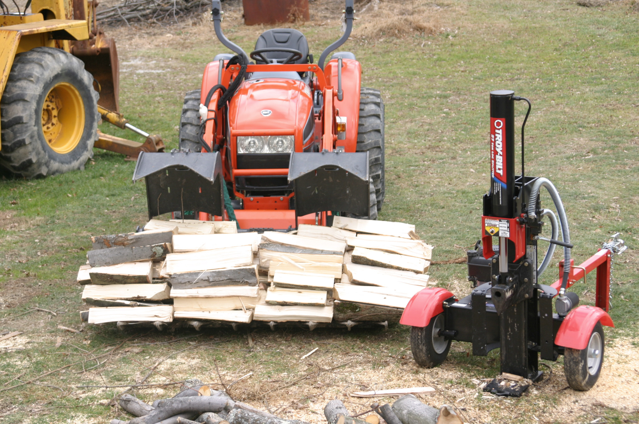

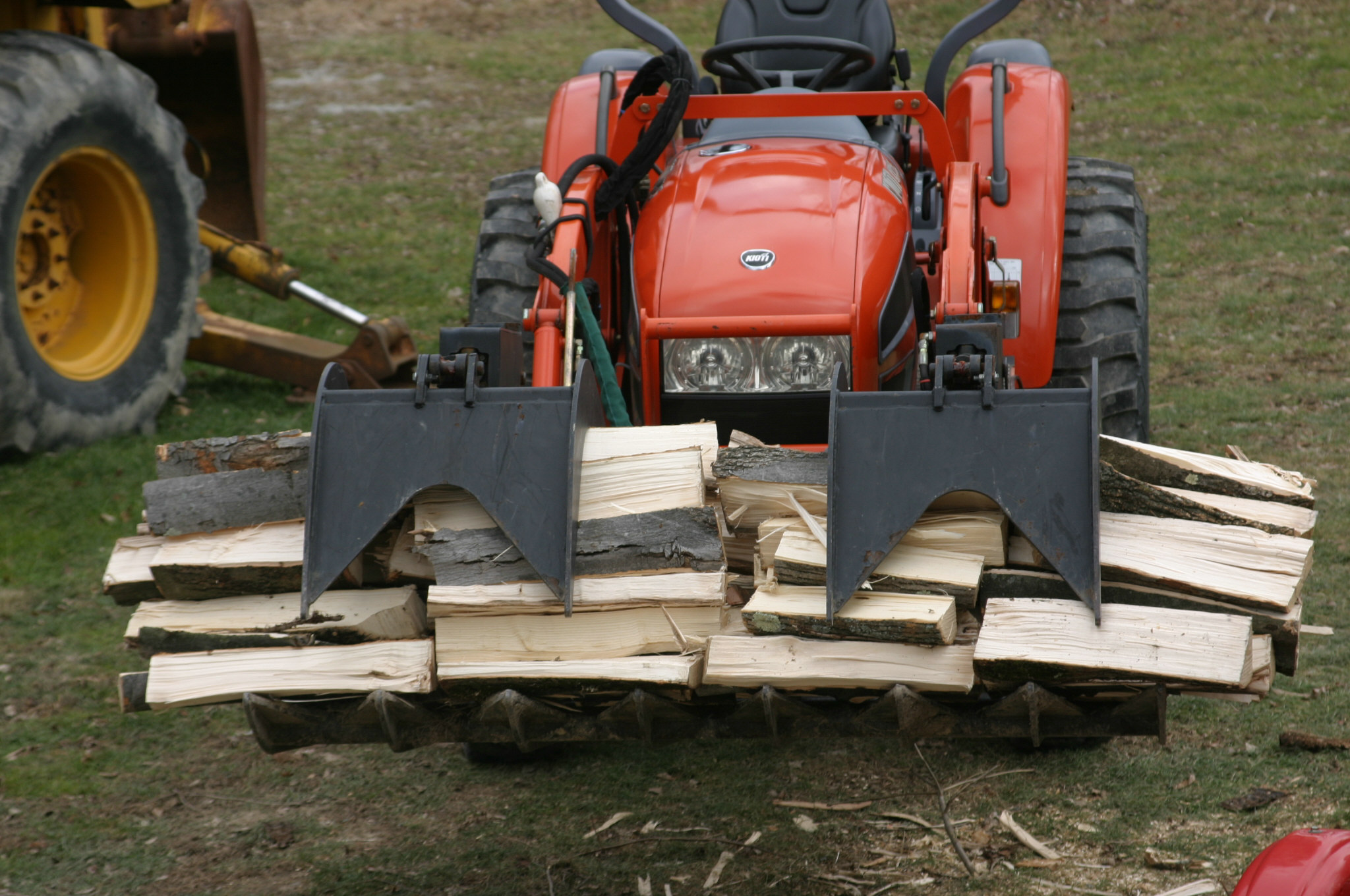

This is how I carry firewood. Maybe half a cord or so at a time. But, I'm sure I could pack more in if I only had a wider grapple.:laughing:
