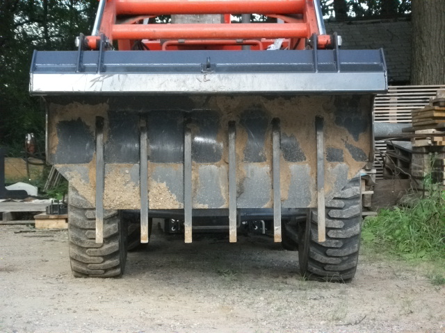

60" Bucket with 66" front track

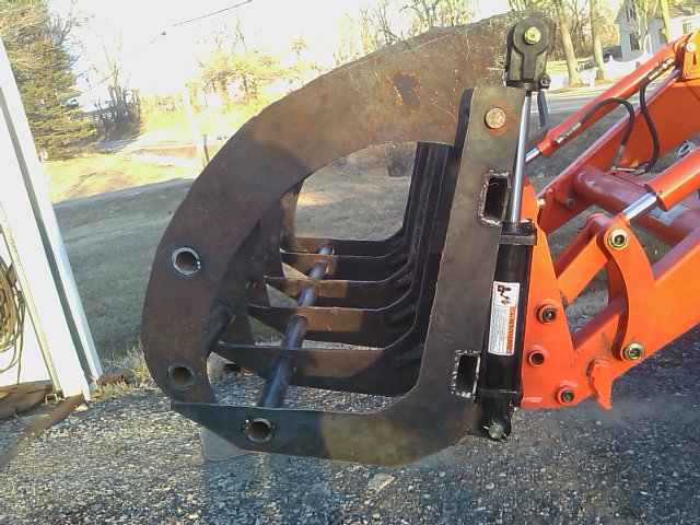

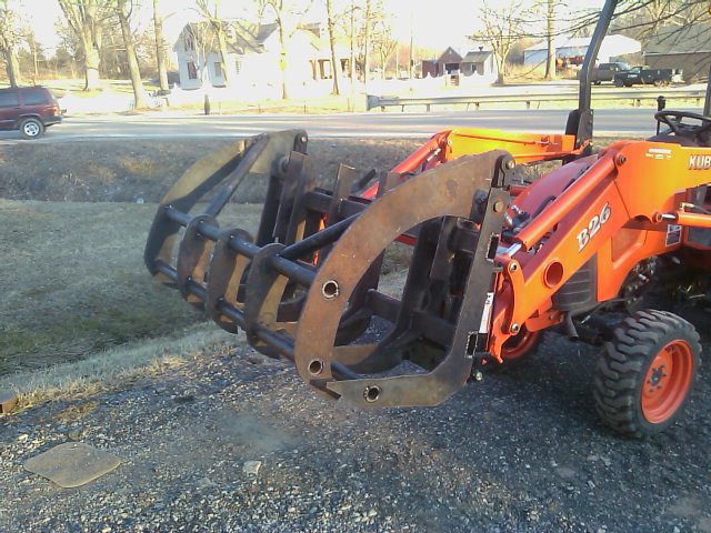

I made mine 54" so the cylinders would fit and be coverd? Its on a b26 kubota and have loaded/moved over 30 acres of small trees with it and would not want anything other than a grapple on my bigger tractor next time.

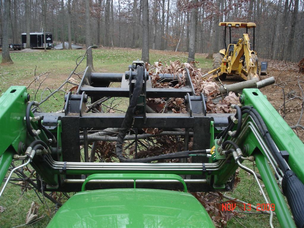

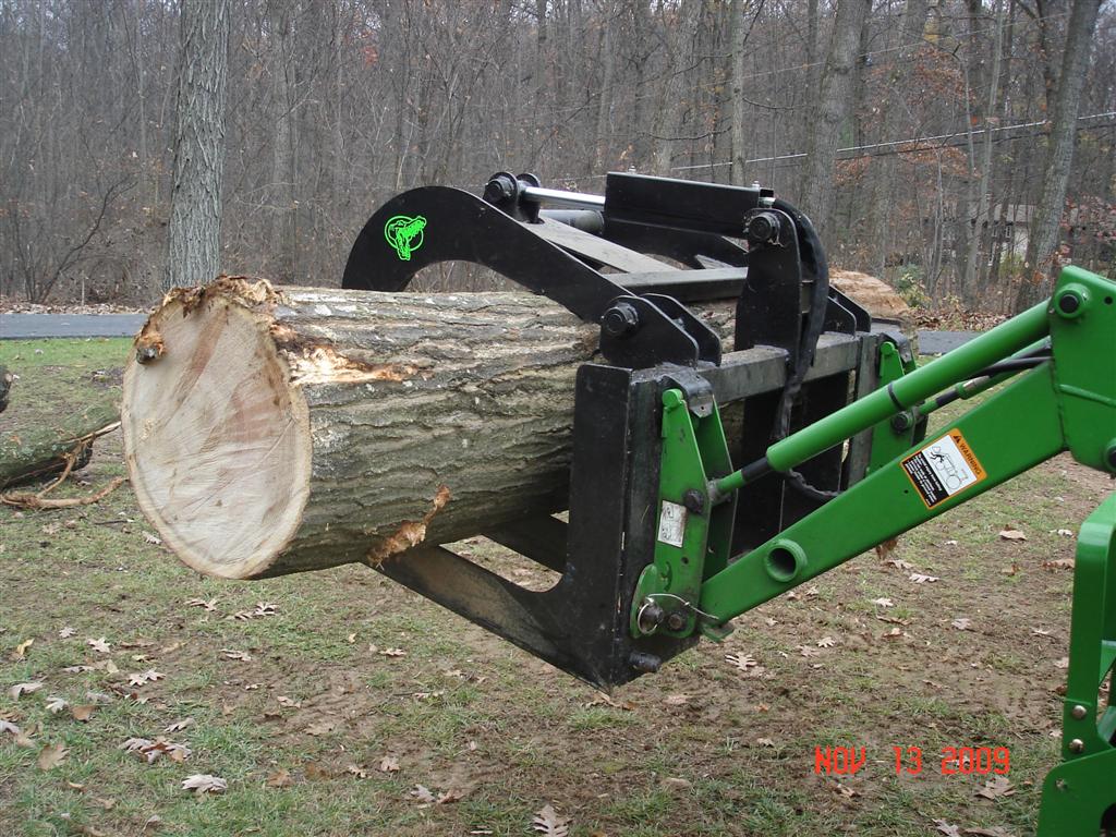

Some pictures of mine in action:

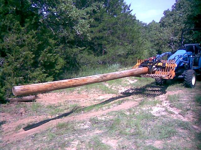

My grapple is mounted on a 5' wide rock bucket instead of a root rake. It's really nothing more than a thumb for holding odd materials inside the bucket. Here are a couple of pictures of the grapple in use. In the case of the pole, it was too wide to carry cross-wise through the trees, so I grabbed the end of it and clamped down, making my tractor look like it was an olympic pole vaulter. In the second photo, I'm gathering big rocks to use in landscaping. Just having a tiny thumb type grapple worked great.
