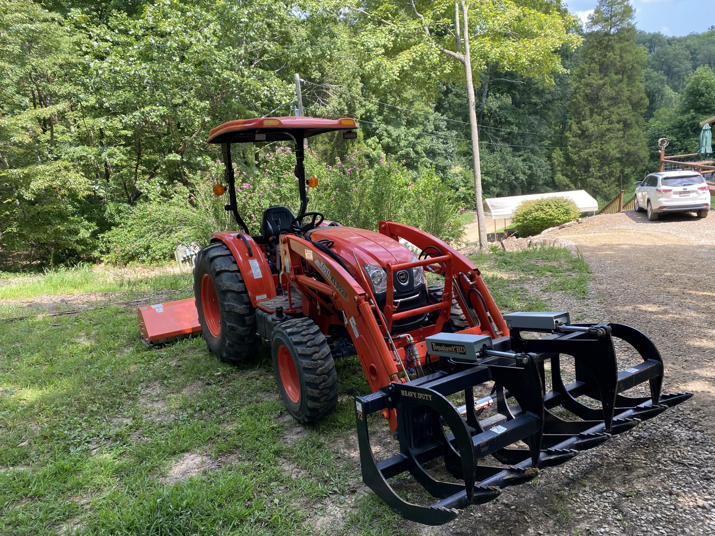

Thinking that the EA wicked grapple is 55" and smokeydogs response I went on line and ordered the Homestead Implements 55" grapple. I was worried about the price increasing as other things have so I went ahead with the order. Now the wait.........
Nothing beats that first smile when you grapple your first load!
There are several options now for bolt on grill guards reinforcements. Some shown on OTT from custom fabricators. DIY or take your guard to a weld shop. I’ve done simple,
To heavy duty.
You have time while you wait for the grapple to get this done. Be careful propping or removing your FEL while working on your grill. You have the 3rd function figured out? Many happy returns.

Not at all! I have a BX25D. Last summer I installed a 3rd function kit and put an Add a Grapple on the stock bucket. I have for a long time had a Piranha toothbar on the bucket. I am constantly delighted at how much more I can accomplish with this combination. I work in the woods a lot, and move a lot of logs, limbs, and brush. Here in western Washington, it's a perpetual fight to keep the property from returning to jungle, and the combination of grapple lid and bucket turns out to be ideal for picking up and moving mixed loads of soil, brush, leaves, and half-rotten logs. It even helps tear out and move stumps, once the backhoe has done the heavy digging and prying.
I'm not sure what ultrarunner means by "max utilization". Everything the BX does has to be proportional to its size and power. Naturally, the grapple is also sized for the BX.

Smokeydog, nice guards........ I plan on taking the existing grill guard to a local metal fabrication shop for them to modify. As far as the 3rd function valve, last Sunday I purchased the valve kit from Rural King specifically made for my tractor by TYM which produces the RK brand. The kit comes complete with all fittings, new joystick, hydraulic hoses and steel lines all made to length for my loaded. Did get notification this morning that the expected ship date is 1/24/2022. They said that the upcoming holidays added about a week to the date. Only been one day and already getting excited.........

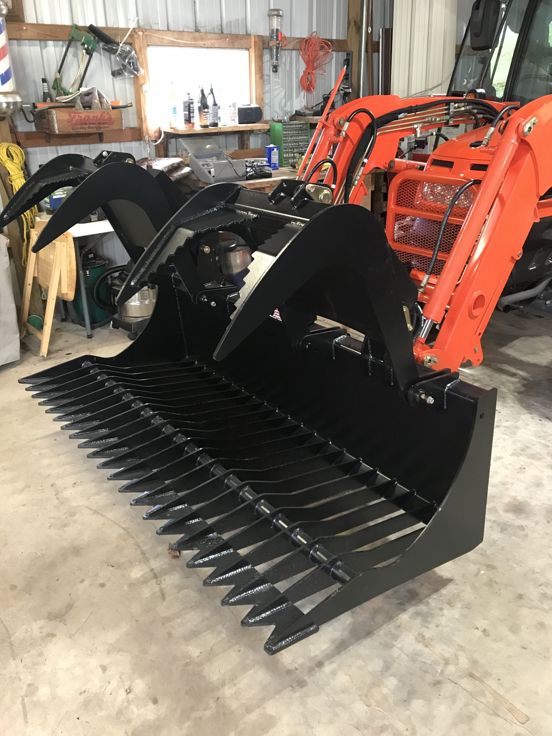

It is time to show the Monster Grapple in this grapple time thread.
The opening is 51 inches:
It weighs a little over 1100 pounds:
Picking up small cedar trees, adding to the one in the grapple:
Ungrappled onto the brush pile :) :

Great pics, that looks like one stout piece of equipment.

This particular grapple setup weighs only about 130 pounds. So yes, of course, that is subtracted from the lifting capacity of the loader; but the tradeoff seems worthwhile to me. It is so helpful to be able to grab stuff, either to rip it out, or just to move it.
