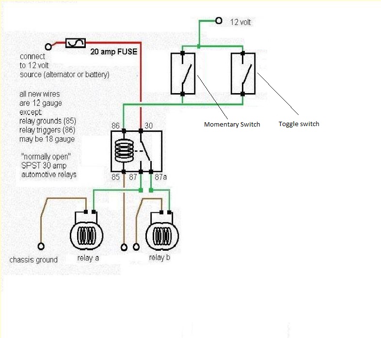

Jul 20, 2014 / Grapple Switch #22 D DonT-B7500 Bronze Member Joined Sep 3, 2007 Messages 67 Location Finleyville Pa Tractor Kubota B-7500 Here is the schematic if any body is interested
Jul 20, 2014 / Grapple Switch #23 R rswyan Super Star Member Joined May 12, 2004 Messages 13,478 Location Northeast Ohio Tractor Kubota B2910, Cub Cadet Pro Z 154S, Simplicity 18 CFC, Cub Cadet 782 DonT-B7500 said: Here is the schematic if any body is interested View attachment 383371 Click to expand... Thanks - appreciated !
