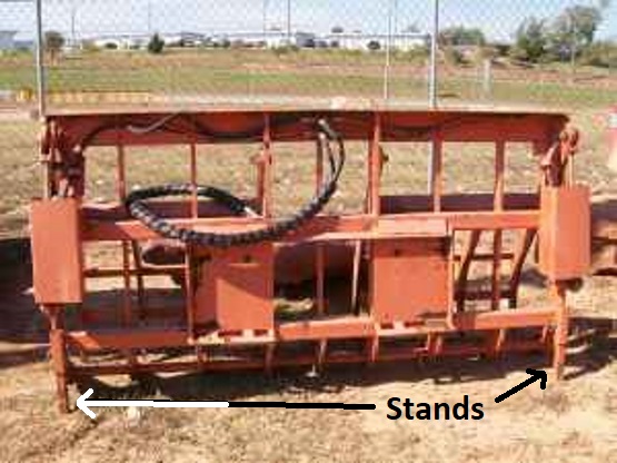

This is what was on my first grapple, removable stands:
