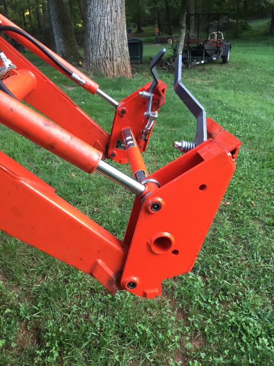

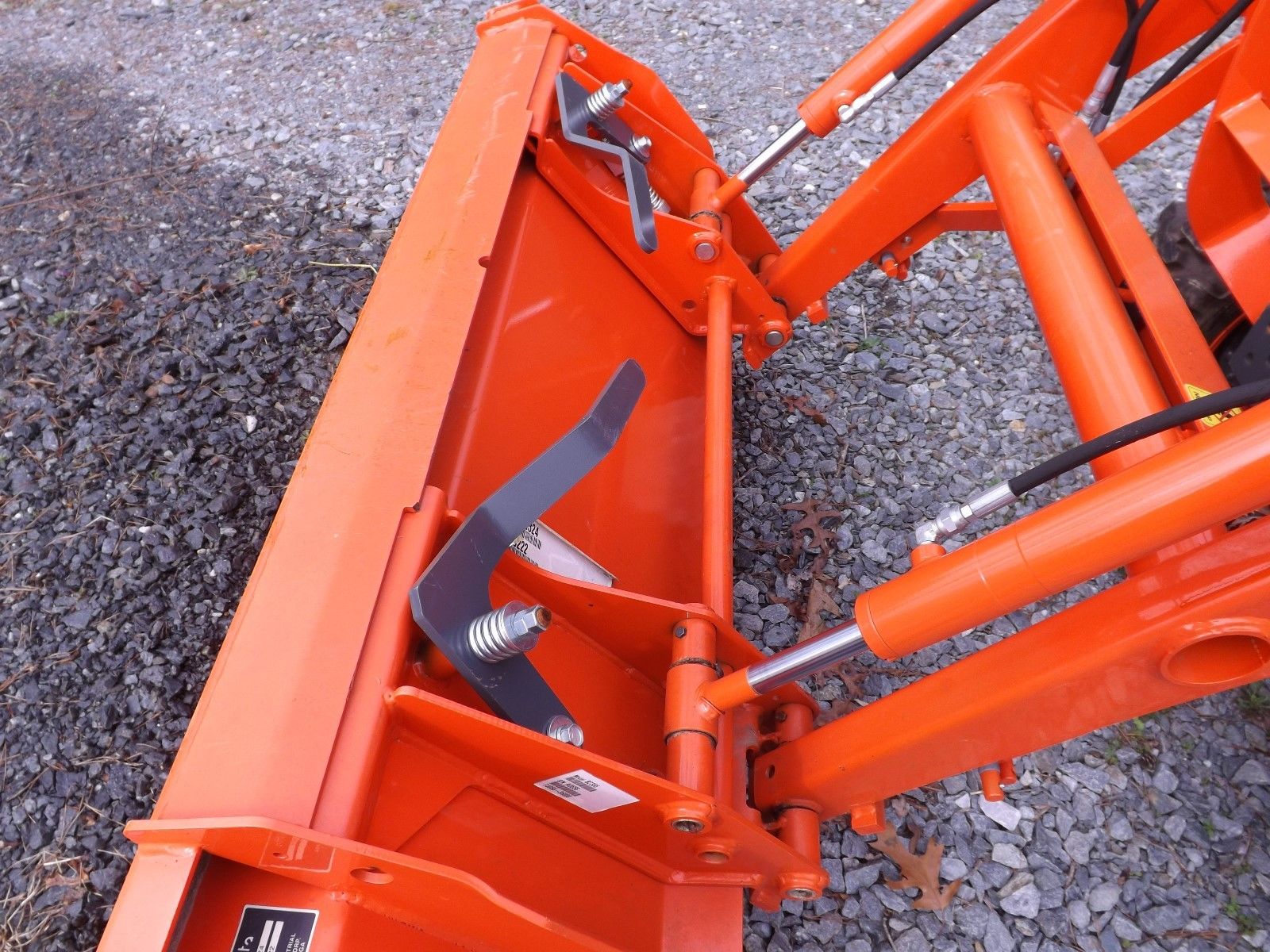

/ Grapple recommendations #4
This one is good for my needs - the grapples are 5/8" thick, so don't need webs blocking the view. Hydraulics are enclosed, very well-protected. For general use the flat-bottomed bucket is good. For stump clearing, a rake style bucket may be preferred.
It's very handy, made quick work of cleaning up a huge pine we took down. Put the logs on a trailer and moved the brush to a burn pile, disappearing the whole thing in a couple hours.:thumbsup:

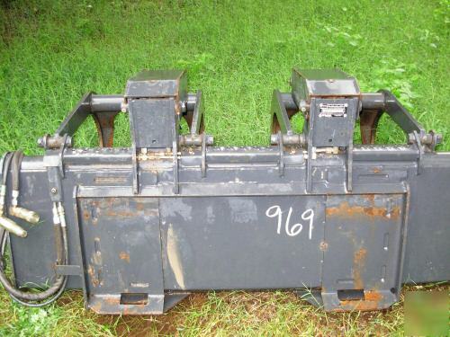

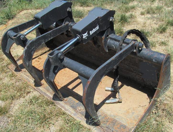

So an attachment for a skid steer will fit on my L4600? That's the part I'm confused about. Are all these attachments standard like a 3 point hitch is the same across all brands except for class?
/ Grapple recommendations #6
SSQA(skid steer quick attach) is a universal fit but some SSQA tools "may" be too heavy for some tractors and tractors for the most part will not have "hydraulic flow to run implements designed for a SS".
That being said it's a great set-up for a compact tractor.I have my bucket(with thumb) and snow-plow set up with SSQA.
/ Grapple recommendations #7
As birdman mentioned - Pay close attention to weight and flow. Brush and small branches are light compared to the solid wood they came from.
One of the areas that EA excels at is making tough grapples fairly light weight. Also customer support.
