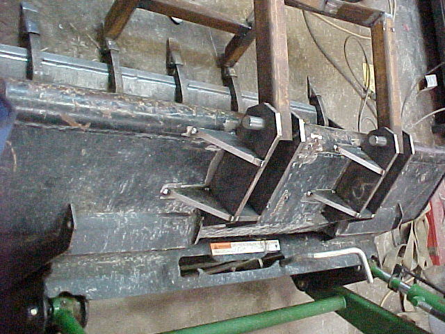

I started bulding a grapple for my loader bucket. I have things tacked together and tryed to figure out where and how to put a cylinder on it. After too much thought, I do not have enogh room for a cylinder with out getting in the way. My bucket is QT skid steer type. Since I use it agast houses and buildings alot I really can't have any thing over hang the top of the bucket. I think I will srcap this one and build a bucket /grapple combo like some others have done. I have a lot of brahes and rocks to clean up, so this type would be better for the uses I have in store for it.
Pics of the mistake.

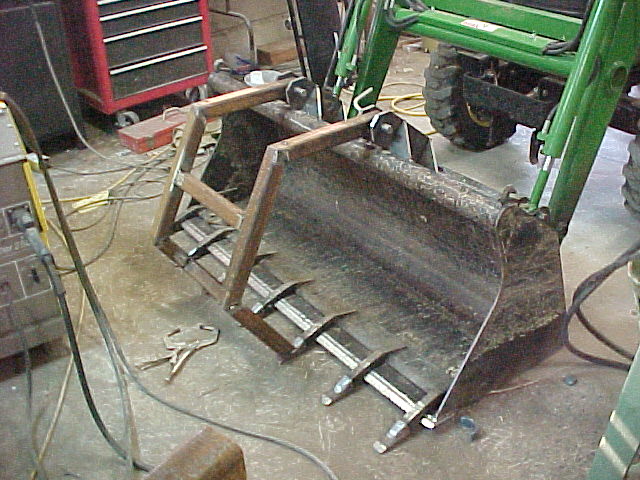

pic 2

Would it be better to use 1" cold rolled square for the bottom teeth or use 3/8" plate on edge. This way I can put cylinders on the out side of the loader frame so I can unhook it easy.
What about tine spaceing? 6" too close?
Thanks for any comments.

I think your grapple could be saved I see alot of room for a center mounted hydrauild cylinder you might have to use and arc on the mount to get it up over your quick tach on the back of the bucket or you could even go with a trunion mounted cylinder.
/ Grapple project #7
Can you hang a cylinder on the rear of the bucket? Maybe weld a bar just forward of the hinge pins and run some tube back for the piston. Weld a clevis on the bottom of the bucket.I guess if you HAD to scrap it....paint it purdy and give the wife a nice firewood rack.My wife has a 300lb toilet paper holder,200lb skillet rack and 3 ton rose trellis /forums/images/graemlins/laugh.gif /forums/images/graemlins/blush.gif
That one is possible but, The pin point would be taller that the bucket. So when the bucket in back drag in the side of a house the bracket would hit the house easy. I Have to keep the top of the bucket stock as possible.
I really hate to add any more weight to my HD bucket, it is heavy enough. That is why I am thinking about a diffrent type grapple.

it could be made lighter wieght and still have a lower profile Ill have to do some more lookng. I have to same problem on my older TLB but im overcoming it for now just if my fork hooks will work with it. You could make it all bolt onto your machines bucket so it wont be in the way all the time thats how I may do mine till I can build another bucket.

OK I re did it. I found a used 5' bob cat bucket with teeth that does have a even bow in it. $250 for the bucket, so the QT works on my GB loader. I cut all the tacks off the good bucket and went back to the welder.

I did save the grapple. I change some lenths because the bob cat bucket is alittle deeper, which is real nice.
