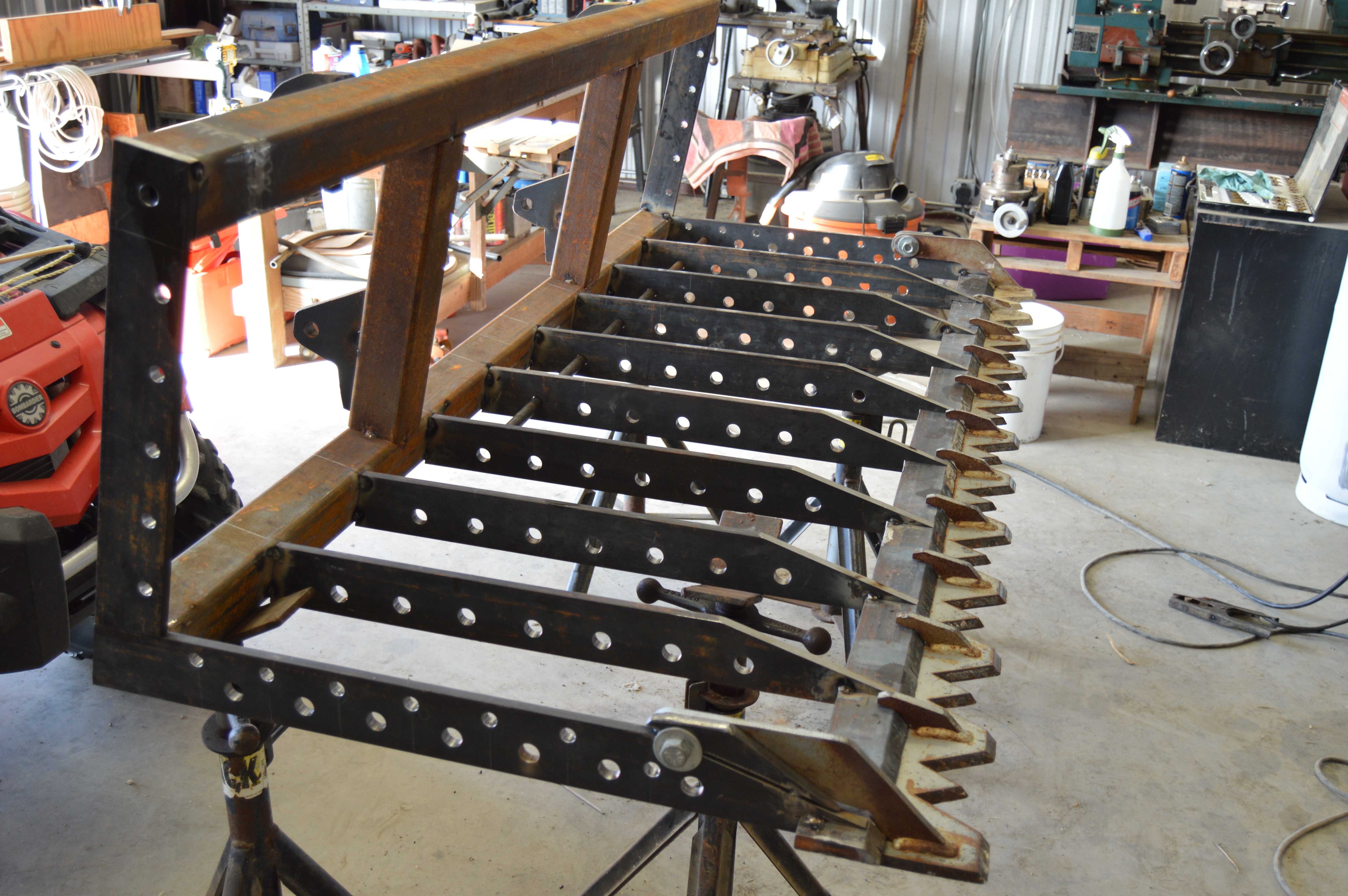

Has anyone built a brush grapple with the intention of fitting their Piranha tooth bar on it? Not the moveable jaw but the bottom. I'm going to try it. I have lots or briar and small brush to clear and I think it will work good. The Piranha bar works well for this with it on the bucket but without the grapple ability it just makes a mess. I don't think just adding a grapple to my bucket would help much as it's a full bucket and not the skid steer type of bucket. I don't think I need any kind of root rake or digging with this. The bar on the bucket as is takes down brush 1-1/2 diameter easily.
My tractor is a ZETOR 4321 59hp
I intend to build something similar to this but along the front of the bottom tines will be a plate that the Piranha bar mounts on.
I was just wondering if anyone had done something similar.
All comments positive or negative are welcome.

The MTL design is shaped similar to the Piranah. Just need to take a grinder or plasma cutter and sharpen the teeth.

Thank you. I had not seen that grapple. That is the design I had in mind. The one I am building will have a beveled plate on the front for the piranha to mount on.

That's really not the right type of grapple for brush. You need a clamshell type grapple for that. But, I understand trying to make what you have work. I use my landpride sgc 1072 effectively for brush, but it wouldn't move a bunch of firewood like your grapple could.

I have a Land Pride SGC1560 grapple on my Kubota M6040. I open the grapple, wide open, rotate the grapple down, use the top lid to grub out brush. Works just fine.

I decided to move forward with the project. I hope it will work as well as I think it will.

Any finished pictures? How does it work?
