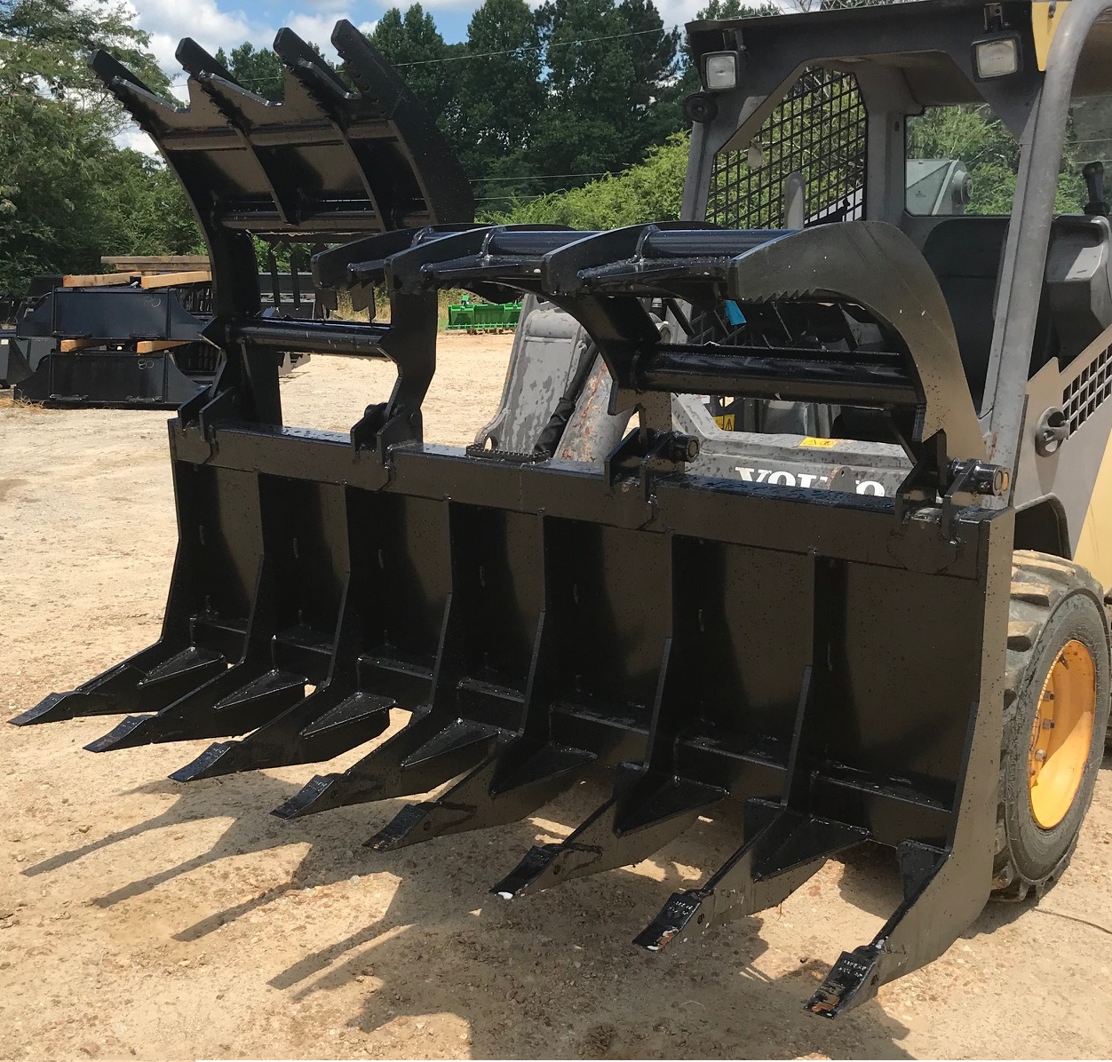

I have the same LP grapple as Oosik. Mine is a bit wider I believe, but they are essentially the same. Very well built (for skid steers) and take a beating. Most times my biggest fear is snapping the logs in 1/2. I agree get a heavier grapple. I would look for around 800+ lbs.
Dual lids? I would not make a recommendation for this without explaining the reasons. Dual lids are great if you are grabbing uneven loads (say a tree with thicker butt end). The claws will close at different widths, but keep the log level in the grapple. A balanced load is very important when you have things sticking out both sides :).
I dont like the dual lids, because I can easily compensate for it by grabbing in the right place. Also you cant use these for back dragging, which is a great benefit to the claw style Oosik and I have.
That said, you have to decide what works for you. One thing is for sure, we all love our grapples!

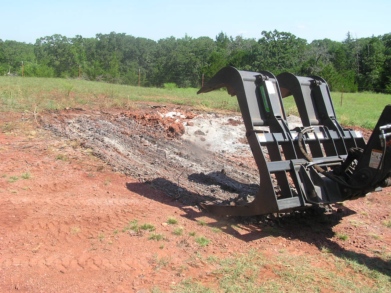

I use the L bottom in float mode and reverse for leveling:

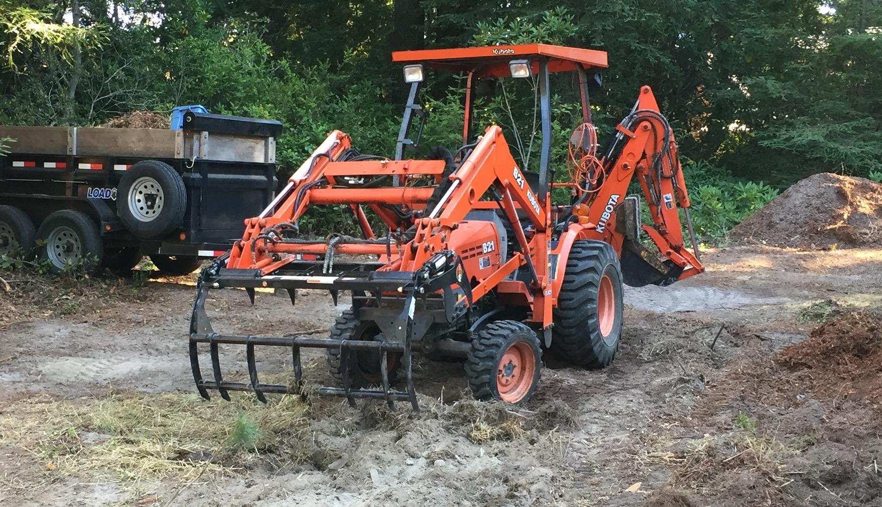

I like what stomper wrote. You need to figure out the function that is most important to you and choose the tool accordingly. In my case grubbing out surface roots and backdragging were most important, along with ease of moving around in bushes and trees. I don't need to move big logs or big anything for that matter. So I got a small land pride clamshell. Perfect for my uses. For some types of loads it does tend to drop stuff out, but with practice you can compensate somewhat.

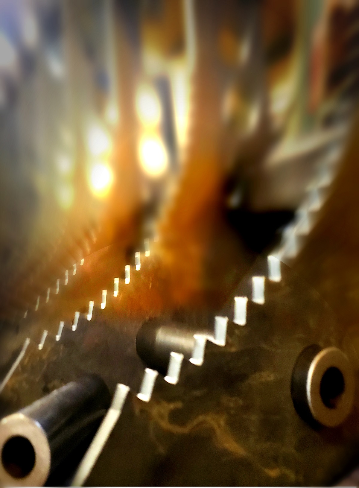

Our latest Wicked 66 root rake grapple is a breakthrough in the utility grapple segment. This highly functional work of art features serrated AR450 steel tines and thick walled DOM tubing, which is not found on any other grapple out there.
It weighs under 700 pounds to maximize the intended tractor's agility and lift capacity. We recommend it for Utility Tractors up to around 100 hp and we tested it on our M6-141 Kubota to ensure it's ready for our customers.
I'll share a few pics of this awesome grapple and will be glad to assist any of you guys!
