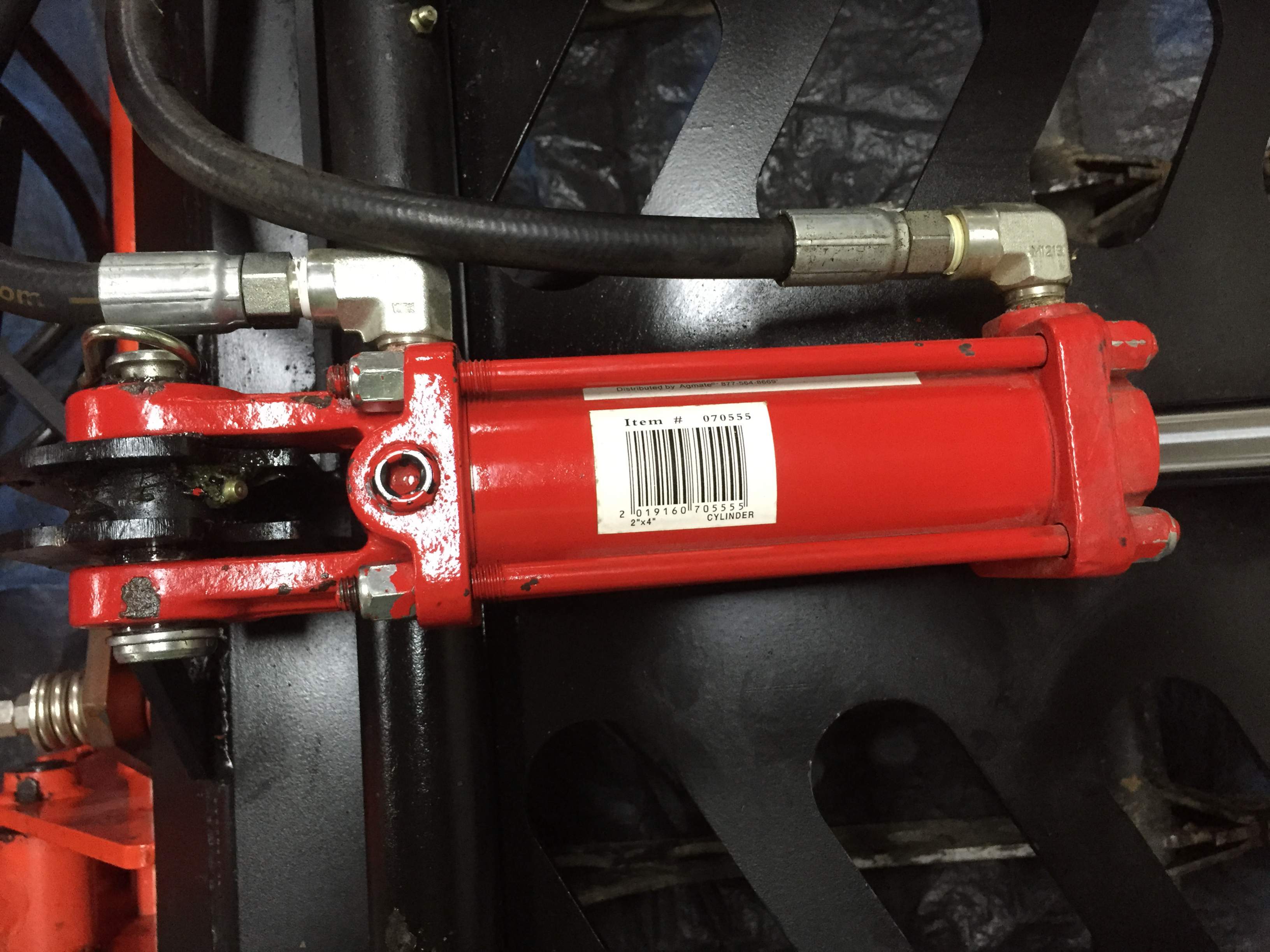

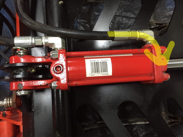

Ok, if you pressurize the rod side of the cylinder, like to open the grapple (see edited pic) and fluid comes out of the plug on the base end, then the piston seals are bypassing as I surmised in my first reply to you.
/ Grapple "jaws" won't close #22
Not necessarily , the cylinder is going to have fluid in the bore on the side of the plug , so if rod starts to move to the open or retracted position it's going to push oil out.

Technically true, but if it continues to flow out...

OK, I see your point on that. If you continued to push fluid to the rod side an fluid continued to gush out of the cap side plug the seal leakage would be likely.
/ Grapple "jaws" won't close #27
James, in reading the first post of this thread (and post #20)-that is what I assumed was happening, and I was just trying to get clarification from the OP on how the test was performed. Everyone else focused in on the valve being the culprit, but I didn't read the first post that way.

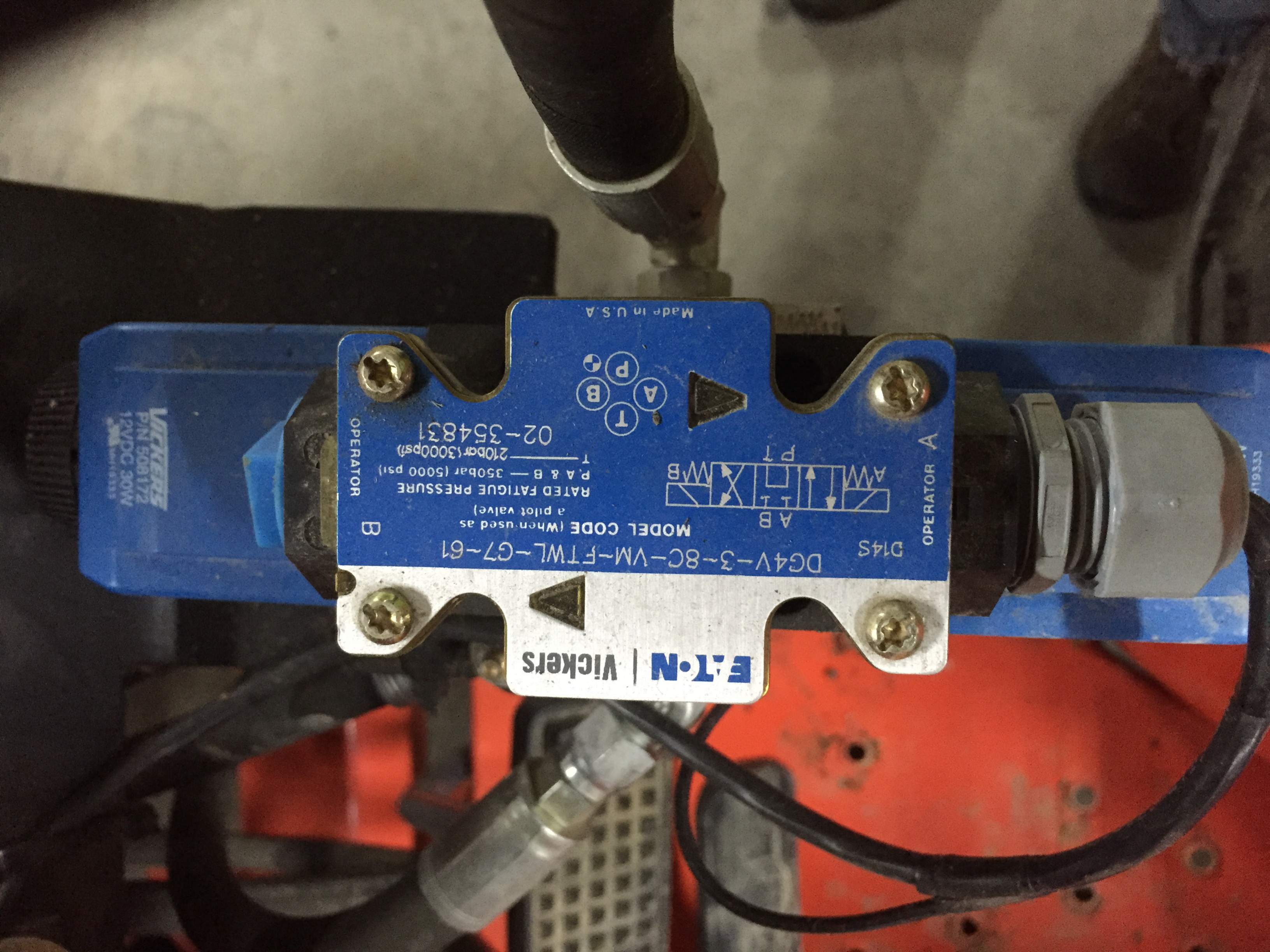

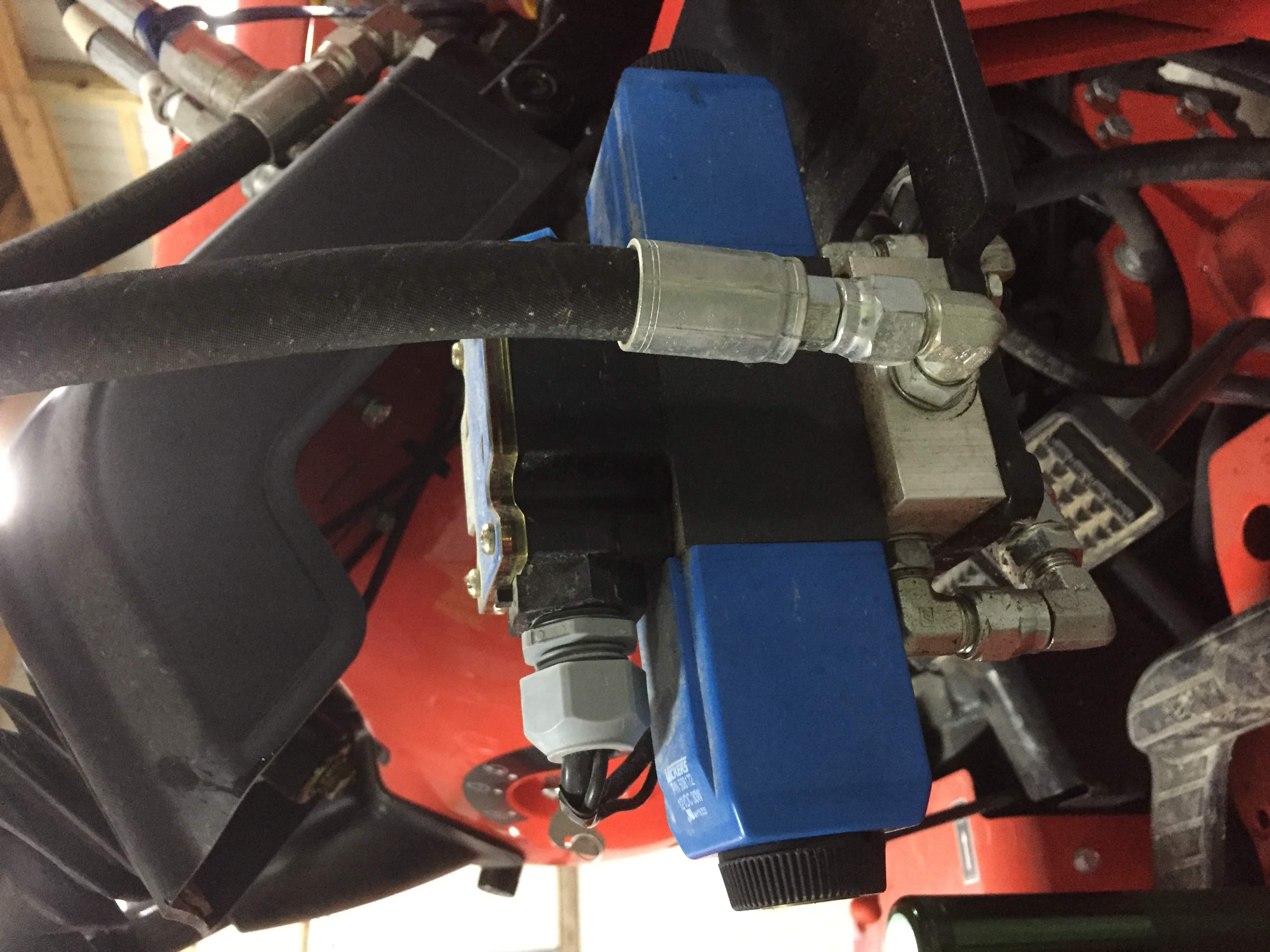

I don't know if I made any progress today or not ...... I took the solenoid apart - just like the video Eric posted (thanks, Eric, it was very helpful) showed, cleaned it, blew it out with compressed air, put it back together and it doesn't work any worse than it did before I took it apart! :) It doesn't work any better, either.
I video'd it half-assed working - it opens fine and, even though it closes, there is not enough force to pick up a limb or anything. I'm leaning toward it being a cylinder but then again WTH do I know .... :laughing:
/ Grapple "jaws" won't close #32

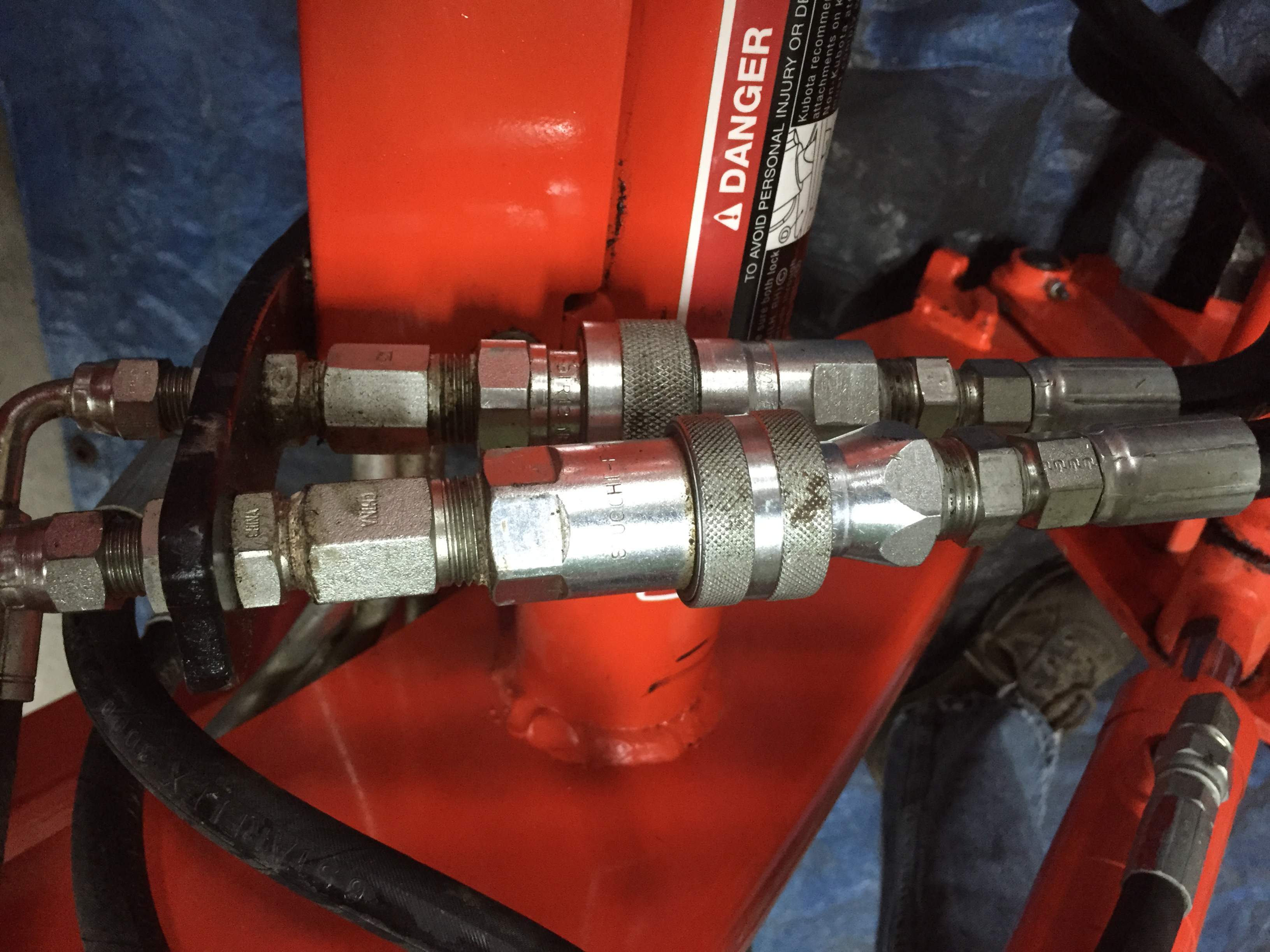

Wait: did you switch hydraulic couplers to see if the problem follows the coupler or the hydraulics around to the function it got hooked up to? By doing this step, we're attempting to find out if there is something in the line restricting the hydraulic flow.
Did you confirm by jamming open the quick disconnects at various places, that you have hydraulic fluid flow? Again we're trying to determine if you have hydraulic flow.
Did you switch the electrical connectors around at the solenoid? And then switch solenoid windings from side to side? This step we're using the none-good electrical stuff on the side with the problem to determine if the problem is electrical in nature.
All of these things are asked in order to slowly eliminate possibilities and zero in on the fault. If you did these things, report your findings.

I did some of what you mentioned. In the video you can see the T connectors where the hoses come from the 3rd function - I switched those 2 and when I pushed the button to open the jaws, they opened - which I thought was odd - but when I pushed the 'close' button the jaws stayed open. I had to unhook the hoses at the QD and manually relieve pressure in the hoses to get to close. When I switched the hoses back then it operated like it does in the video.
I did not switch any electrical connections.

I could see it being a cylinder if only one was acting funny, but it's very unlikely to have 2 bad cylinders.
Have you tried picking up anything with it? Just watching, the cycling appears normal at idle.

Eric.. how the heck do you "jam open" the quick disconnects?
/ Grapple "jaws" won't close #36
Ted explains how the lids work in this video just after the 17min mark.

I used a punch - but I could only do it one time and then the pressure was to high for me to push in the pin/ball. So, I'd shut it town, hit both buttons on the joystick, start it up, the try the other one. Both were getting enough pressure that I couldn't 'bleed' them twice without shutting down.
/ Grapple "jaws" won't close #39
Ok, we're just trying to help you troubleshoot.
The valve could possibly be plumbed incorrectly. Is your 3pt lift working as it should?
The grapple is opening and closing as it should in the video. We just need to figure out why it's not getting enough pressure from your valve.
